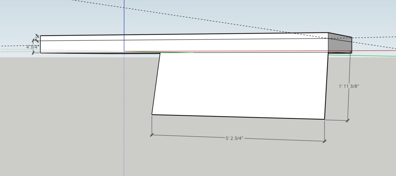

    Teaching myself SketchUp tonight...
    10 min in:

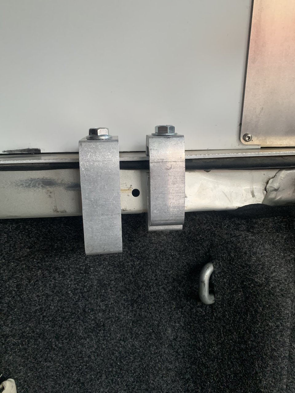

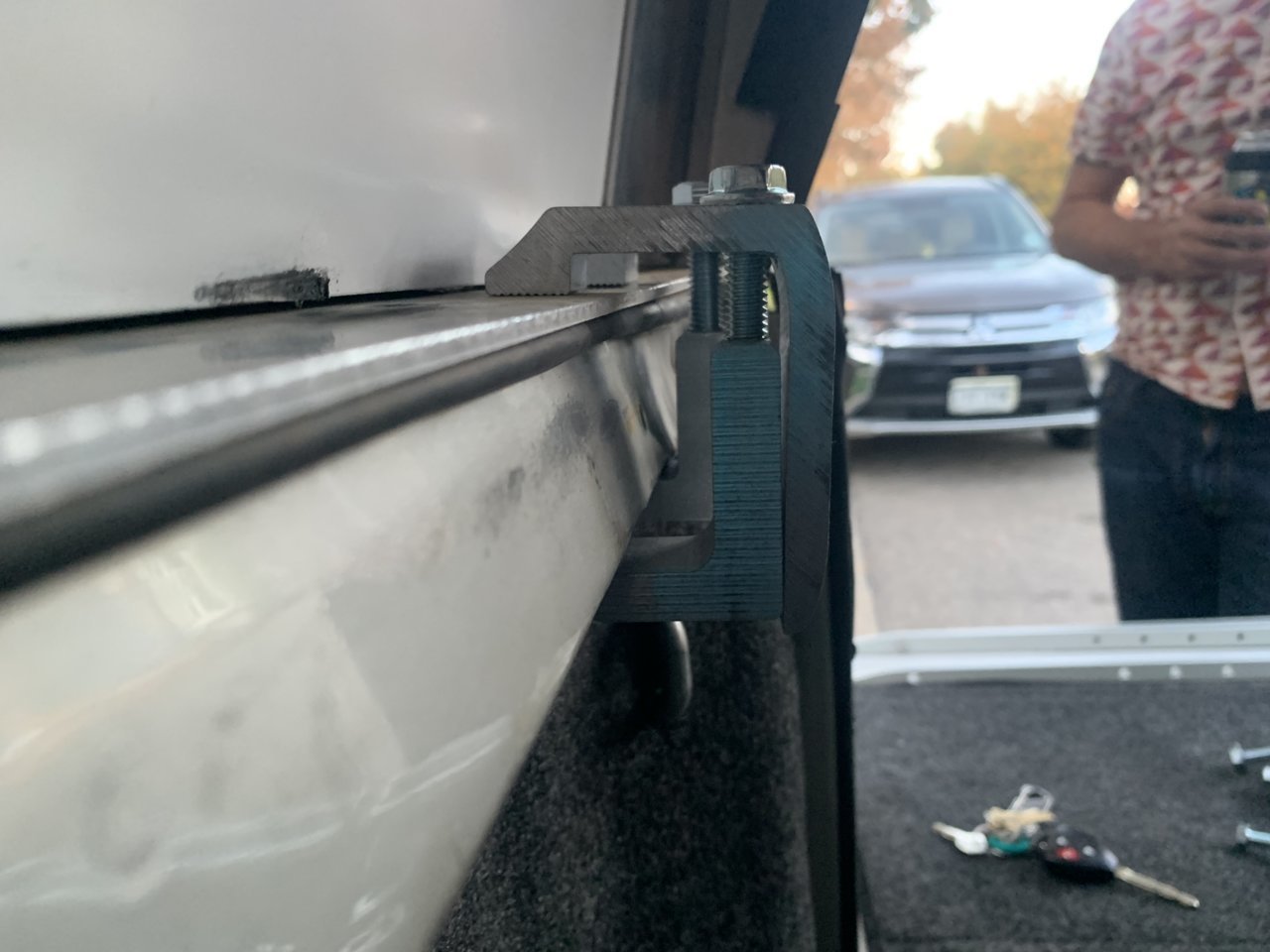

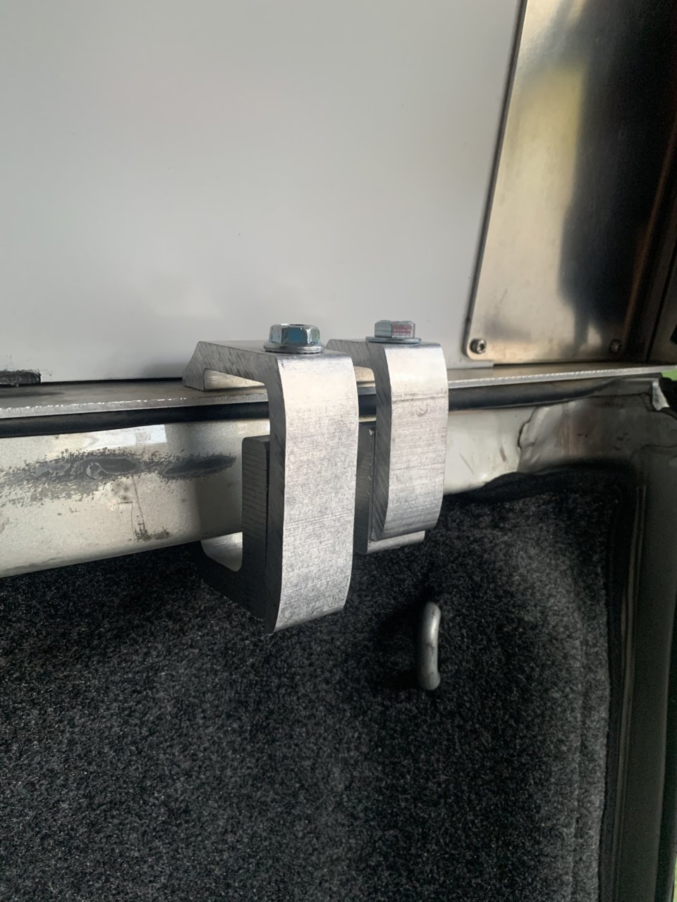

    BEST (1st) GEN CONTENT:
    On the 1st gens, the clamps stick out quite a bit. I wasn't excited about it, so I pored over the GCI website and ordered a set of G-30 clamps after triple checking the measurements.
    They arrived yesterday and annoyingly, the depth of the lower clamp is a few millimeters too shallow so it puts pressure on the vertical seam of the bed. Instead of hammering the bed to reduce the height slightly, I'm just going to clamp the lower section down in the drill press and take off a little material.

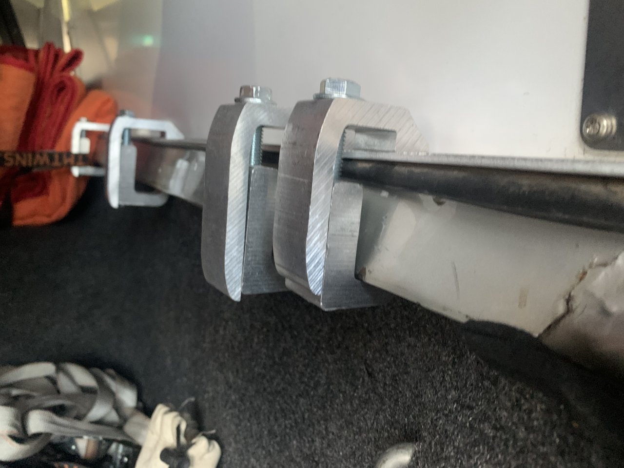

    Even though I can't have my Drifter until mid next year at least I can start getting toys for it.

    ^^^ Those clamps definitely look better!
