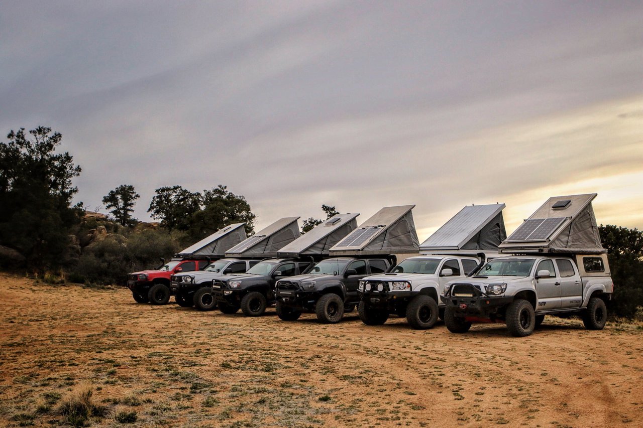

    In case you need reference :thumbsup:

    Heck yeah! I think it was @MTNHABITOVERLAND who suggested this tip so I excuse me if I misquote or screw up the process. I believe she said if you add Vaseline to the bed bolt heads, then place the platform cutout in, when you remove the platform you’ll have perfectly marked drill holes.

    Sexy lineup :thumbsup:
