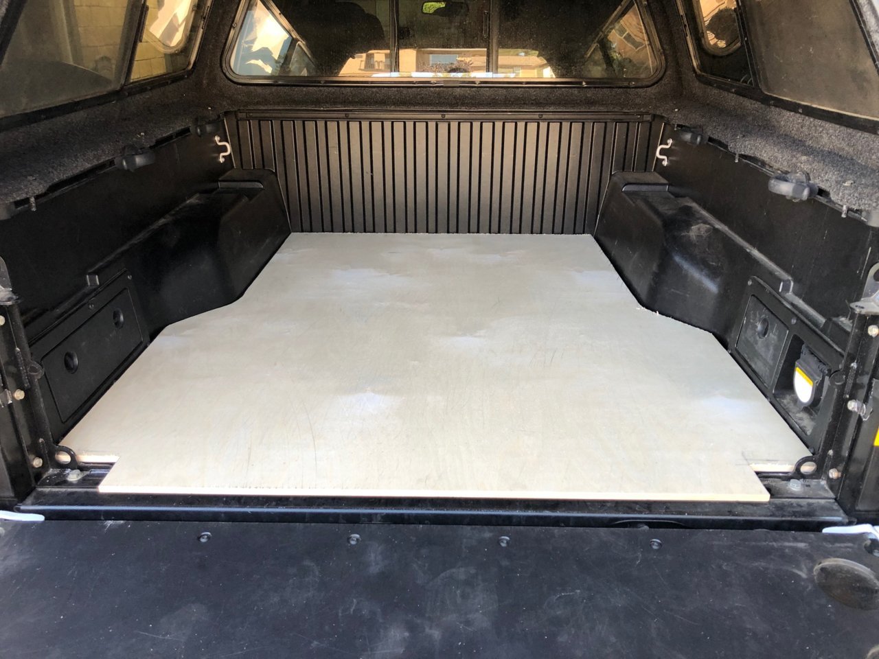

    So I made a baseplate today for my fridge slide and maybe build some storage boxes in the future. Went to the lumber shop and got a 1/2” 5'x5' birch.
    How are people bolting their baseplate down to the bed of the truck? I noticed there are 3 drainage holes at the rear of the bed towards the cab. I am thinking I can use 10 mm side bolts there. One hole the gas tank is blocking so I will not use that one. Not sure how I can secure the front of the baseplate near the tailgate?
    Also I am thinking of getting this thing Line X'ed. Goosegear uses Line X for their baseplates. Want to have the baseplate waterproof as much as possible. Want to get a wood router also and make the front lip a 45 degree slope so I don't snag things when loading stuff inside.

    I did like a couple others and utilized the bed mounting bolts to secure my baseplate. If you check out my build thread there are some pics, but I’m just using the front two and middle two bolts. Been driving around like that for a month or so and it’s stayed secure w/ no issues. You just have to support under the holes w/ washers to keep things tight when you torque them down.
    Also, I got a quote to get mine line x’d as well and they wanted $250. In other words I’m probably going to by a DIY kit and coat it myself.
