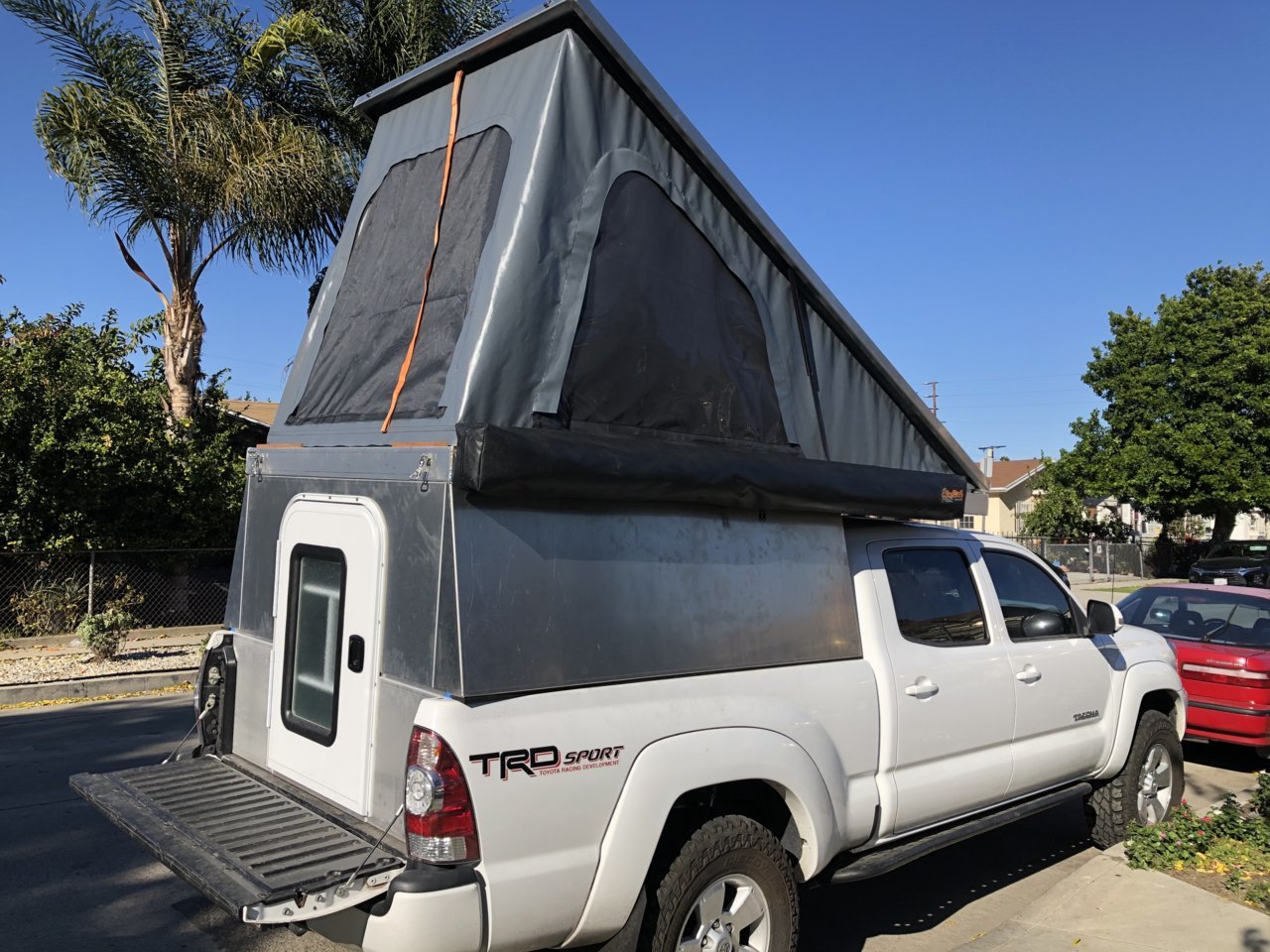

    Got the tent mostly done. Just need some binder work and ready for a test run.

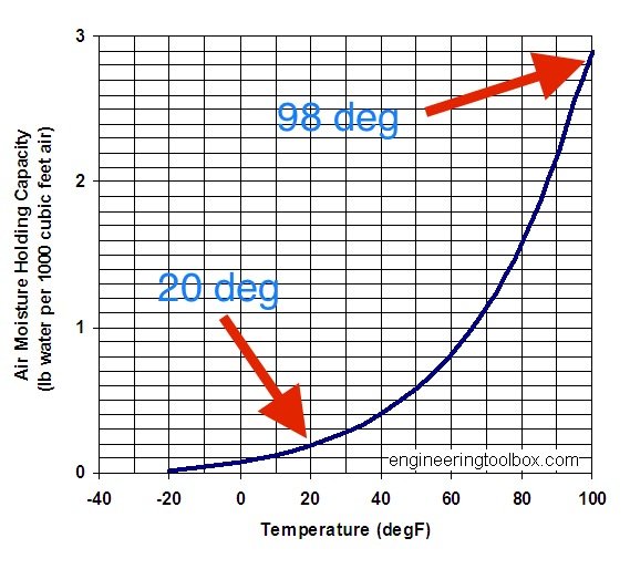

    Sorry to say, but I think a Propex is your only long-term solution. Physics is a bitch. We breath out lots of moisture at night, potentially up to a liter. At 98 degrees, all the moisture stays in water vapor form. Once the breath cools to 20 in the camper, it passes the dew point and most all that water is forced into dew. Air at 20 deg can hold less than 10% the water that 98 deg air can.
    There are only two strategies I know of to fight this:
    1) Use a fan or windows to let the vapor escape before it condenses. This will bring the interior of the camper down to 20 deg. Too cold for my wife.
    2) Install a Propex to keep the temperature in the 60’s. This will allow most the water to stay in vapor.
    In either case, insulating the tent will reduce the amount of condensation.
    I have a BedRug installed to insulate the bed and bought the wall insulation with no side openings. I know that I will be buying the insulating package as soon as it drops. And the Propex is my first project.
