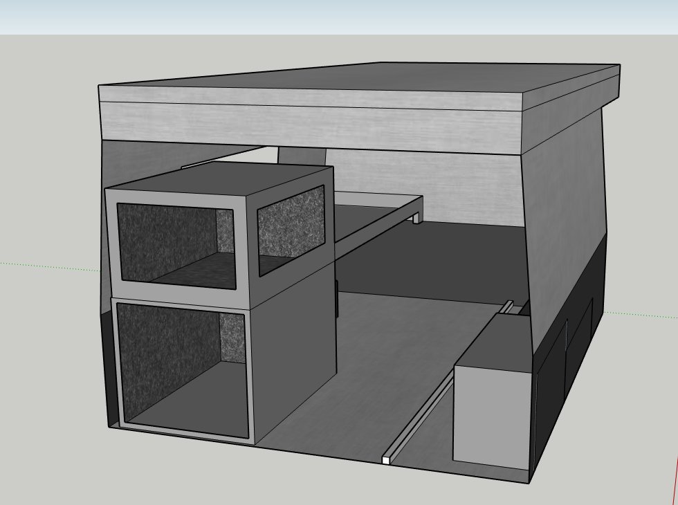

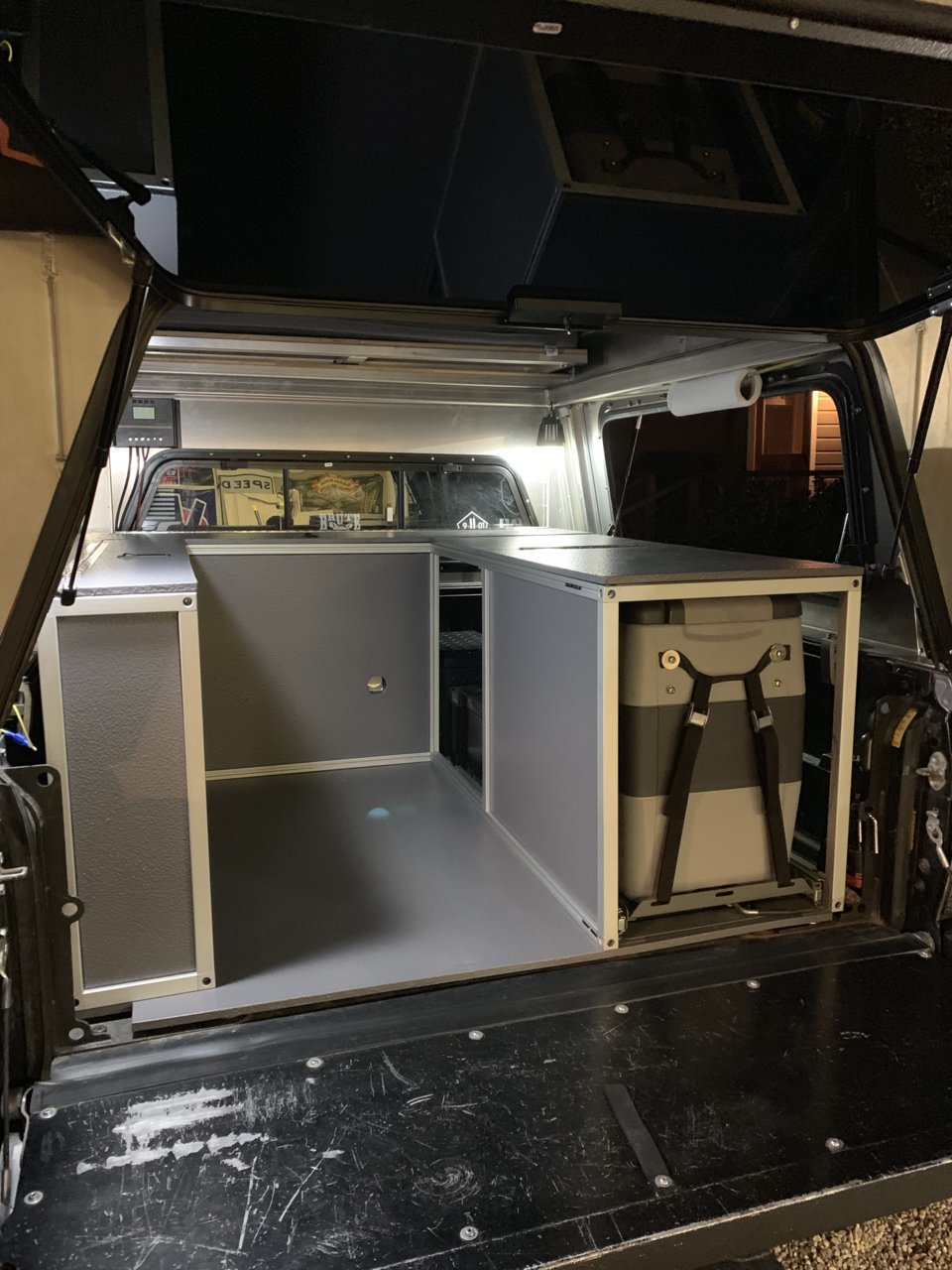

    So when I get my drifter I plan on using alu extrusion to build some storage in my bed like below. I'm wanting to build much of it before pickup but the only thing I'm curious about is how I'm going to secure it to the bed. Lower parts will likely be bolted through the bed itself, but I'm trying to think how I could attach it to the lip of the camper where it clamps to the bed. Any ideas?

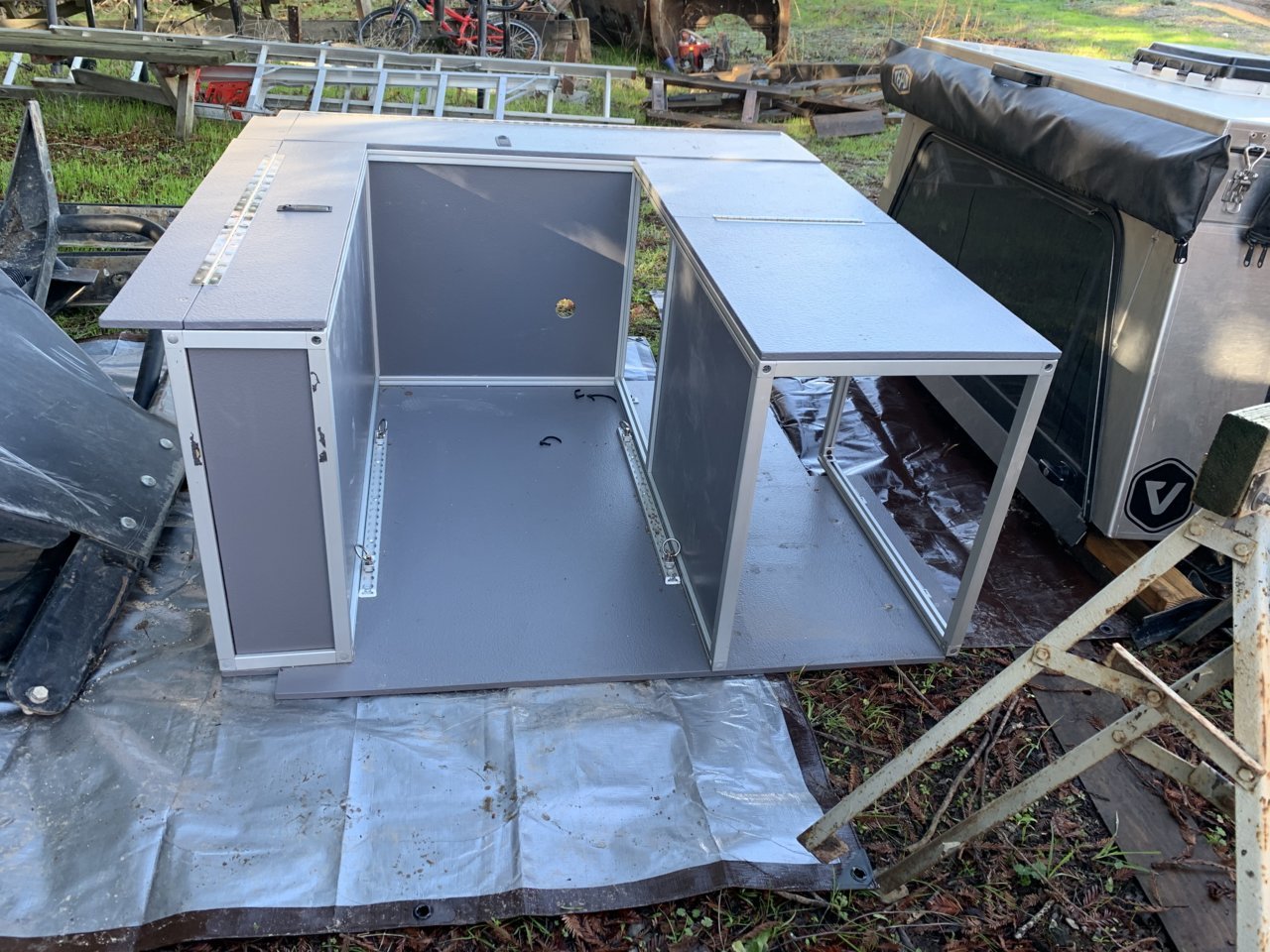

    I have my buildout from my truck available for sale if anyone wants a shortbed buildout that’s ready to go. Made out of 8020 and Birch. Double coated in MonstaLiner.
    Let me know

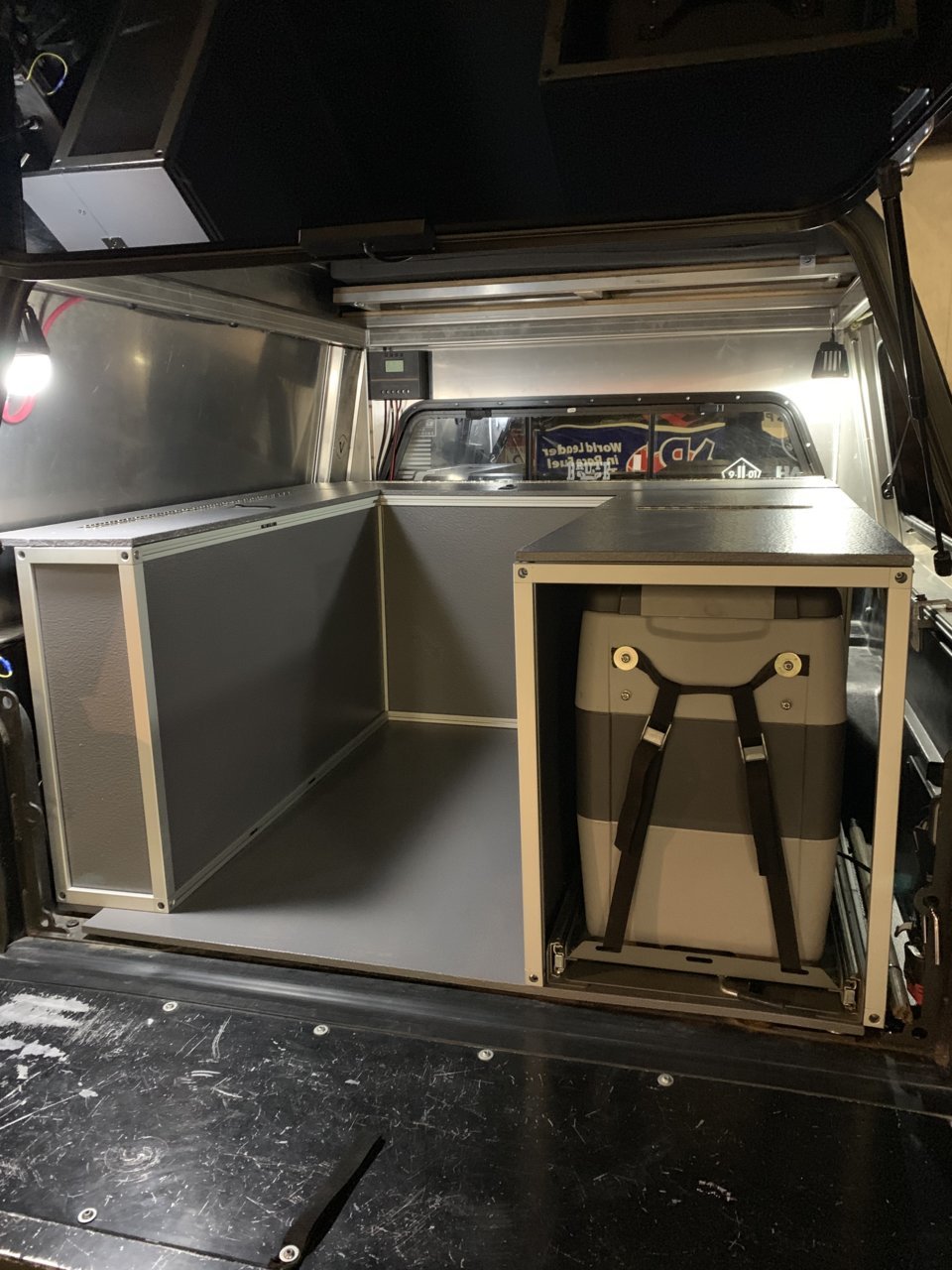

    I made my aluminum cabinets to rest on the bed rail on top of the camper lip. I installed threaded inserts in the truck bed to bolt in down in addition to clamping to the bed rail. It's a bit hard to see in this picture but the bed rail clamp is shown:

    Just making some space for another build. A little longer version.
    It was a Lot of work to get it dialed in and figured out for sure.
    The double coats of monsta loner make it damn near indestructible.
    Come snag this and you’ll be ready when the drifter is ready! And not having the drifter yet makes it really easy to load just the way it sitting there now LOL

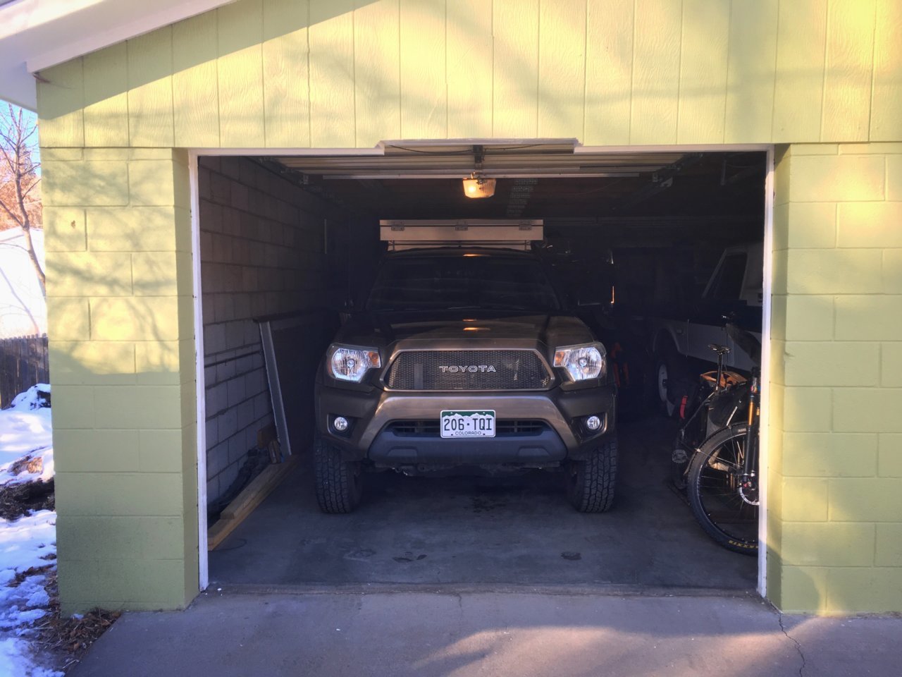

    I'm a dumbass (I have been told this before). I mentioned over in the Specs and FAQ's thread that I had modified my garage to fit the Drifter. Meant to put that here on the mods thread - I figured garage mods related to the Drifter made sense. Now I see I had the wrong thread somehow. Sorry, VO guys! Someone asked for a photo, here that photo is, along with the original post that led to the photo request:
    >>Okay... has anyone else taken a saw to their garage in order to fit the Drifter inside? o_O
    Yep, I already did it. The fan/deflector shield just needed another 2"... pulled the trim down to the header, notched the siding, re-trimmed on either side of the notch, scabbed in some trim inside the header box sections that were exposed, and repainted everything. Also had to modify the garage door lifting linkage. Nope, it's not pretty, or perfect - but neither is my old house/garage anyway. It looks good from the street. And most importantly, now I can work on the buildout next to my old-school gas garage heater, instead of out in the freezing Colorado nights.
    Commitment. :D<<

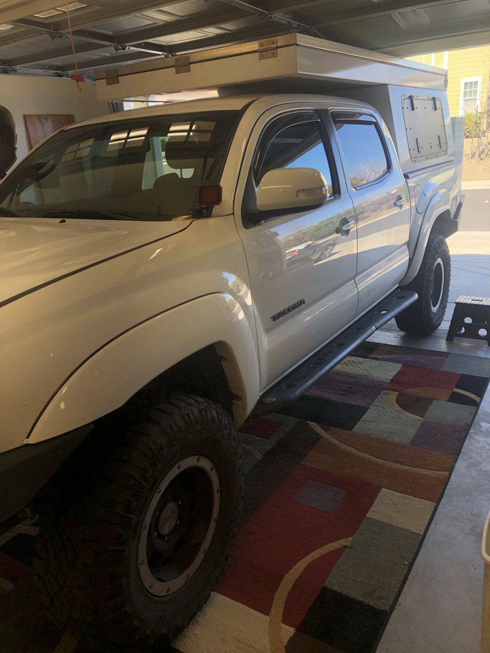

    Oh, I interpreted this differently. Now that I have a visual with the photo...
    Yeah, I’d need to move my header up another 14” to safely move my truck in and out of my garage.
    Again, if only my wife would let me (I know there is space to make it happen. I’ve inspected the attic to make sure).

    Yeah, 2", not 2'! :)
    Either your garage door is really short or your Taco is really tall. Or both?

    A little from column A and a little from Column B.
    My garage sits at the peak of the driveway. Meaning my angle of entry is slightly askew. You’d think it would be in my favor for a lifted truck. But, with a drifter, tons of mods and bigger tires being installed this weekend... 12-14” would be a safe height for leaving the racks attached and all.

    For reference. These are with 33’s. Notice the rear tires haven’t made it up onto the pad of the garage floor. The 35’s happen this weekend...
