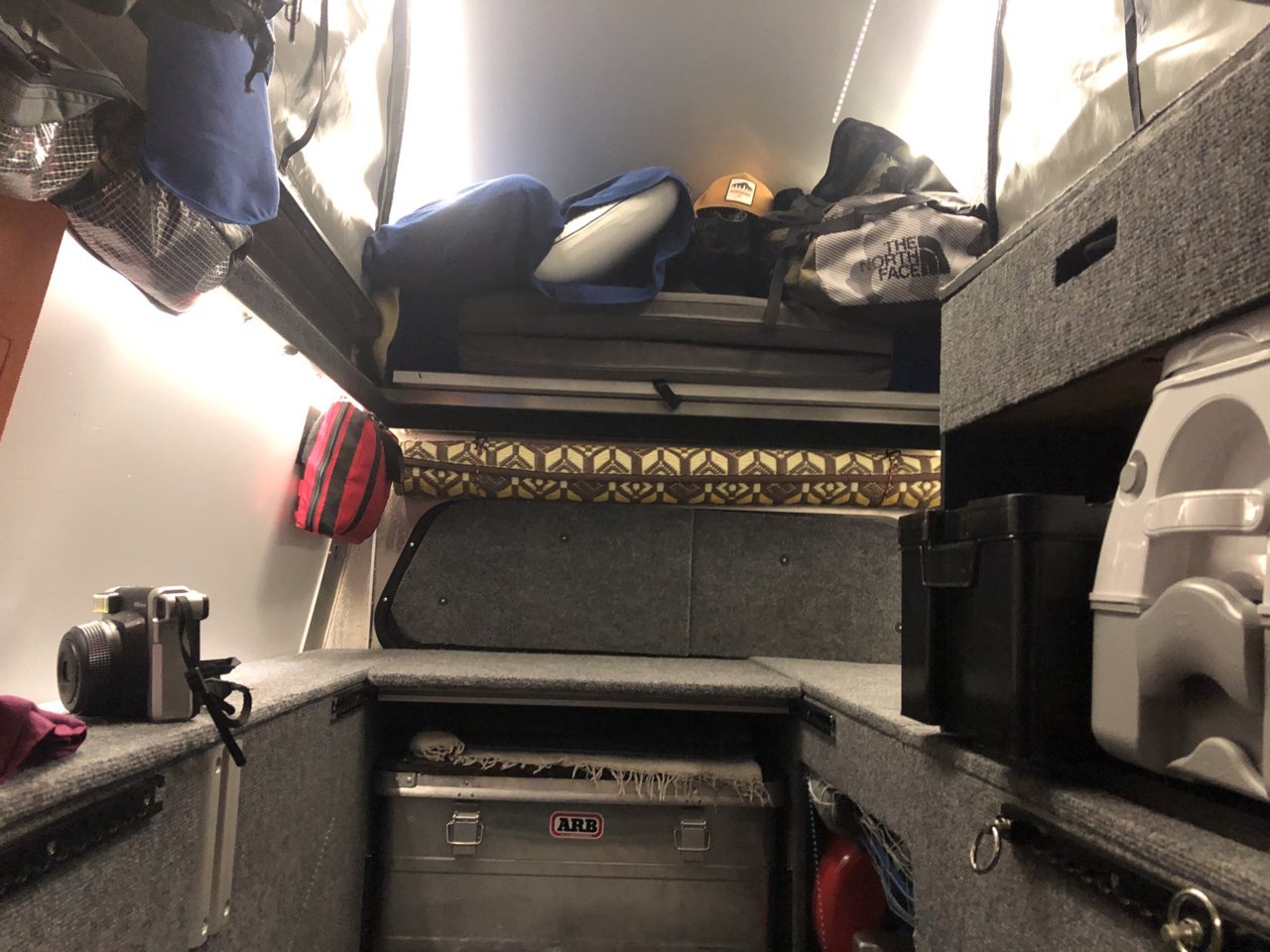

    how long ya talking? My wife and I have “lived” out of ours for a few weeks at a time. Ol Brian ( @danneskjold ) was full timing it in his until he went full size.
    His interior set up and ours are pretty similar, and similar to a lot of other that have done full builds. Probably the biggest difference in space between ours and others are we chose to not have a “full” bench on the drivers side to give more space to move around. Apparently I don’t have a recent photo of how it’s set up normally. Below is a not great photo of what I refer to as “Hunker down mode.” The box that is on the side with a drawer and hiking our toilet and a front runner box, normally rides between the benches up where the Alu box is currently. The alu box is our step normally and holds our dry food and cook stuff. For winter I move the box to on top of the right bench and that allows us to slide the skybox to the front. The floor section gets moved up and placed on the rails to maintain a front bench seat. All that allows us to pop the top and do everything inside the camper if needed. Hope that all makes sense typing on my phone lol
    that’s a steal!
    Edit* now that I see this on my computer, that's a shitty photo lol ill get a better one

    I see what you mean where it’s one large bench on one side, I feel like that’d be the least claustrophobic set up
    I’m thinking of months at a time
    Do you think a DCSB would be too tight even if it’s just my dog and I?

    Take a look at Blake's set up in the quote above. He did basically the same layout as I did except in a short bed and it worked well for him. The build that Brian had in his short bed when he was full timing it was a little closer in layout to the Vagabond interior offering from Goose Gear. It has a little skinnier Isle way. I don't think either set up would be too tight for you and your pup. If you decide you want a standing height portion on one bench you could move it to the front/LH corner, that way your doggo could hop up on the bed when its collapsed. That's one benefit of the Short bed drifter is you have a little more space in the overhang area when the bed is collapsed than you do in a long bed.
    Ultimately you just have to figure out what you're going to be using it for and build your set up to suit your needs. A lot of people are only running one bench and keep 2/3's of the bed open.
    Depends on where we are. Most of the time we use a little Mr Heater buddy hooked up to a 5# tank. it doesn't seem to have as much problems with freezing in super cold temps as the little green bottles do.
    That photo is camped out at our local ski resort. They have put a stop to camping in the parking lot unless you are in the "RV" lot which has electrical hook ups, so when we are staying there to shred we take advantage of the power and have a kick ass little electric heater that runs full time on a thermostat. Keeps it toasty in there.
    To date, regardless of heat source I seem to wake up hot when we are snow camping
