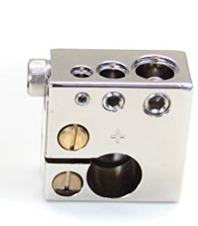

    Can anyone (w/ a dual battery set up or even lots of accessories off their main battery) recommend a good set of terminals that allow multiple hook ups etc. to replace the factory terminal ends?

    Well, right now I am completely stock and working on adding a second battery (housed in the bed) and a Redarc DC-DC charger to keep it charged. I know I will making simple hook ups to the main battery as part of this, and down the road maybe adding things like aux lighting/winch off the main battery as well as things grow. I was just looking for a good set of terminals to replace the stock main battery terminals that would provide rooms for these hook ups.

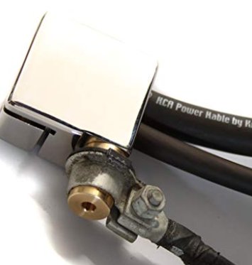

    https://www.amazon.com/dp/B01LLWKXV6/ref=cm_sw_r_cp_api_i_w6HhEb2N6V3YP
    this is all you need if you are just looking for more wire mounting options
    edit- another option would be to use a marine battery as you get an additional post with those which is nice for hooking more stuff too.
    that said, I’d just hook accessories to something like a bluesea fuse panel or a switchpro then hook that to the battery.

    Thanks all.. yeah, this what I am talking about. These may be the fanciest I have ever seen, but that's what I was looking for more or less. I have spoken w/ folks like OGE and others, and while they definitely offer nice turn key solutions, I would sooner put it together myself.
