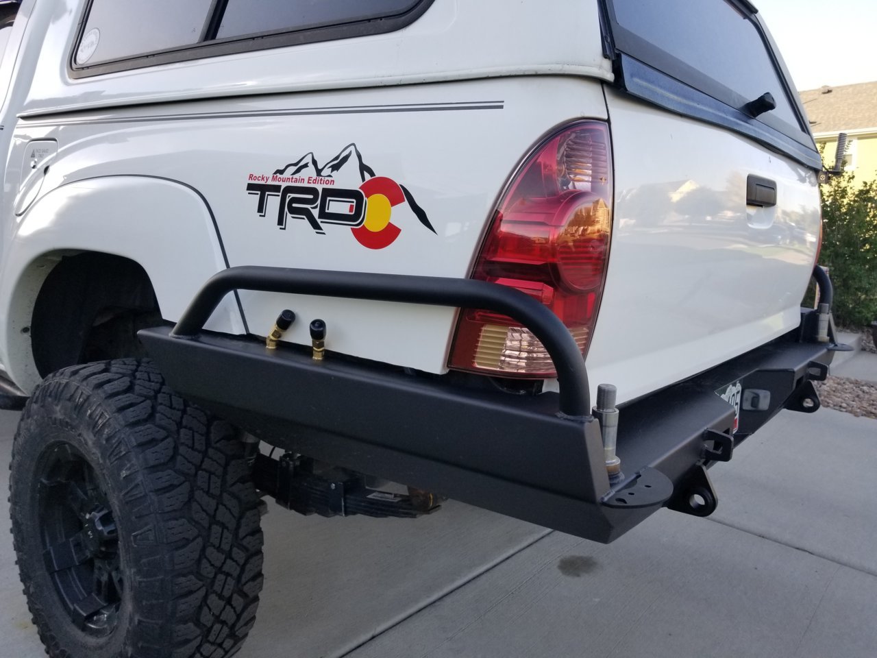

    Just some options but I'm running this from a fellow member. I have a HC dual swingout bumper so I mounted the disconnects on the driver side of my bumper and just throw the hose into the jug that's right there on the bumper.
    *edit for pic
