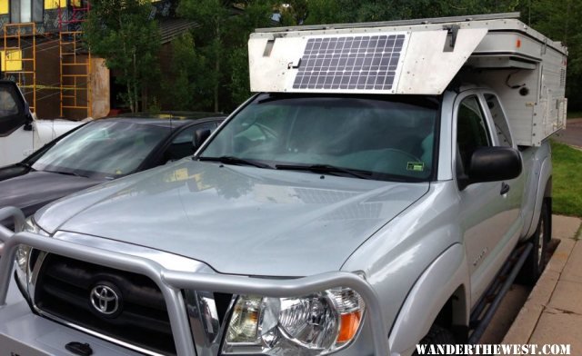

    I also have been thinking about a prinsu as a base for streamlining the roof, but agree on the price being ridiculous. I've seen a taco around SLC with an AT habitat that uses a solar panel as a wind fairing. I kinda like that idea, if I could mount the solar panel with some sort of quick release brackets.

    here’s that solar one off WTW. Just googled search ‘camper Tacoma wind fairing’ and a few will pop up.

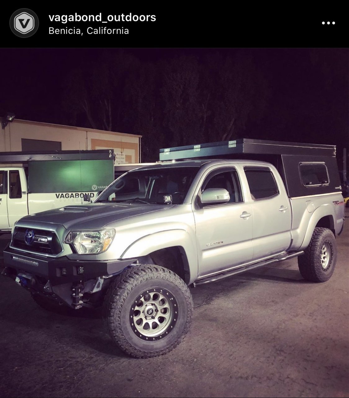

    I wonder if a long bed would be able to accommodate the second set of mounting brackets...?

    Appears you get a little more room. Not sure if it’s behind he middle mount holes. Take a gander through their rollout vids. A few DCLB and ACLB’s with drifters.
    I know with full-size trucks they offer a larger overhang, as to provide a ‘living space’ while the bed is deployed. They acknowledge someone may want to be in the ‘downstairs’ while someone else is in bed so they extended the platform over the otherwise wasted roof space on the bigger trucks.
