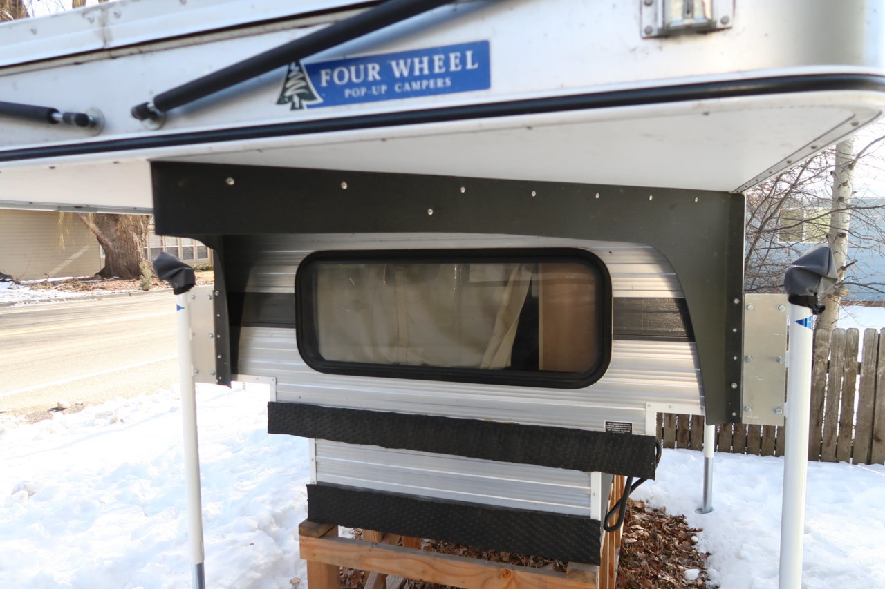

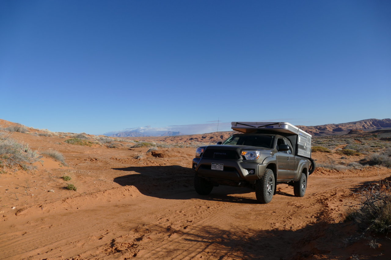

    Yep, here you go... it fit nice and clean along the top and back of the cab. Screwed aluminum L-track to the cabover, made cardboard templates of the shape I wanted, cut ABS sheets to match the templates. Riveted the ABS to the aluminum. Bent the ABS angle where it met the camper with a heat gun and a homemade jig, then bolted that area onto the camper using bolts that were already there for the camper jack mounts. It made things so much quieter... and might have improved the MPGs a little, but not so that I really noticed.
    I'm not worried about making a fairing for my Drifter, it sits much lower to the cab and is narrower. Seems like very diminishing returns to make any sort of fairing to me.
    Also - even with the pre-fairing FWC, I could get 17-18mpg if I kept it around 55. Aerodynamics vs. speed is everything if you're looking for good mileage with a camper. Take an FWC at 75 on the freeway and expect to get 12-13mpg...

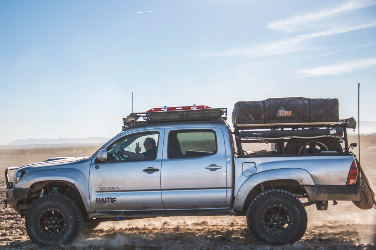

    I’m at $10k+ with the Drifter and Drifter mods and we’re worried about MPG? :p:p:p
    But in all honesty, I had a bed rack, RTT, and roof basket before the Drifter and I have since gained 1MPG with the Drifter. Now I’m at a whopping 12.5MPG
    Old set up

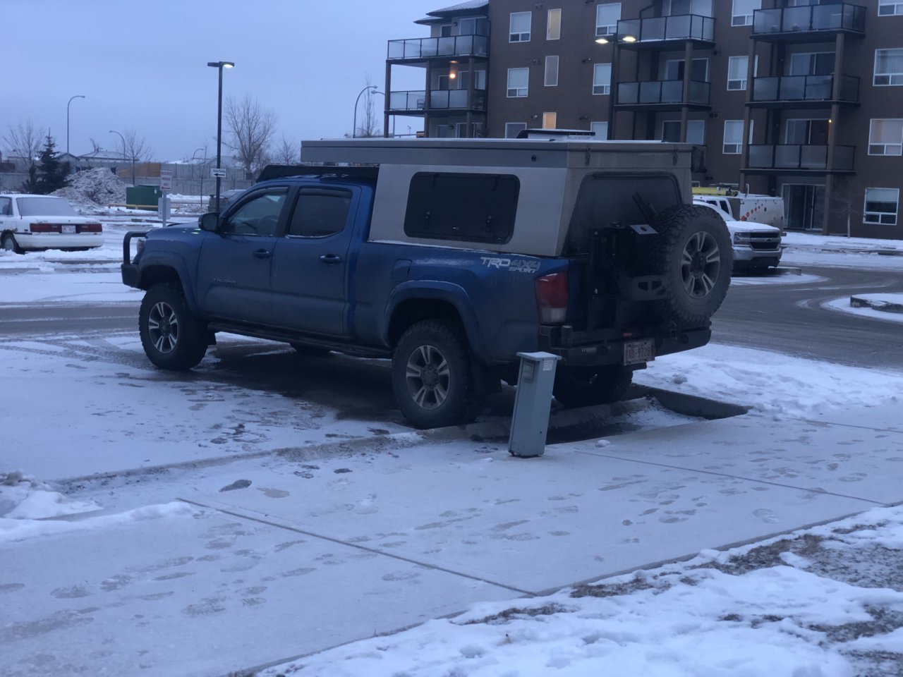

    Sorry for being a jerk and posting someone's else pic without permission. But here it goes:Vagabond Outdoors Drifter blue Tacoma.jpg
    Prior to my Drifter install in October, I sent the pic to Phil and asked about this solution (Prinsu). But unfortunately as someone also stated, the pic was of a 3rd gen. My truck is 2nd gen.

    Are you willing to cut up a perfectly good Prinsu? If so you can make it work like @jberry813 did. Don’t think he did it for MPGs though....
    Hard to see in that picture, maybe he’ll chime in but it’s hacked up pretty good in order to clearance.

    Yea 3rd gen beds sit higher than 2nd gens. So when the Drifter is on top of the 3rd gen, there’s more space between the cab and Drifter overhang to account for a rack in between
    However @tyfoon11 has the oem roof rack with his 2nd gen and Drifter

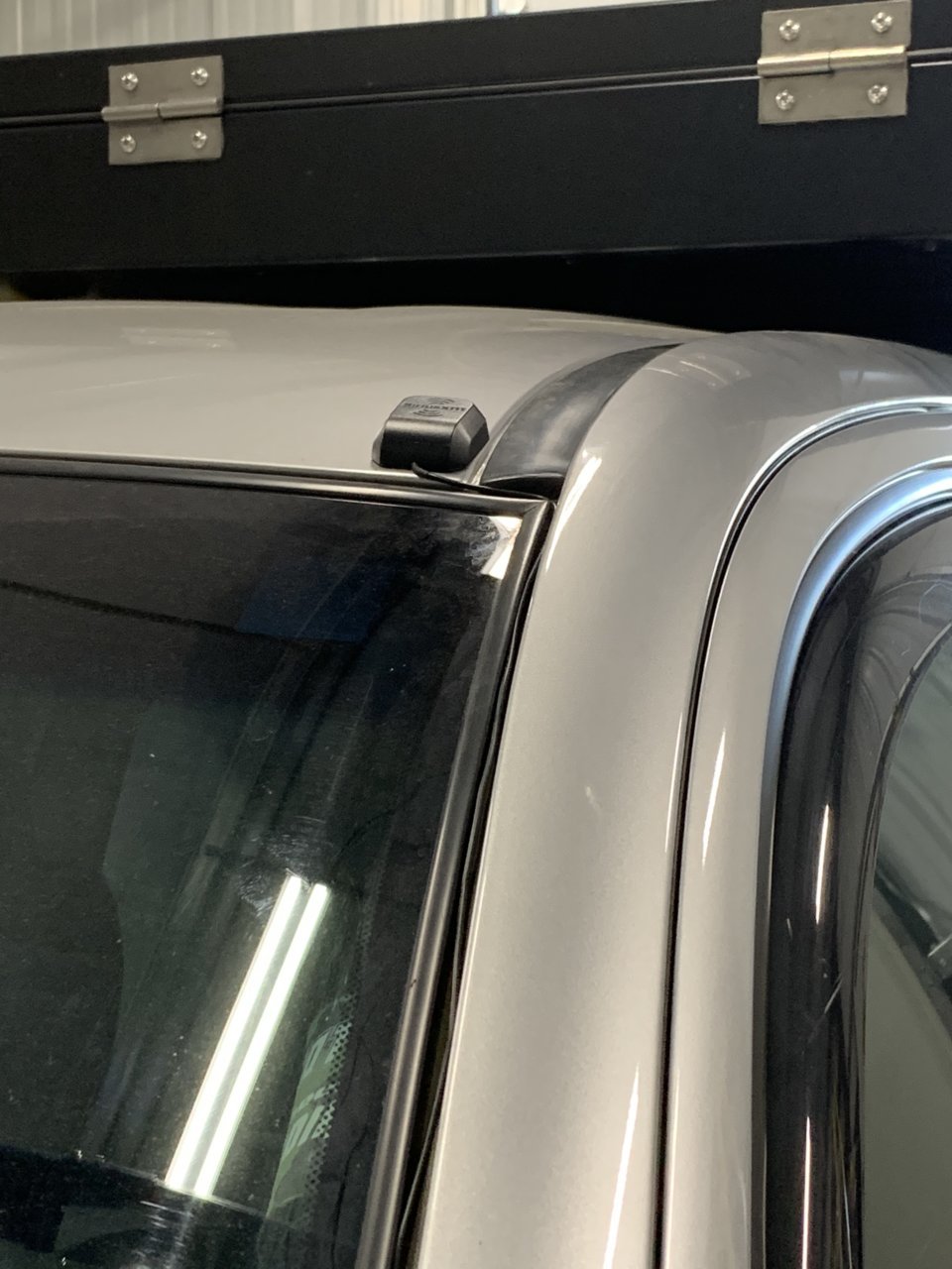

    With the drifter's metal overhang concealing the radio sharkfin antenna on the roof, are ya'all still able to receive GPS navigation signals to your Entune radio ? or is that gizmo only used for XMRadio ?
  8. Feb 9, 2020 at 2:34 PM
    #2908
    Anderson
    Anderson Dudemanbro
    May 21, 2014
    #130329
    3,628
    Anderson
    Benicia, CA
    ProBro
    Stuff
    GPS still works. With caveats. It’s running on partially stored data. So it makes up for lack of signal in some areas with stored data.

    My nav still works fine. No issues.

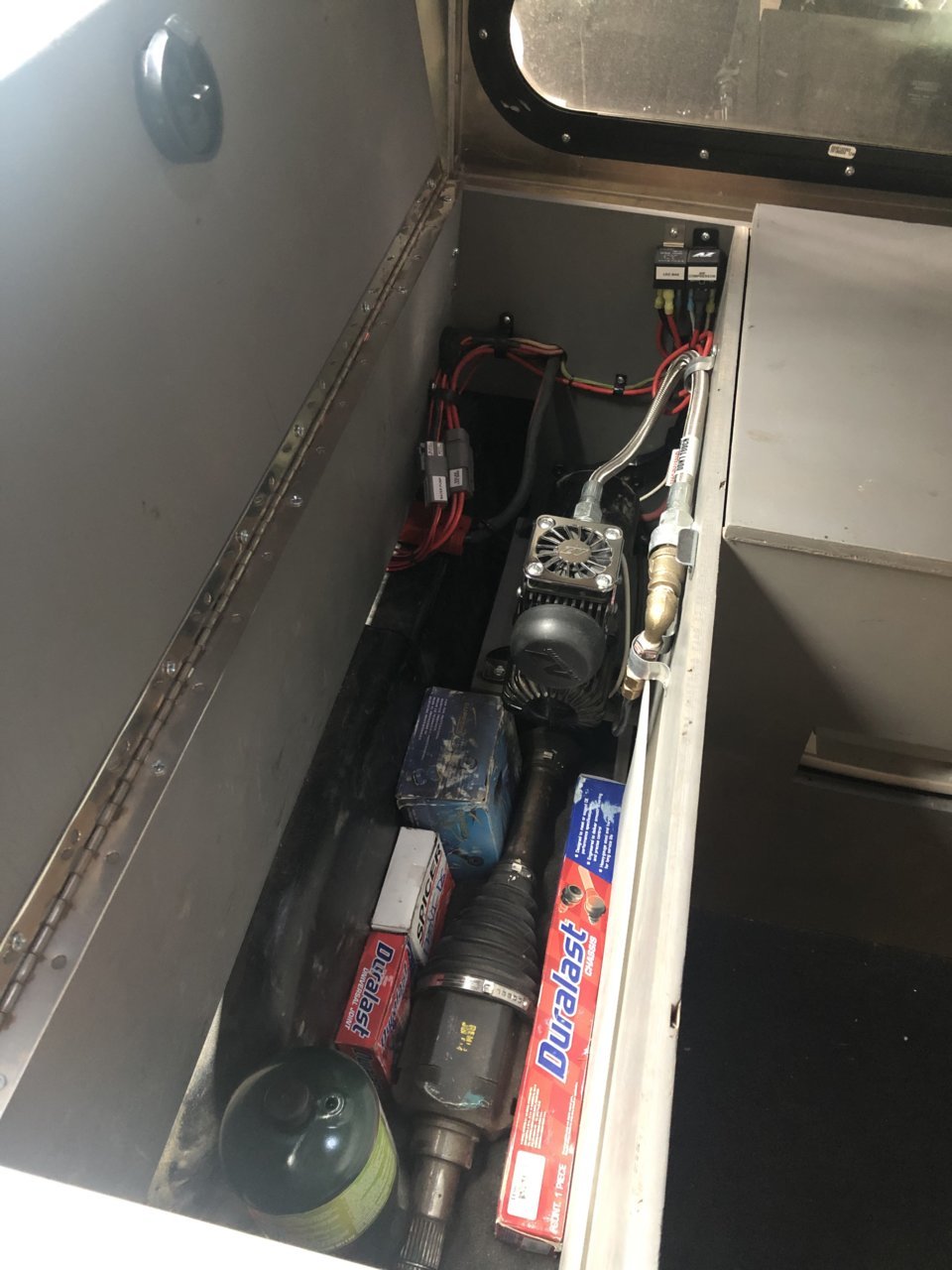

    I used Deutsch connectors mostly, but I did use an Anderson connector (can see it under Deutsch connectors) for the aux fuse panel since I used a larger gauge.
    Can kind of see it here (top left)
    overcast, tacomgee and tyfoon11 like this.
