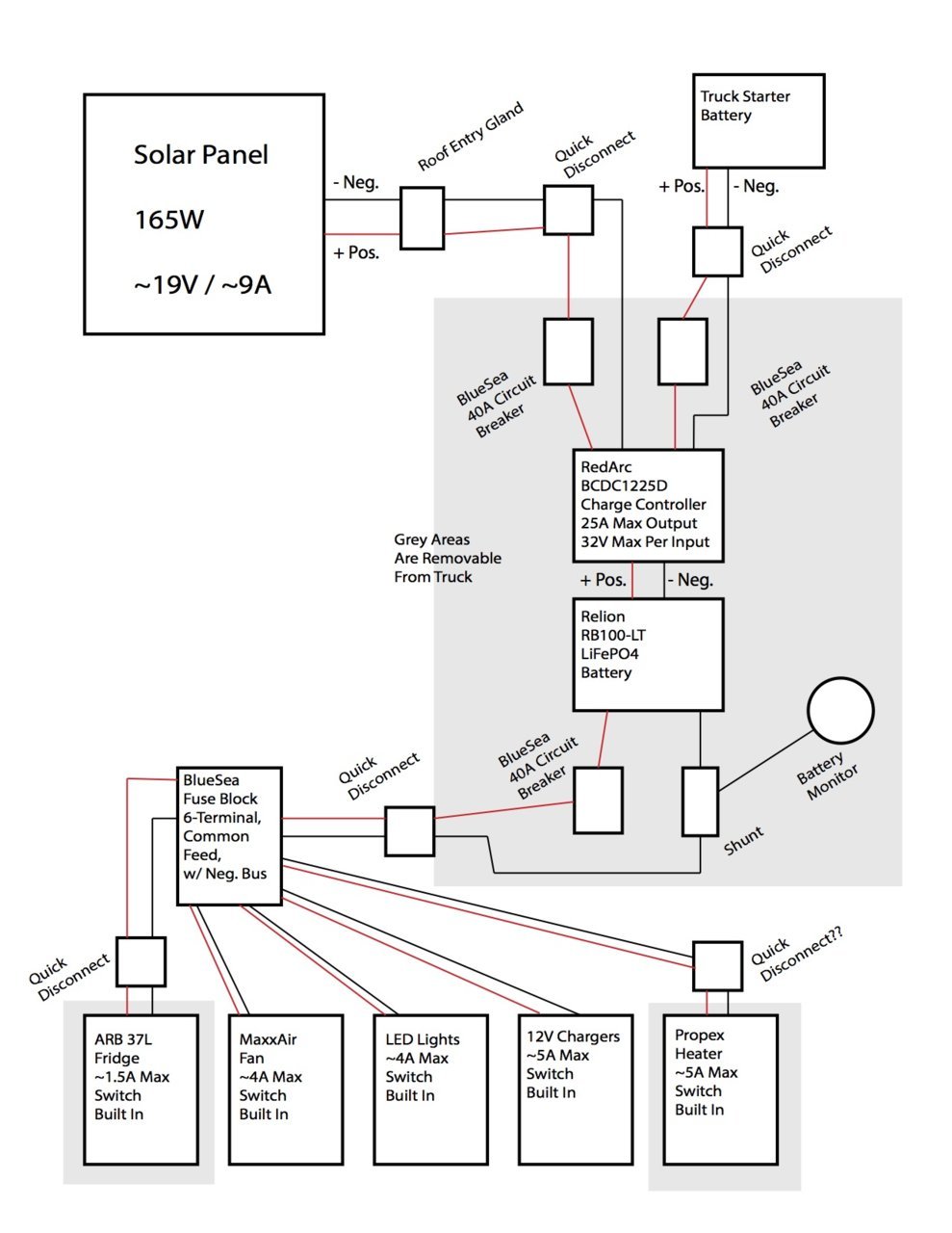

    Here's an initial wiring diagram. Anyone have any constructive critiques? PDF attached if you need it to be larger. Large portions of this system are removable...

    That's about what I'm thinking. Not "quick-release" or anything - just a few bolts per side, and I'll be building the cabinets as light as possible. Considering making the panels (that slot into the 80/20 "skeleton") out of layers of coroplast and aluminum - light and tough. Tops will need to be 3/4" ply or something, of course - want to be able to sit/stand on them. But the panels aren't really structural, so they needn't be heavy!
    I'm thinking all the items in the large grey rectangle in the diagram above - controller, battery, breakers, monitor - would be hard-mounted to an aluminum box or something - hit three disconnects, lift the box out, away you go. Fridge comes out, cabinets come out. 10-15 minutes and your truck is ready for Home Depot duty.

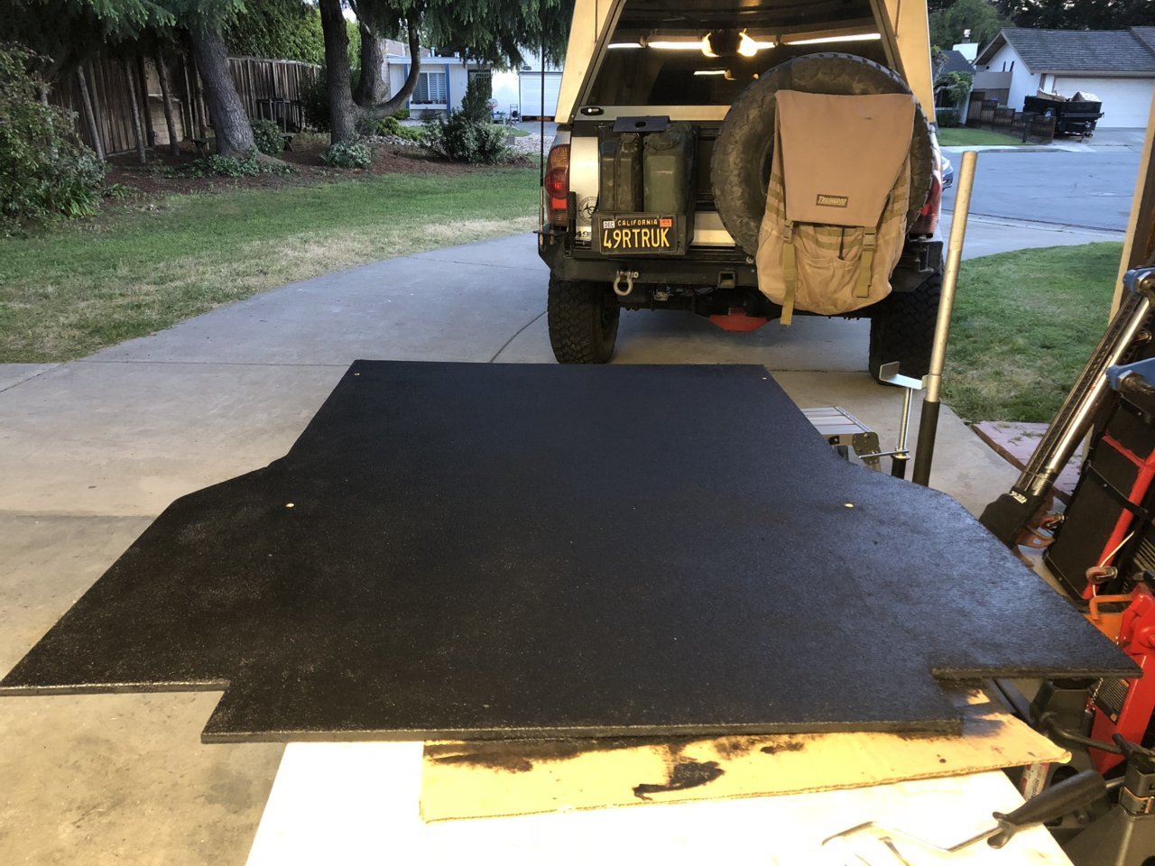

    I think it came out to 3 washers (per bolt) that matched the height of the ridges in the bed.
    Essentially, from top down its the baseplate, washers, then truck bed. That way when you fasten the bolt, the washers prevent the baseplate to warp because in that area because the bed isn’t sitting directly on the bed because of the ridges.
    Similarly, the baseplate doesn’t sit directly on the bed right near the tailgate, so I doubled up on the baseplate in that small section

    @MJonaGS32 so you have a total of 4 bolts holding the plate down? Looks like the rear two, the middle two and then you have bed stiffeners in the front

    That’s correct. And the oem bed bolts are long enough to account for the thickness of the 1/2” birch baseplate, so you can reuse those

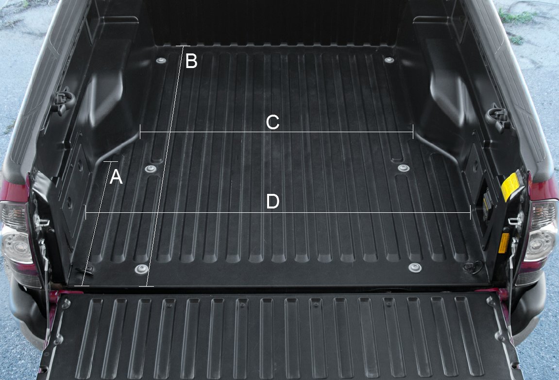

    Heads up in case anyone plans to use the rear (tailgate) bed bolts through the baseplate, those two bed bolts are NOT long enough, at least on 3rd gens.
