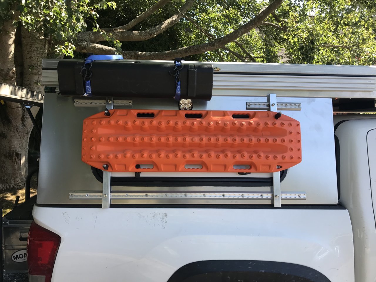

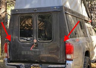

    What is the purpose of the black vertical pieces at the area where the tailgate meets the bed sides? Thanks!

    Sounds like you crossthreaded one of the maxtrax bolts. New nuts/bolts can’t seize up randomly.
    Before you do anything else, like moving lights that work. Take a day or two to plan everything out. Seems like one mistake is covered up by another impulse action that doesn’t work out. They’re starting to layer themselves.
    Awning mount holes didn’t line up led to huge extrusion piece, which led to a water port mount that isn’t working. Above a door you paid to have installed, covered up by flat bar for maxtrax, which have a user crossthreaded pin which is ‘garbage’.
    And your solution seems to be to move the light, seemingly the only working piece to the whole buildout plan. Are you just going to keeep drilling holes in this thing until it’s a Swiss cheese? Awning, extrusion, L track, lights. The more holes the more opportunity for leaks.
    Just some food for thought.

    The extrusion piece was planned from the beginning and it was the only component on the GFC I actually liked. Being able to attach additional accessories as needed without having to drill additional holes is well worth the "huge" 1 inch width extrusion piece. Waterport, clothes line, fishing poles, shovel, etc. The modularity is great.
    If I moved the light those holes would be covered up by the L track, and the current L track holes would be covered up by new l track as well.
    I don't really care if you believe me - but there are plenty of reports on the internet about broken Maxtrax mounting pins with the exact same issue I had - these ones aren't brand new either.
    As it stands now there is only one hole that isn't associated with anything and it's an easy fix.
    I appreciate your concern but it's not totally warranted.

    Part of my tailgate-delete / one-big-door mod. Same concept as on Iggy's original design, except I retrofitted mine instead of it being built as one piece from the start.
    I just painted the wall extensions and lower half of the door so black that it looks less like my truck has a pop-up slide-in camper because WA state stupidly makes you register and plate truck campers as if they were a separate vehicle. Also a reason I made a second drop in floor panel to cover the whole "upstairs", with it in place the floor-to-ceiling height stays under the legal limit for having to register it with the state as a camper (plus it gives a ton of sleeping room for the two of us plus dog.)

    Thank you OutbackHack!

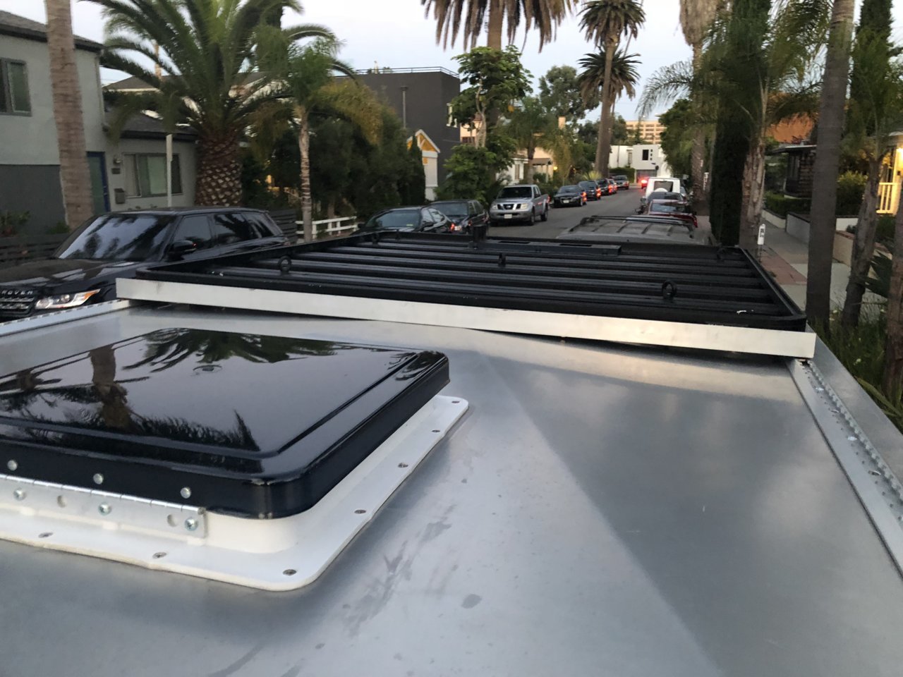

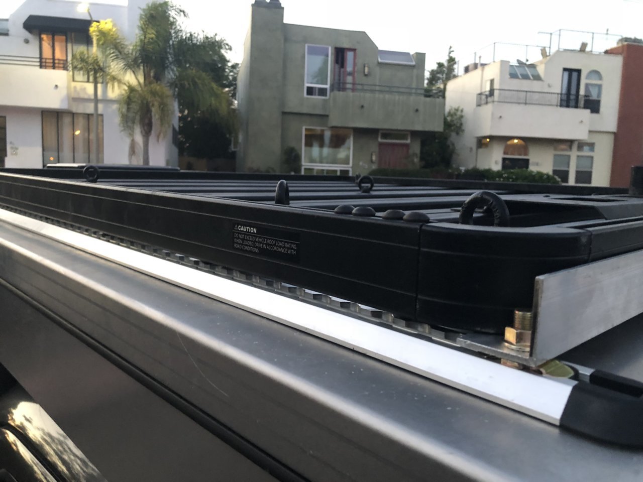

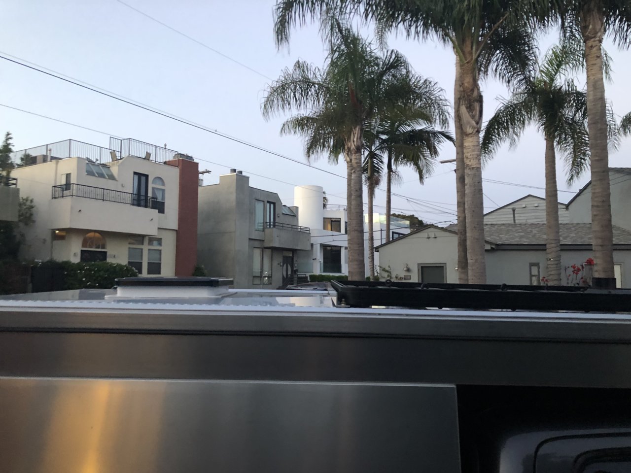

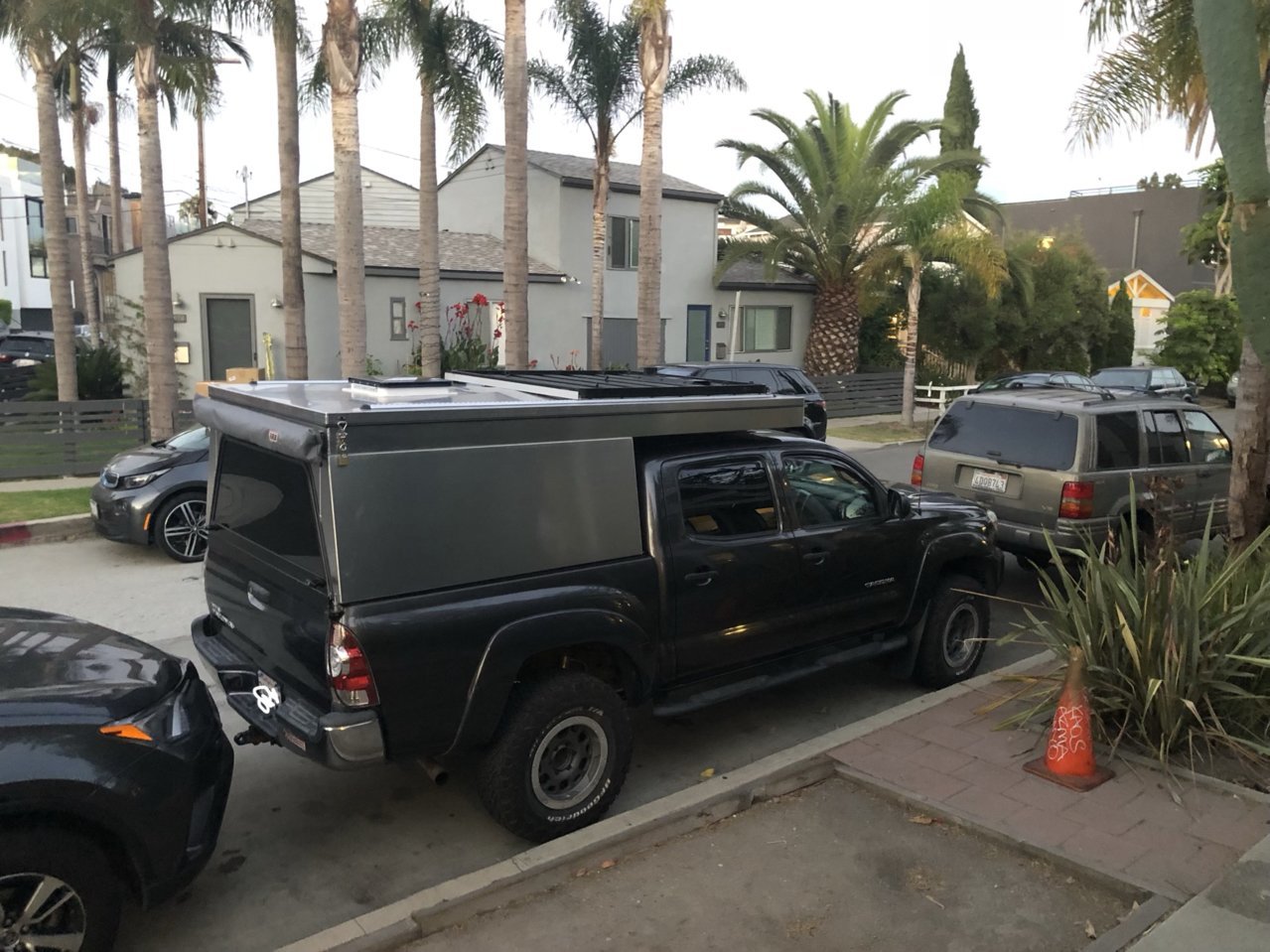

    I did a thing today. Somethings take a little love, this was one of them. A few tweaks to dial it in still but at least I can carry my 9'2". Its snug on the roof bend, about the same height as the fan.

    tacomgee
    tacomgee just ain't care....
    Aug 5, 2014
    #135522
    4,837
    Blake
    NorCal - Ukiah
    2009 DCLB SAS in the works
    Well that looks like a fun place to park o_O

    2012 OR Drifter
    tight would be an understatement. surprised myself

    I wonder if you put some sort of 1/4" or 1/2" aluminum spacers under the rack to raise it off your roof line? Great Job btw!

    2012 OR Drifter
    thanks man. I may move it back a few inches to leave space between the roof bend, but i also have some other taller L track studs to play with. glad i kept the rack
