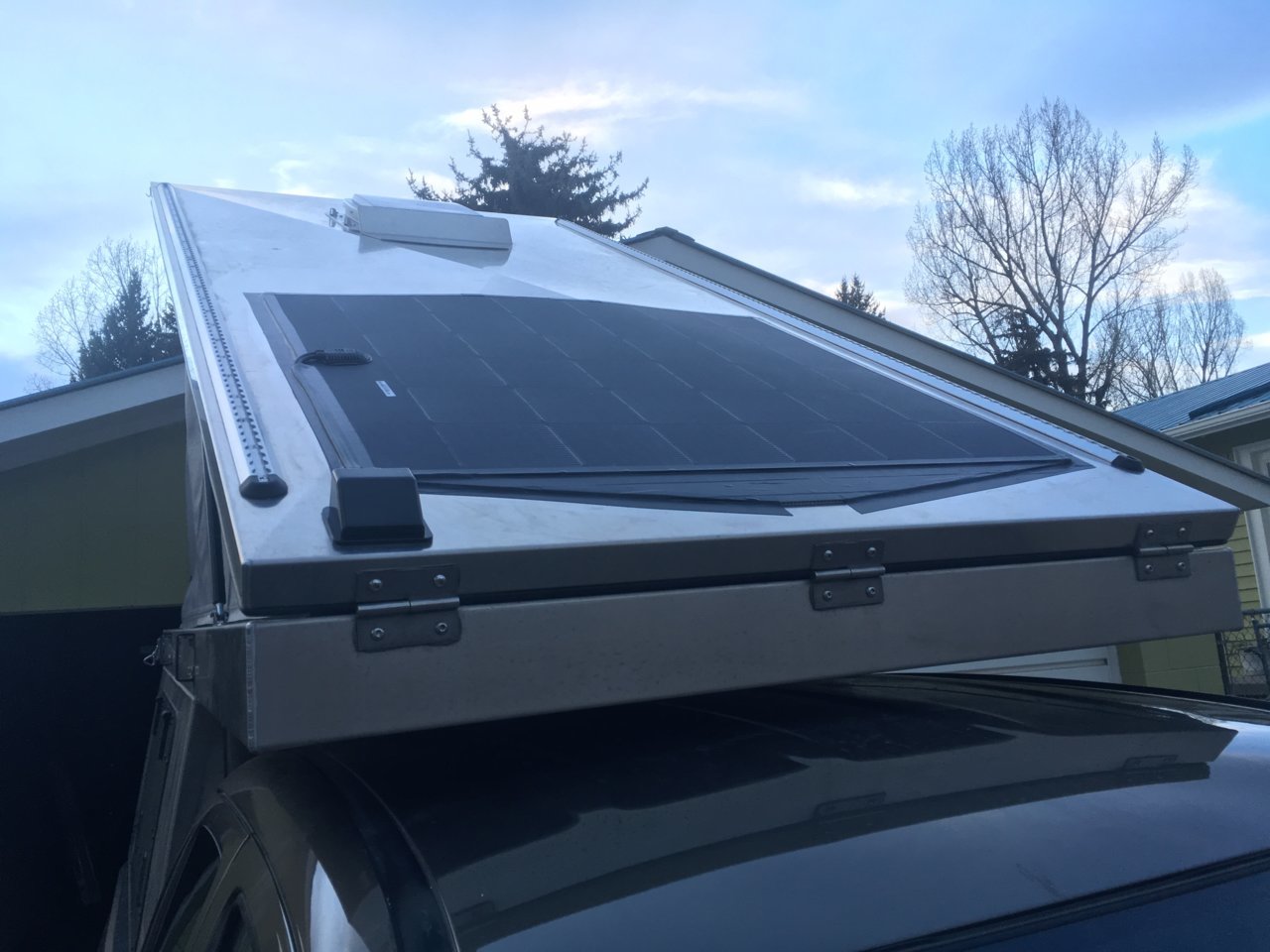

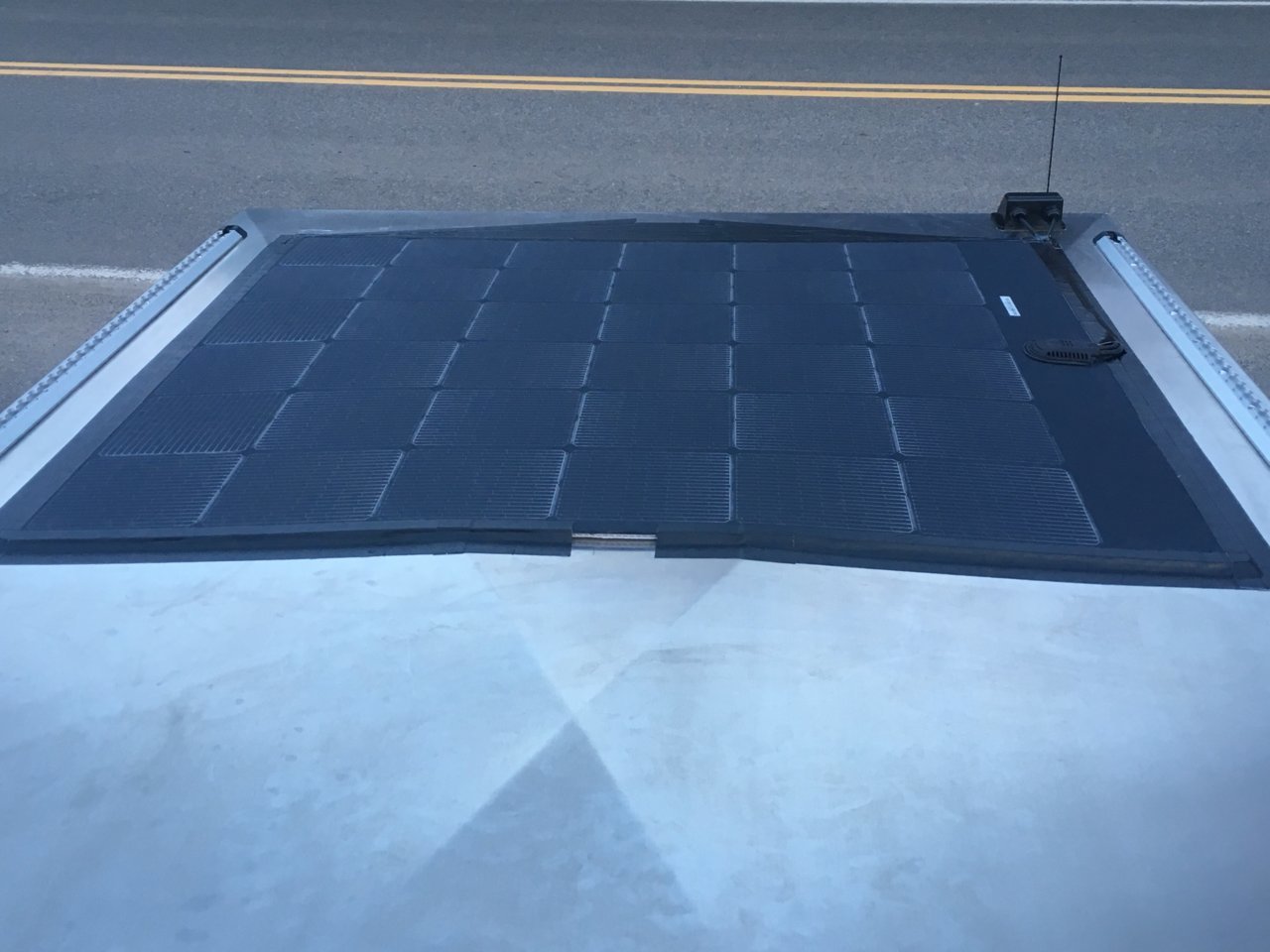

    This happened today - solar panel installed! Always fun to drill holes in new, expensive objects.
    I used coroplast (corrogated plastic) as an insulation layer in a bid to keep the panel cooler and more efficient. Not sure if it will actually make a meaningful difference, but it was $10 to try and doesn't really change anything otherwise. I left a little opening at the front and rear - I know water will get in somehow, so may as well leave somewhere for it to escape. This also allows for some air circulation when driving. I cut the coroplast in a V-shape at the front so that water that gets in while the Drifter is deployed will naturally drain to the bottom of the V.
    I used Eternabond RV tape - 2", black - to mount the panel. Pretty cool stuff. Or at least, until you have to remove it. It's basically permanent and is rated for 25 years in the sun - if you want it off, you're going to be using mechanical means.
    This is a Merlin panel purchased through V.O., and the quality appears very nice. Haven't actually got it hooked up to anything yet, we'll see how it goes once the whole system is finished. The leads came with MC4 connectors installed but they were so long that I just cut them off to pass through the entry gland - I'll use an Anderson connector to plug into the Drifter's solar pre-wire, or maybe even just hard-connect them with a butt splice.

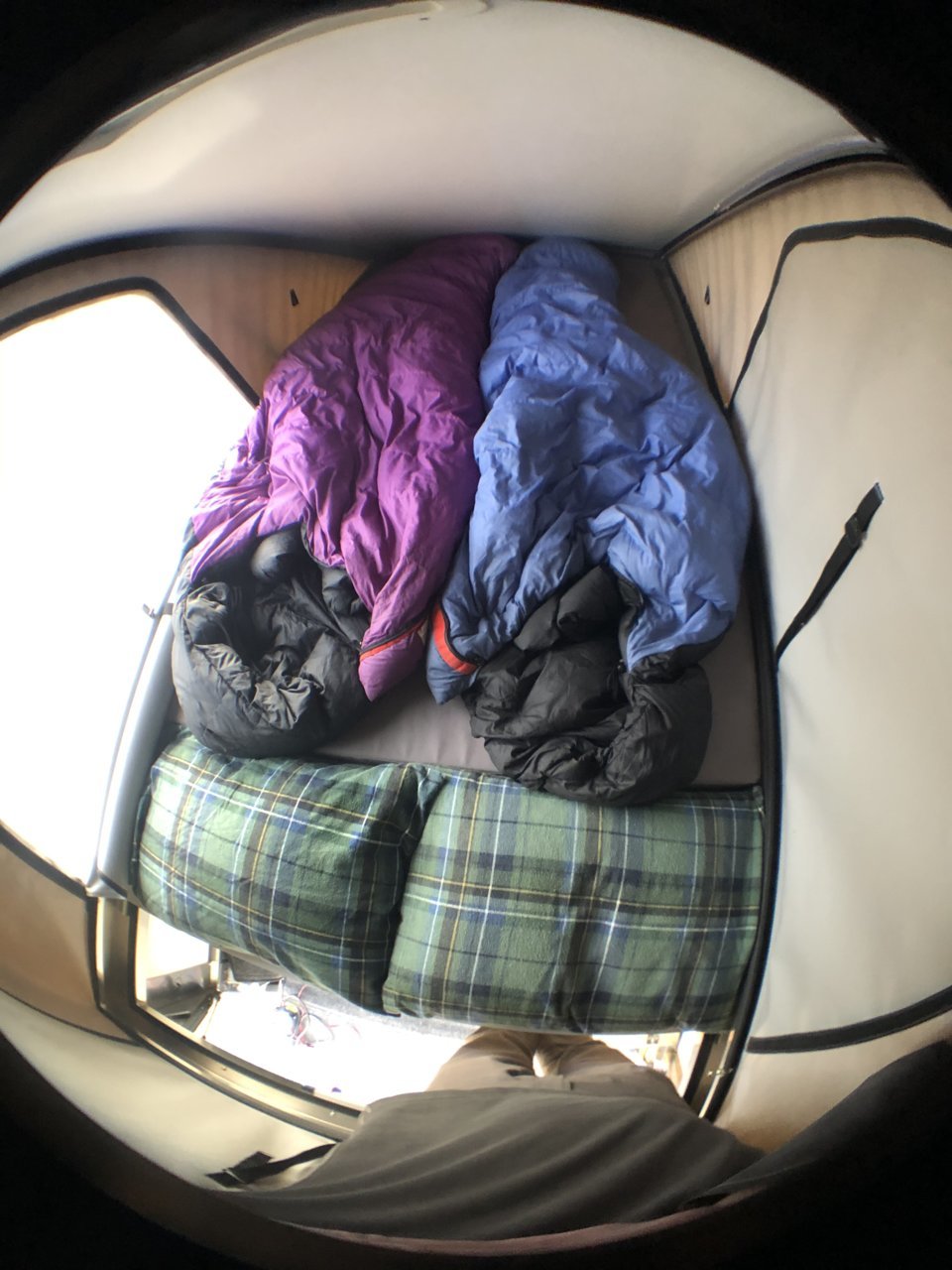

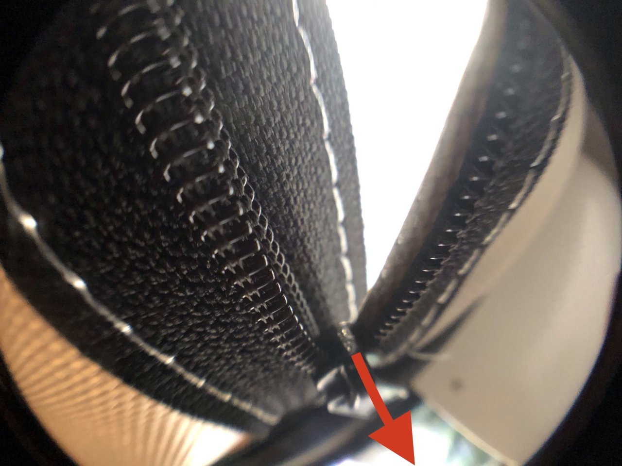

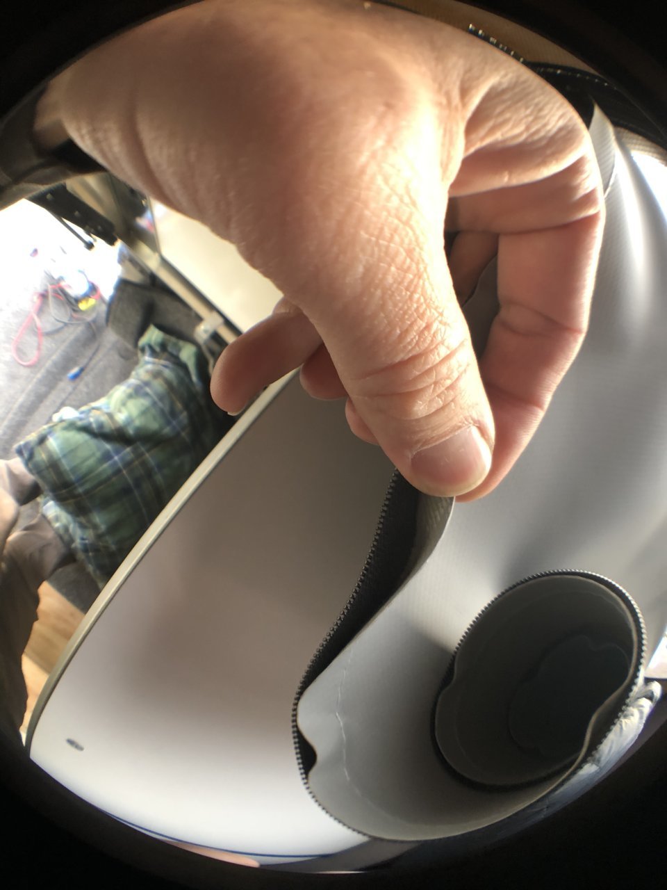

    We have been using the Drifter heavily since pickup in January. In fact, we have used it every weekend. There is something addictive about having a home you can take almost anywhere.
    Here is a list of hacks that we have found for making the rig more useable.

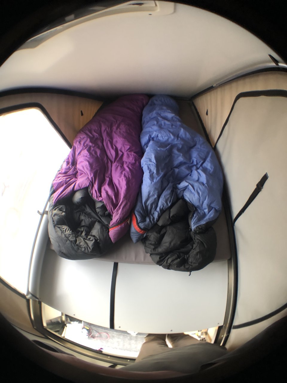

    1) Where to put the pillows. We have been using a zero deg down bag and a 15 deg bag for camping in the winter months. These fit nicely on the bed when the top is closed. However, we struggled to figure out where to put the down pillows. If you leave them at the head of the bed, the tent material has no where to go. We pulled the foam forward and put them at the foot of the bed but they were difficult to get to.
    What has worked well is to pull the bed plate toward the back, but push the mattress back. The pillows fit great here.
    2) Zipper Tent Fabric Pull.
    I initially had a difficult time moving the tent zippers without getting the fabric caught. I have the same problem with my sleeping bag where the fabric gets caught in the zipper. My solution has been to pull out when zipping. This seems to pull the zipper away from the fabric and keep the fabric from getting caught and works every time.
    3) Bed slide.
    We have found that is is often easier to push up the bed slide with your back from under the bed rather than pulling up on the black strap start the sliding process. It can sometimes be difficult to lift the bed with the strap.
    Also, I am lifting up the head of the bed when sliding, to reduce the scratching on the bottom of the bed when they slide over the the screen heads. I need to countersink them.

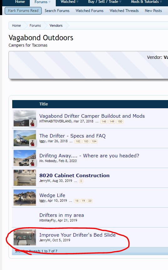

    @MapJunkie I've been doing the same thing with the pillows, works great. Way better than having them down at the foot of the bed...
    You should check out Jerry's thread on how to improve the bed slide in the main V.O. forum contents section. No more lifting of the panel, and no more scratching either - that's on my short list of improvements to make, will happen by the time the rest of my buildout is finished!

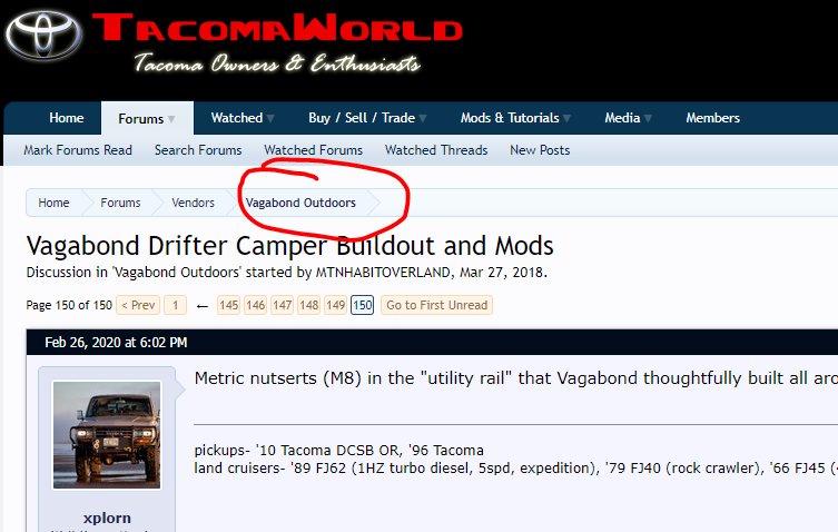

    Can you just link to the thread? I'm not sure what you're referring to and moving the extra bed panel back and forth is my only complaint so far.
    I have had some issues especially with pulling the bed platform back out from "hangout mode." Every third or fourth time I find that the platform either misses the side tracks and falls or the little rectangular plastic end caps get caught on the guide rails. I've super glued a few of the plastic caps in and that helps, but I've also destroyed a few of them by accident. Am I making sense?
    Speaking of this... @Overlanerd @Iggy @tyfoon11 where can I get more of those little rectangular plastic end caps that go in the open ends of the aluminium bed platform structure.

    Scroll to the top of this page, and click this link:
    Then, click this thread:

    When I close my Drifter I pull the platform back, push the mattress/bedding forward and put my pillow on the exposed platform just like @MapJunkie shows above. Works great.
    Regarding those zipper hang-ups, I had the same trouble. There is a lot of extra fabric extending past the zipper(the part @MapJunkie is holding in his fingers in the pic above) so I carefully trimmed it back with some sharp scissors. I cut it back just past the teeth, so the slider doesn't have anything to grab. Now the zippers slide easy.
