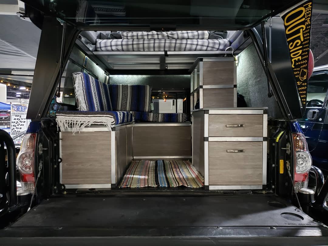

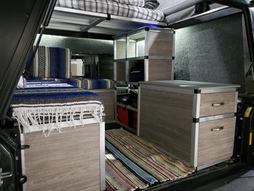

    I need to do something similar! Looks awesome. Where is your fridge, most likely in the back seat?

    Yeah fridge is in the back seat. Took up way too much space in the bed.

    That was the original design but the fridge just took up way too much space being the bed. So now it's in the back seat.

    Incredible build. What did you use for the panel material?

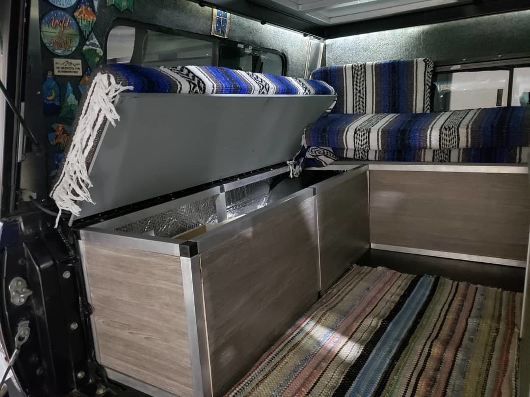

    I have also used our Drifter a lot in the wind and in high wind snow storms. We have a “hunker down mode” that keeps everything we need in side for nights like that. With the lock out bar I haven’t ever had a concern with high winds but it won’t change the sway factor.
    I built a slide in the back of our rig that holds an RTIC 45 cooler most of the time but it’s built around a smaller 35 Dometic CFX. The bench is good hight for sitting and our floor partition can be set up on the internal L track rails to give a full lower sleeping platform. I am not utilizing a lower plate however like most.

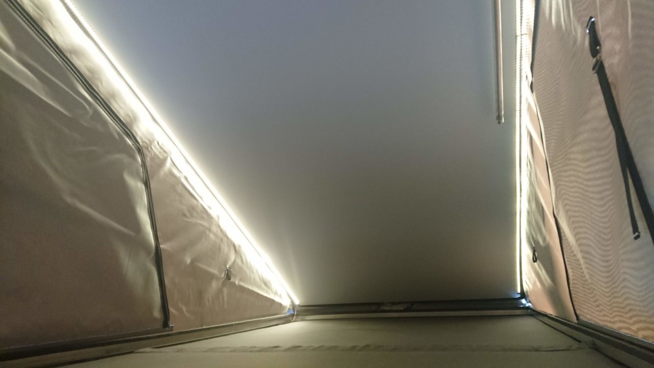

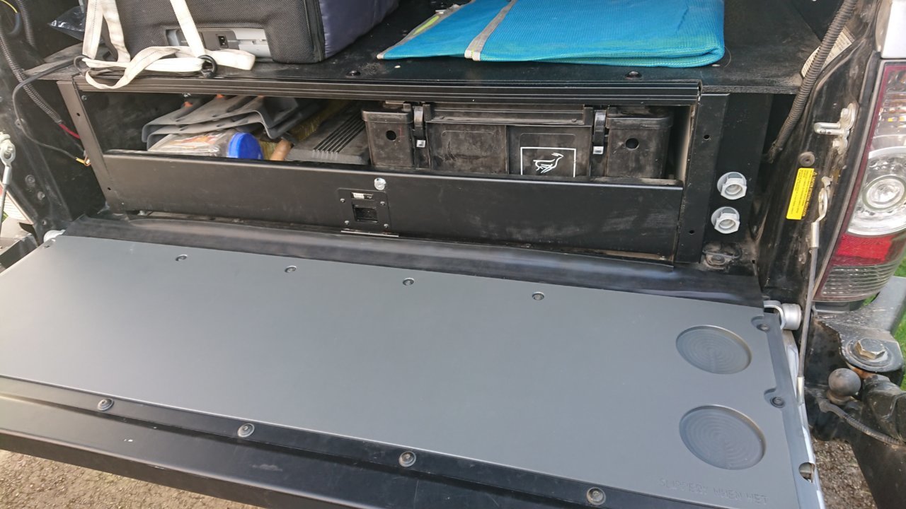

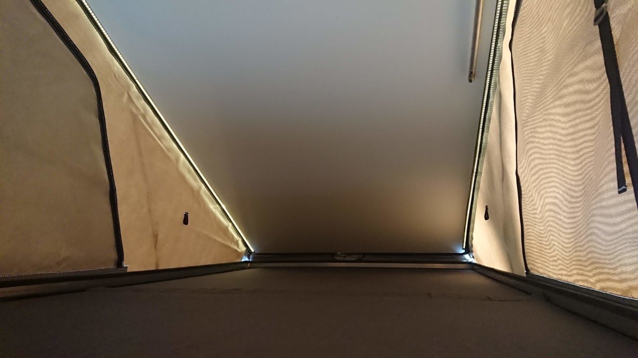

    Added led strip lighting to the ceiling. They are warm white and on a dimmer switch. I found a roll of 1/2" x 30yd foam double-sided mount tape on Amazon for attachment. It took a bit over 6m of lights to do 3 sides of the roof, but you could get away with a single 5m strip easily. They pull around 1A or 12W on wide open throttle.

    Also added a Mountain Hatch tailgate surface, and a rubber strip along the tailgate hinge line to help keep dust out.

    1/4" plywood. Then I just stuck some decorative "wood" vinyl decals on those pieces. They have all kinds of wood variations on Amazon.

    Curious what LED strips you used. That dimmer will be so worth it.

    Mine are marked "LC-242" but I don't think it's a valid reference... search ebay for something like "led strip light warm white 5m 300" (300 leds/5m, or 60/m is what I'd look for) It should return results <$10.
    Ah, Amazon actually has them (they used to be $$$ there)
    https://www.amazon.com/Non-Waterproof-Flexible-Kitchen-Included-Daylight/dp/B00JQV6NNC
    The dimmer is great. I use them in the house under kitchen cabinets and on moulding near ceilings, and adjustability rules. The type of dimmer I used is like this
    amazon.com/Maxmoral-Accessories-Brightness-Adjustable-Controller/dp/B07KW4NCCJ
    so you would also need barrel connectors for wire like
    https://www.amazon.com/DAYKIT-Female-2-1x5-5MM-Adapter-Connector/dp/B01J1WZENK
    There is also an RF remote that works well.
    https://www.amazon.com/Updated-Controller-Wireless-Control-Dimmable/dp/B01M7TGZ9B/ref=sr_1_13
