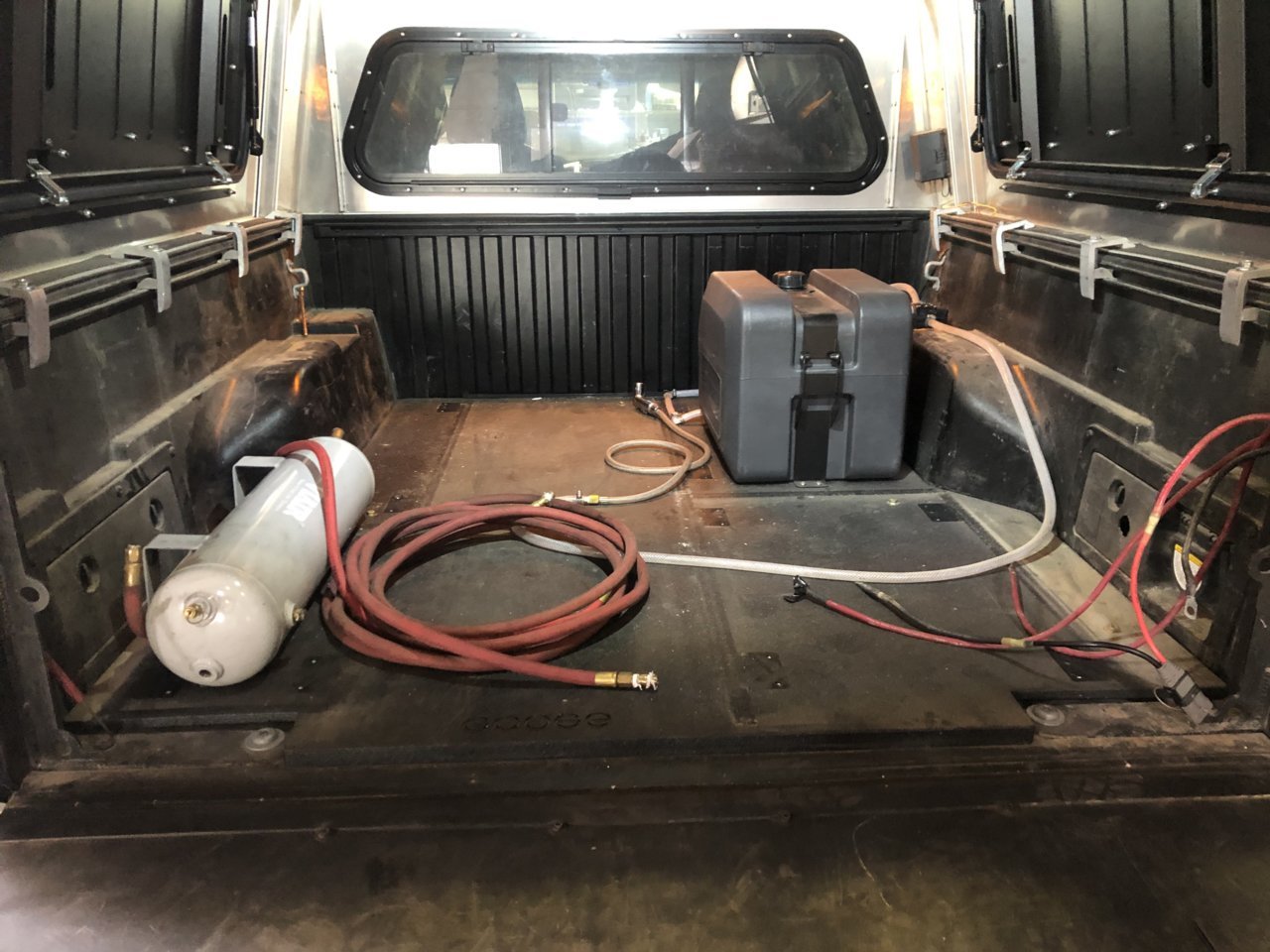

    I am working on a little build for the camper and am wondering what your water solution looks like. I would to see a photo of what you have rigged up.
    I plan to have two bench seats and have some room for a 7-10gal tank. I am looking to build something similar to Phil’s setup. He has a hose they can reach to tue tailgate and a sprayer. I am not sure if he has an RV pump or uses air pressure.

    I believe I did a youboob video of it a bit ago.
    Here: https://youtu.be/vNqHYWolOZ8
    In the video it shows my old water storage solution. I have since upgraded to a Frontrunner tank with a mounting system that integrates with preexisting mounting positions by Goose Gear. The hose is the same though.

    I decided to build mine around using 2 of the 5gal LCI/Scepter jugs plumbed through an RV pump, so they're still removable for easy filling, cleaning, etc.
    Obviously not quite as space efficient as a cubed tank, but I like it this way.
    The plumbing runs to a quick disconnect back near the tailgate, and then I usually just have a ~20" flexible Loc-Line off that. When needed, I just swap in a longer hose with a showerhead, or whatever.
    If interested beyond that, I can get some pics.

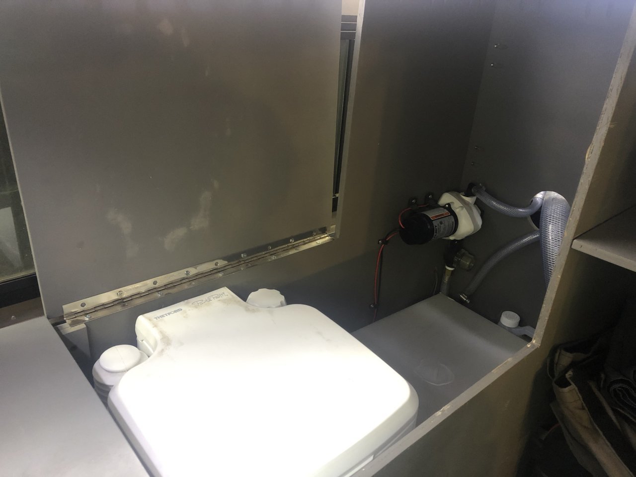

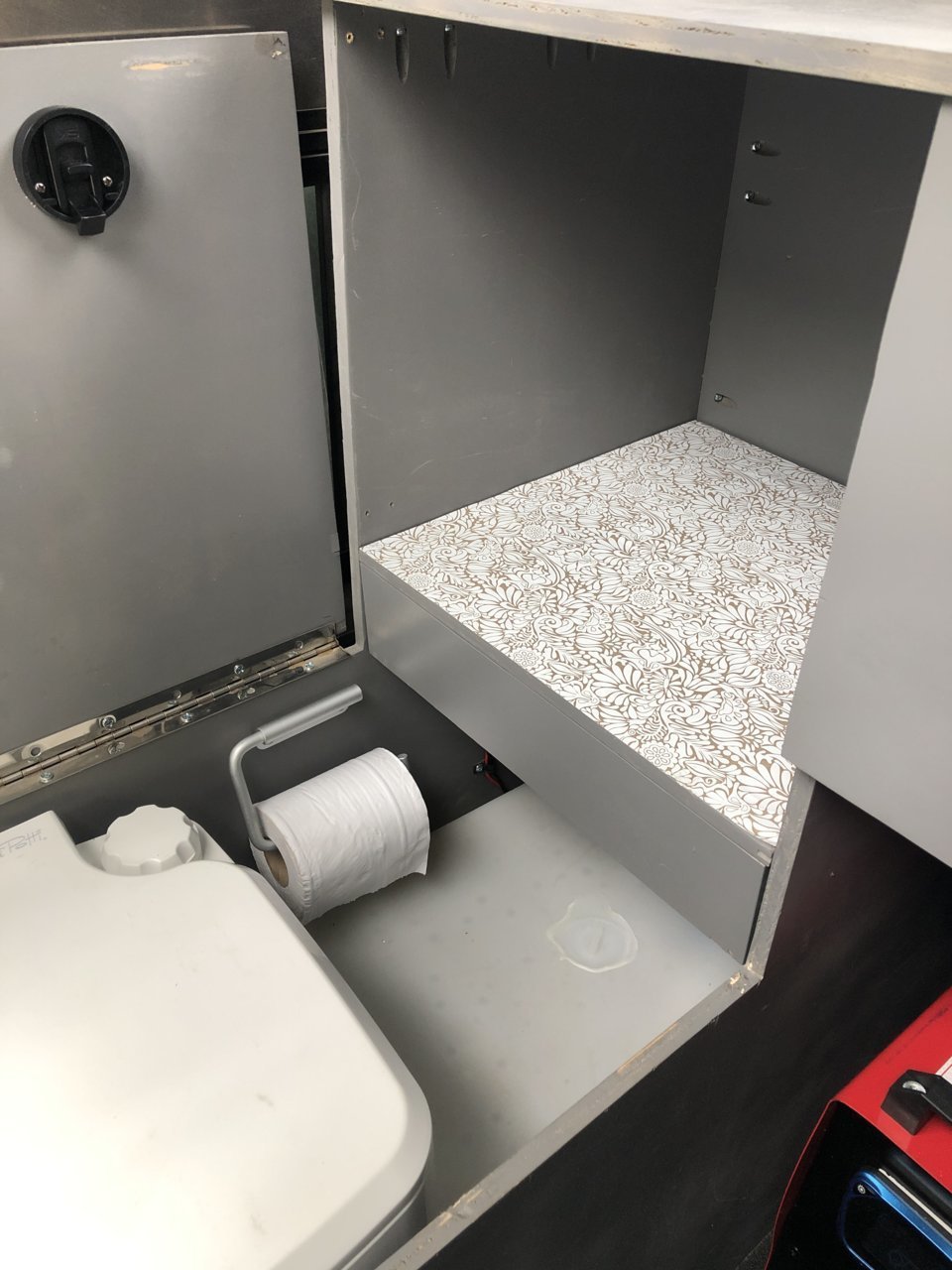

    I have a 10 gal water tank, water pump, and quick connect on the passenger wall for a shower. Its also how I do dishes.
    Removable shelf hides it but still allows me to access it.
    External shower

    Follow up to this. I took a picture of the Frontrunner water tank in an empty bed...
    MapJunkie likes this.

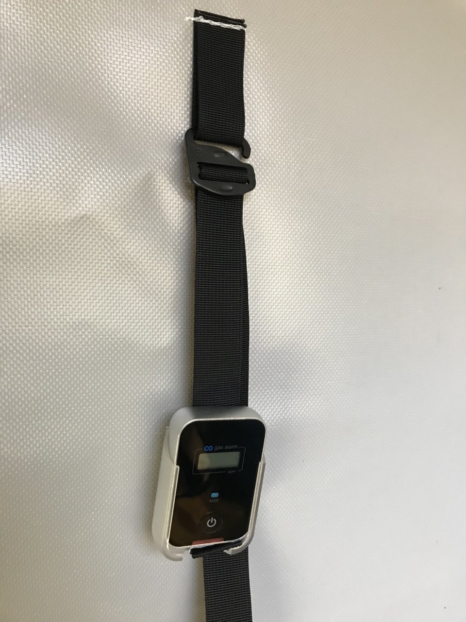

    We Need to Talk about CO
    While it is convenient to ignore Carbon Monoxide in the Drifter, if you burn a fuel source in your rig, you shouldn’t. On a recent camping trip to 6,000 feet in February, we decided to boil some water on a camp stove in the Drifter since it was below 20. We opened the tailgate and fired up the stove. Almost immediately, my wife got a headache and was a little dizzy. We shut off the stove and cooked outside. It took 12 hours for the effects to wear off.
    Given these issues, we got a CO detector made for aircraft by Forensics Detector. The unit is small and alerts you to lower levels of CO than most. I placed it at eye-level by attaching it to the strap on the Drifter window.
    What were the results? Mr Buddy Heater has the lowest concentrations (10ppm @2min) with everything closed up. After some experimentation, we found we could keep the levels at zero simply by placing the heater against the tailgate and opening the vent. The airflow from all the cracks in the tailgate give the unit enough air. You could open the tailgate and inch as well. This setup works well because a heater isn’t any good with all the windows open.
    What about the Cook Partner Stove? It generated >50 ppm CO almost immediately with the vent open and the tailgate open 1 in. This is the level at which the alarm sounds loudly. We were able to keep the alarms at bay by running the fan on low. This is a reasonable way to cook inside. You could also open the rear window all the way for an extra margin of safety.
    So, fuels sources burning in a small space generate CO. It is a fact of life. At least some minor accommodations will keep the levels in a safe zone (at zero). I would highly recommend a portable CO detector such as the one by Forensics ($99) if you plan to cook or heat inside.
    https://www.amazon.com/Aircraft-Mon...de&qid=1585962880&sprefix=forensic+det&sr=8-3

    Question for you. Why did you attach it so high? I have read different comments on this forum that folks should mount the detector at the lowest level because of gas densities or something like that. Your thoughts?
