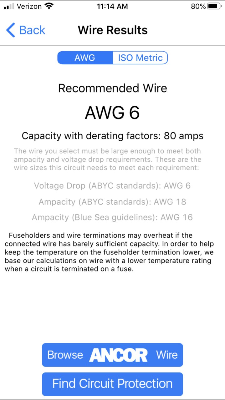

    I plan to run 2 160w. panels from the roof. Best case, I could have upwards of 18 amps flowing from the roof per Renogy specs. The wire run is 20 feet for me as my solar charger is passenger and the glands are driver-side per Phil’s recommendation. My solar charger is in the bench seat, adding some to the run. I want to minimize the voltage losses from the roof to the solar charger, so I am building for a 2% loss. Lots of people lose power in their wire run and wonder why they aren’t getting the wattage they expect.
    Putting all that into the Blue Sea app gives me 6 AWG. I probably could get away with 8AWG, but this seemed like an inexpensive way to maximize my solar power.

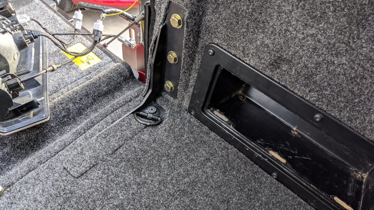

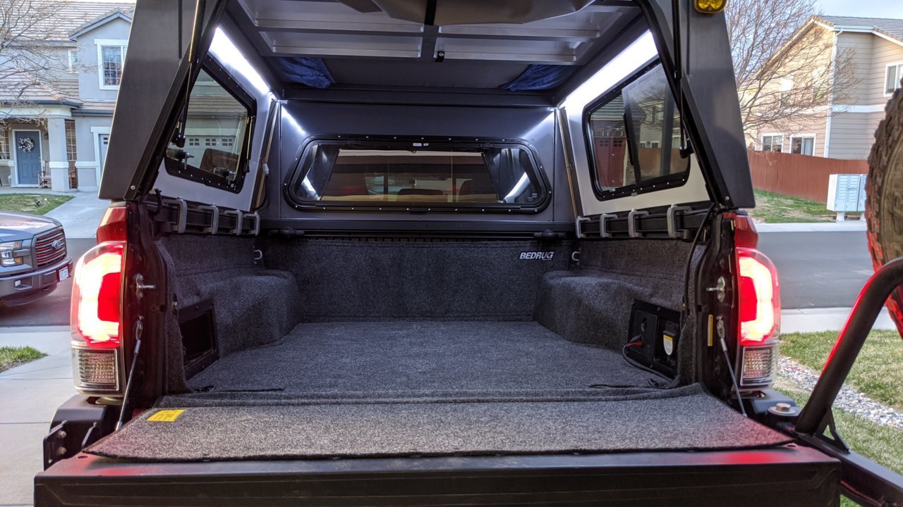

    Added the bedrug before installing the fridge slide (holes already drilled). Had to take off the bed stiffeners, clean and reinstall but at the end of the day it's a highly worth while addition for the knees and some insulation
