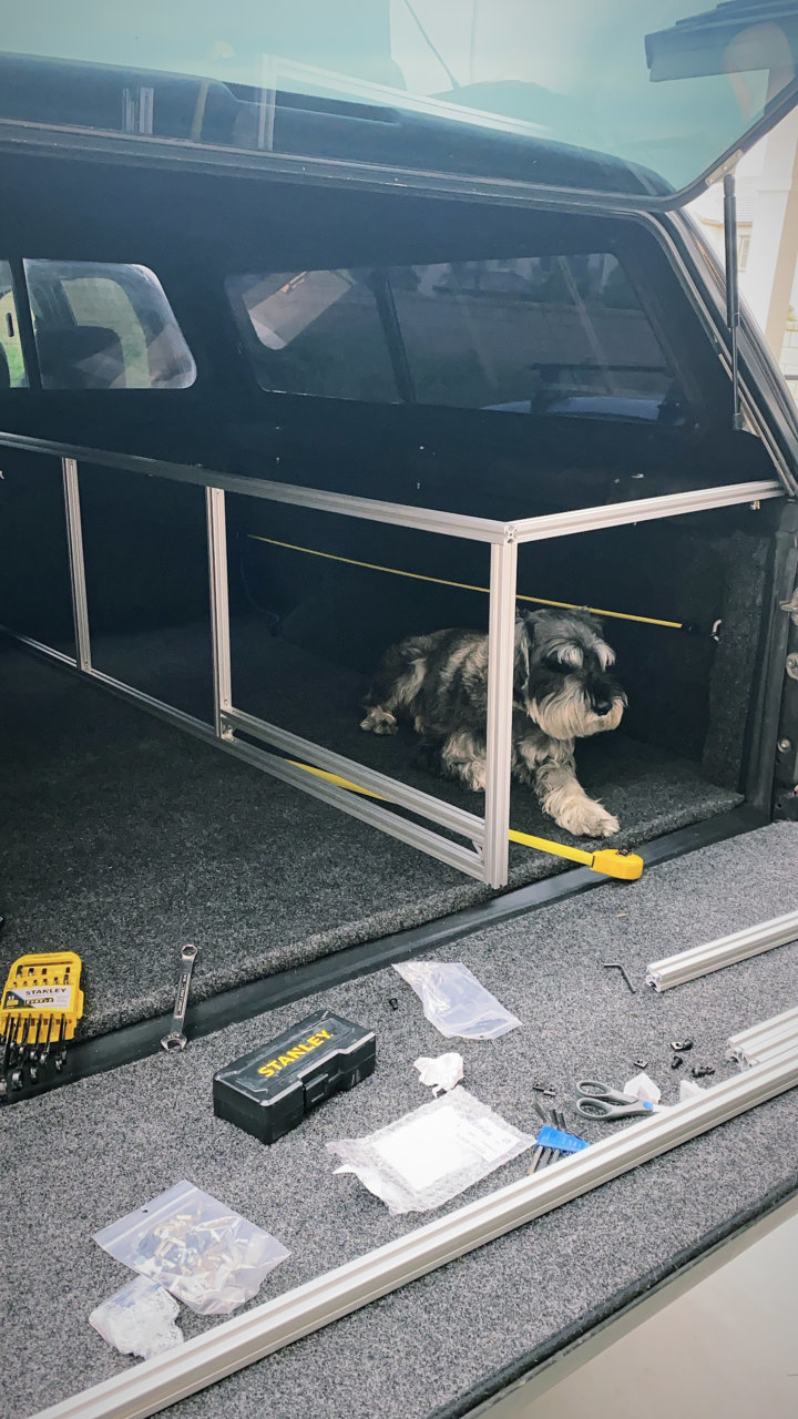

    Got inspiration from @alldownhill for my bed build for my 2006 Tundra.
    Got the frame part done, just have to cut some corners and make minor revisions.71B43342-605D-4376-B42F-384F51FB3960.jpg

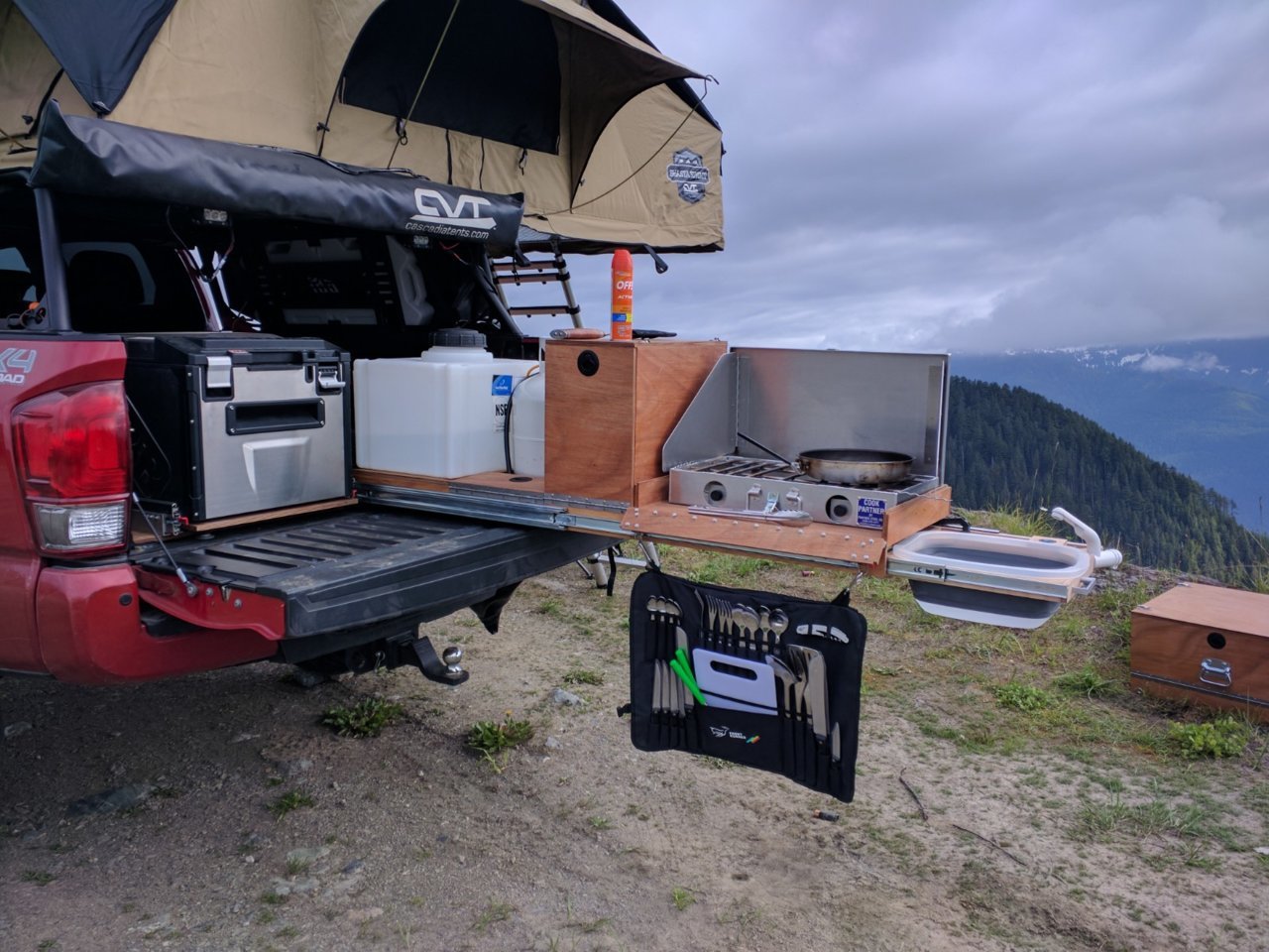

    Planning to make a pull out kitchen like this underneath the bench with a cook partner stove + sink + dometic CFX3 55im
    a total of 50.3 INCHES. I have a 74 inch bed so I can still fit more stuff. Haven't decided what else to put back there but I wouldnt want to waste it on a big water tank.
    Instead of this water tank ^
    I was thinking of doing this PVC type grey water storage to completely utilize the area above the wheel well. Has anyone done a type of water storage like this?

    I’ll have to dig some up. I ordered some 500# drawer slides online and then build the frame out of aluminum angle and bar, all bolted together

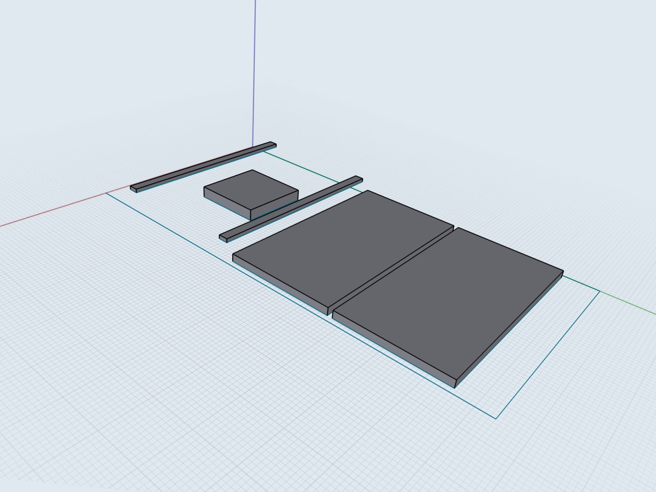

    Wow! You have an appetite for power. I am planning for a 320w design to allow me to work nomadically with a laptop for longer periods of time.
    I just installed my first 160w solar panel in the L-track. My plan calls for two total. With the factory fan, I can only fit two. See design below. My plan is to put a Front Runner roof rack above the fan area, so the the space will get used.
    Since the L-track is 96”, you can only fit 3x Renogy 160w panels (without fan) as they are 26” wide. That would also allow for a bit of space between them, which improves airflow and access to MC4 connectors. With the L-track, I also need around 4” between solar panels for my bracket.
    DM me if anyone is interested in a STEP file of this design.
