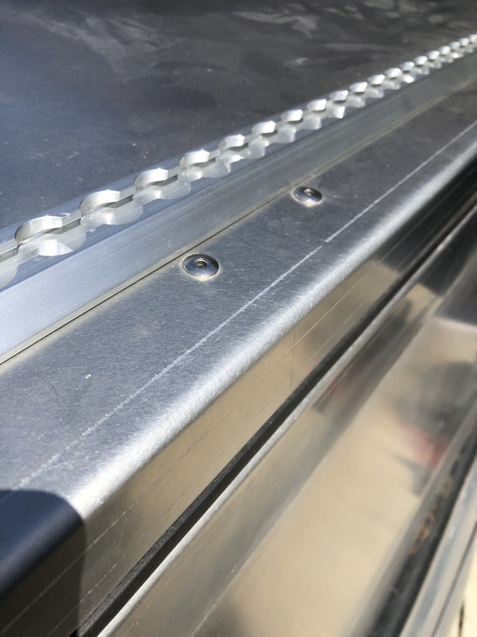

    Can anyone with L-Track installed advise if the mounting points are in the gutter area of the drifter top? Or in the sleeping area? Looking to install L track to mount solar but may just go flexible panels if I would need to drill into the sleeping space

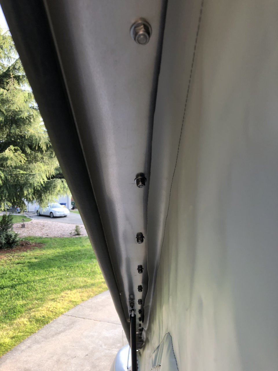

    I installed L track myself, but I imagine they’re installed in a similar spot because of the rivets from the struts
    Underside

    Yeah, definitely outside the sleeping space. They designed it that way.
    I installed my own as well, but I used a drill to clearance the underside of the L track so that I could install it over the top of the strut rivets.
