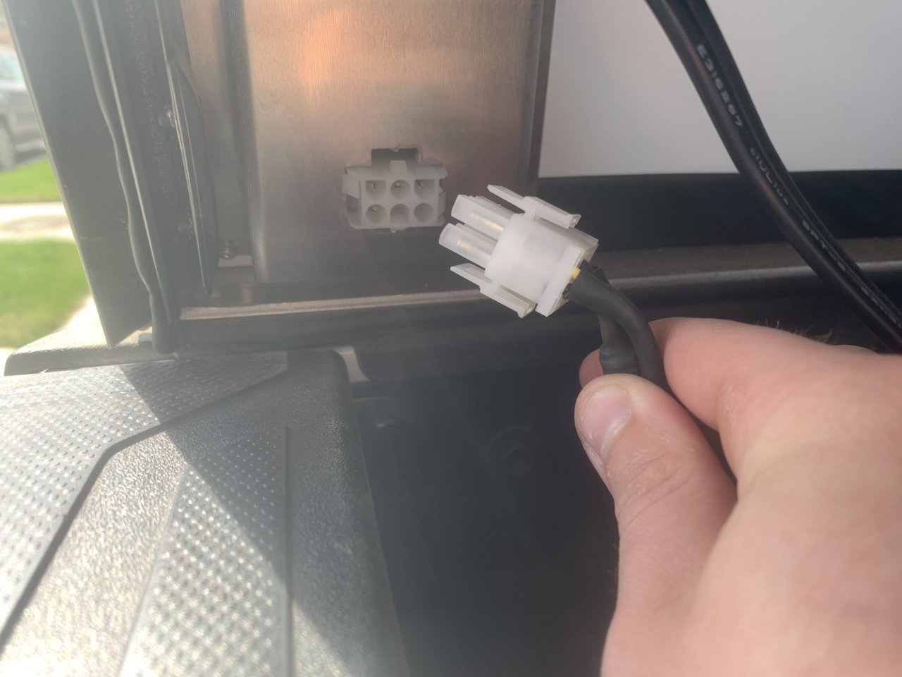

    Has anyone wired a connector to plug a drifter into a goal zero for power? I’m a 12/24v noob so trying to figure out if this is possible. Would be a 1000 model.

    I run my Drifter off a Yeti 400 so I know its possible. The boys gave me some pigtail thing that plugs into the Goal but I am not sure what it is. I can take a pic later this evening if it helps or perhaps @tyfoon11 knows

    Yeti 400 with a pigtail connector I made tto the drifter. Also still have the Tacoma to Drifter connector taped there in case I want to run it off the underhood battery.
    I have a 100W panel that keeps a Yeti 400 lead acid topped off year round running lights, fan, jerry can water pump and Dometc CFX35. Its such an easy, simple setup that I'm shocked more people don't do it. Cheap, plug and play, and modular compared to a dual battery.

    I would use one of the 6mm barrel ports or the anderson port to wire it to the drifter.
    This would work. It doesn't need to be a GZ part but it's only $7. Alternatively, you could wire your own pigtail with a power pole connector or 6mm barrel connector. Just bring it with you in the length you need and I'm sure VO would wire it to the switch panel. You are limited to 10A over the built in 12v ports which should be enough for the lighting and fan.

    Thank you a ton! I think I could even just splice it and re-wire the quick disconnect connector that VO provided. I have no clue what the name is though, maybe someone can identify it? I honestly would love to just buy a fresh one and assemble it with the 6mm you provided
