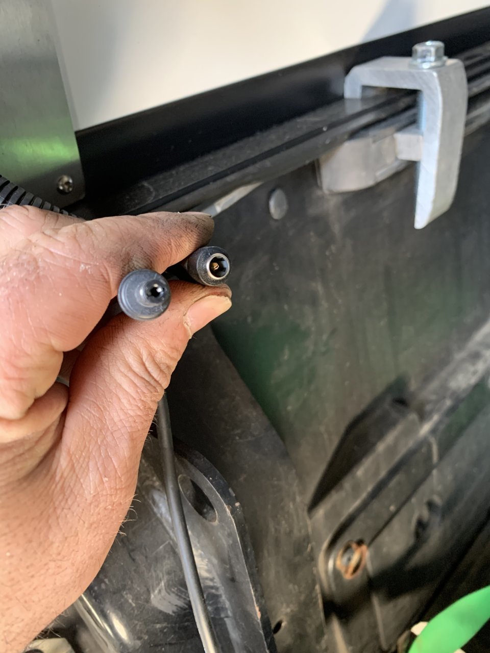

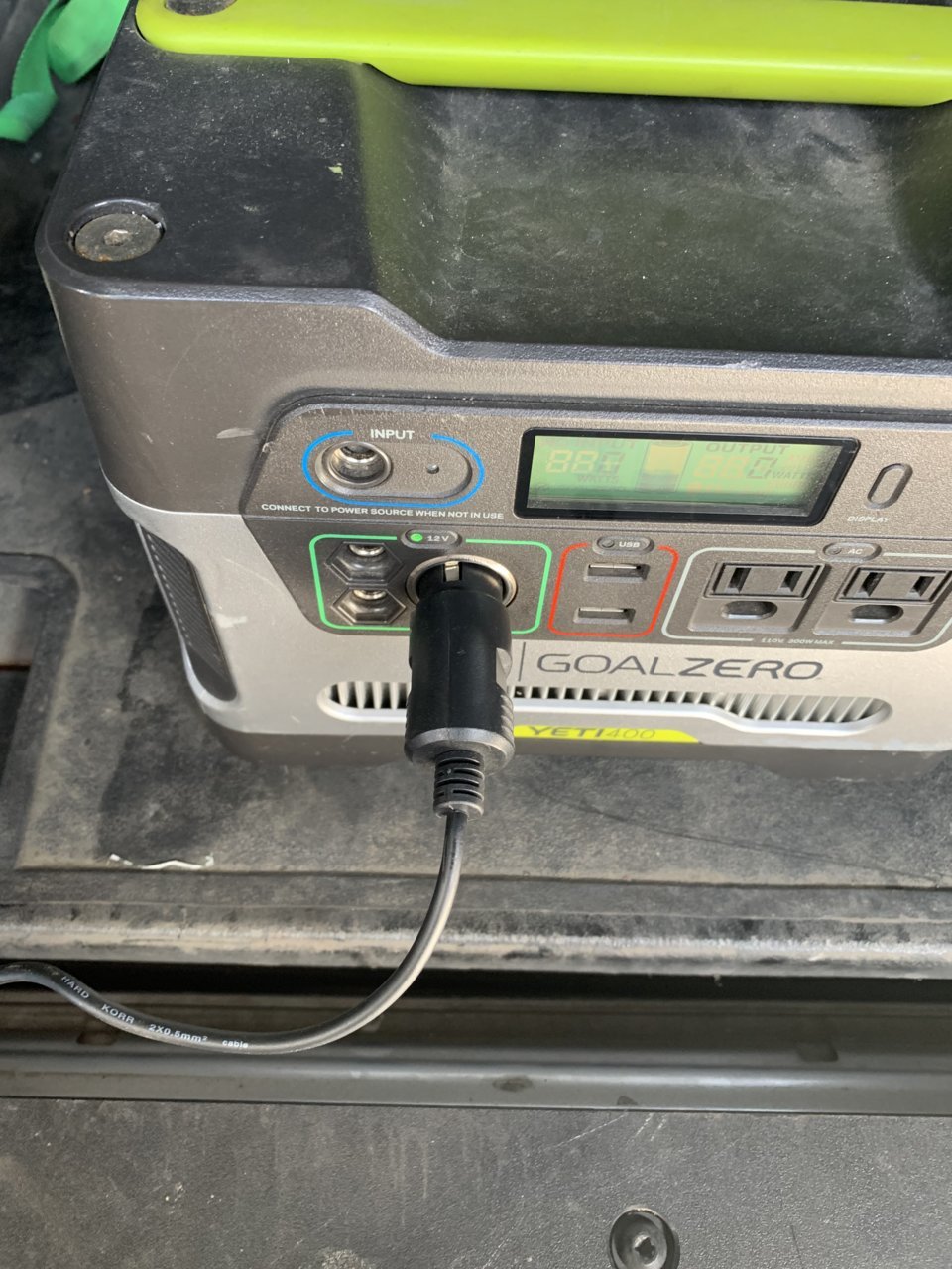

    Here are some pictures of the pigtails that go to my Goal Zero. Hope this helps.

    ^This is great news!! Just picked up a Yeti for cheap and everything you listed is on my future buy list. Can you post how you situated your cfx35?

    My bed is bare metal, no spray-on bedliner or plastic liner (anymore).
    The only "prep" I did was change out the normal clamps that Vagabond uses on the 1st gens with a smaller ones (GCI G-30) that needs some material removed to work with our beds. You can see the "mod" here:
    https://www.instagram.com/p/B3zx2oQloXa/

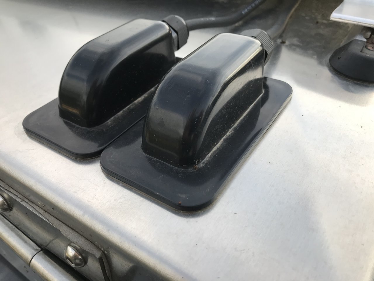

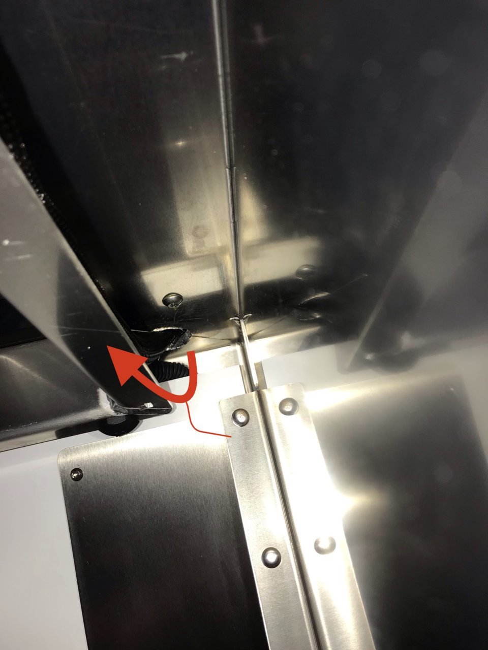

    The solar pre-wire isn’t fancy, but I do think it is clean. It consists of a cable of your specs (I am guessing 10awg is standard, although I did 6) run from the roof to the corner of the Drifter. You are responsible for everything on either side. VO punches through the roof and installs a gland to keep the water out. You could do this yourself, but I wanted Phil to cut all the holes in the roof, cause I don’t want leaks.
    I can post some pictures after the weekend, when I have the camper out.

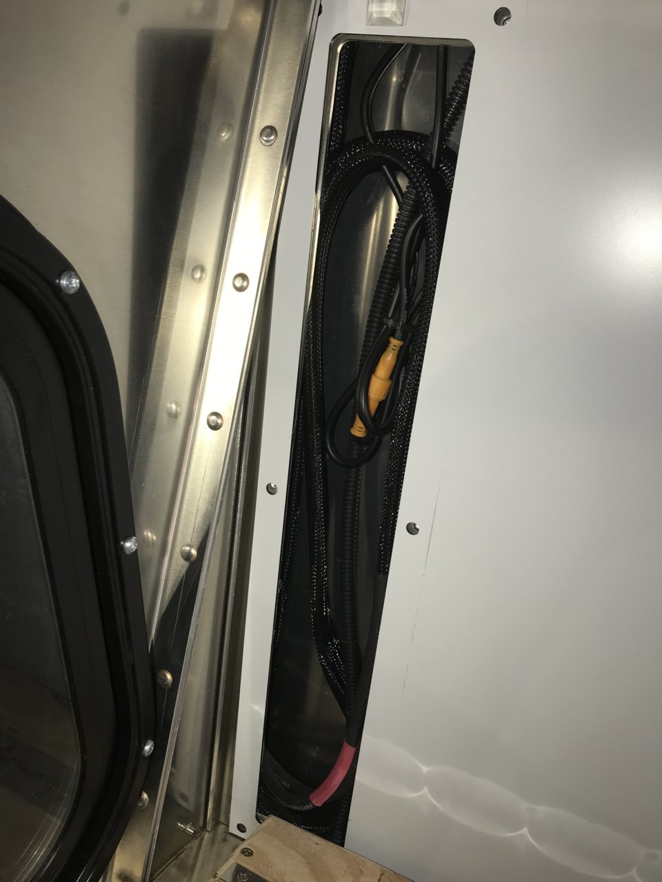

    The wiring installed by VO is also underneath the insulation panel, which you would have to cut through if you did it yourself.

    Not really, you can drop in right down the corner panel and run it between corner panels in the gutter. No need to cut anything whatsoever. Even prewired they run it through the gutter and into the corner panels.

    You can easily cut a small hole outside of the sleeping area (gutter area) to drop under the roof, run wire in the corner of the tent (hole is already there) and drop straight down to the wiring gutter. No risk of leaks and no need to mess with insulation at all.

    Agreed. VO doesn’t appear to run behind the insulation.

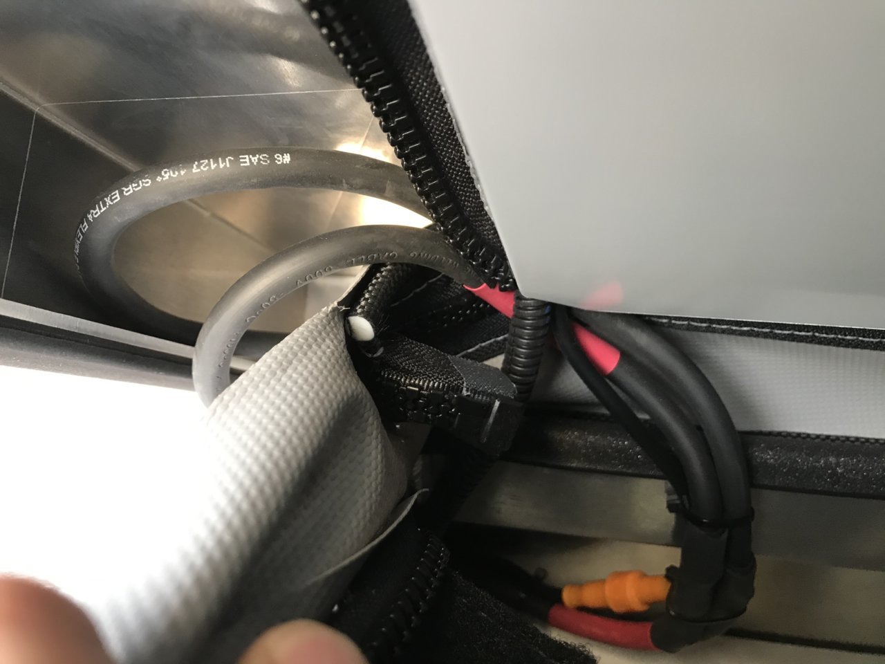

    Here is the gland. I have two because of my 6awg cable.
    Punch through the “eaves”.
    Down through the interior.
    Through the floor, and along the cable management channel.
    Terminate in the corner.
    Ok, I could have done this myself, but I didn’t know the correct way to do it at the time.

    My mistake. Thanks for posting so many good images, @MapJunkie - that's the first time I have seen the details. A while ago, the photo I saw made it seem like it was run behind the panels.

    The claims of VO's pre-wiring running behind panels might be referring to the bed/floor panel in the overhang.
    The fan (and I assume solar) wiring runs from one of the corner electrical panels, underneath the bed/floor panel in the overhang portion to get up to the front corner of the overhang, where it runs up into the lid section.
    At least, this is how they did it in the first batch.
    When I added my own solar wiring, I was able to unscrew the bed/floor panel in the overhang to run it the same way, but it is kind of a pain to do.
