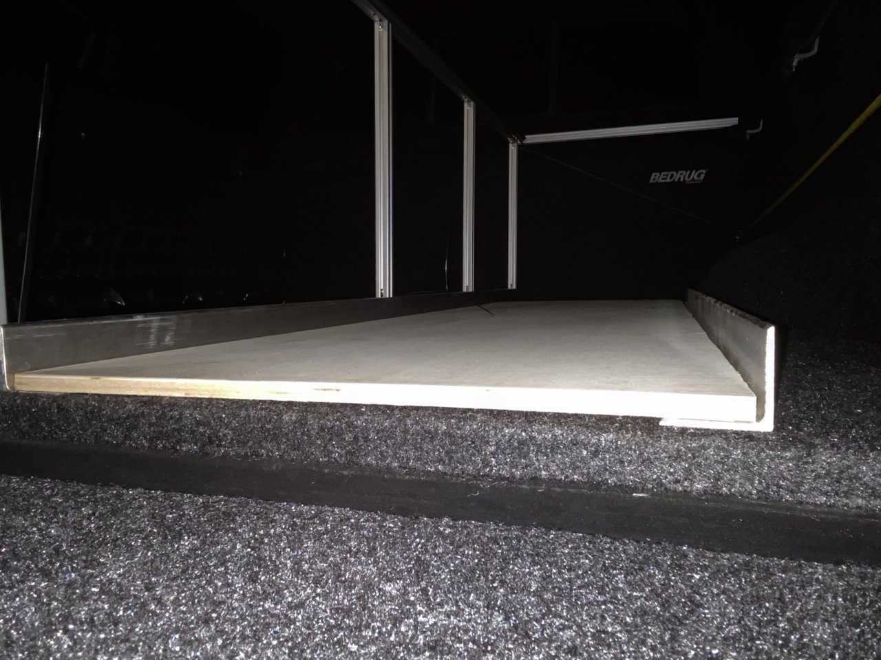

    Anyone have any idea how much this 1/8” thick angled aluminum can hold?
    Mine is 60” long and 1/8”thick 2x2 angled aluminum.
    I plan to put a Dometic CFX 55 along with a stove, some food storage with pans along this 60” platform that will be supported by the angled aluminum. Angled aluminum will be attached to the 80/20 so it will be suspended off the ground by an inch.
    Wondering if it will be strong enough when off-roading and stuff
  17. May 4, 2020 at 9:58 PM
    #3317
    snwbrdr852
    snwbrdr852 Well-Known Member
    Apr 1, 2012
    #76081
    479
    Utah
    '17 DCSB OR V6 AT 4WD
    I'm no engineer, but I'd definitely be apprehensive about that setup if it was me.
    Though somebody else will certainly jump in with a more definitive answer.
  18. May 4, 2020 at 10:00 PM
    #3318
    migx333
    migx333 Well-Known Member
    Jun 18, 2019
    #296666
    249
    Exactly why Im worried as well.
    I was thinking of doing the angle steel 1/8" thick or the 1/4" thick aluminum
    But I don't want to put this to waste if its enough to hold up my slide build
  19. May 4, 2020 at 10:15 PM
    #3319
    snwbrdr852
    Apr 1, 2012
    #76081
    479
    Utah
    ...On second thought, I assume you'll be using some really heavy duty 60" drawer slides, right?
    In that case, it's those that will be taking all that leverage/weight. So it would be more a question of the actual arrangement of the "drawer" structure, and the attachment of the slides to the angle aluminum.
    If the config is basically what you're showing in that pic, then personally, I'd prefer to have the two pieces of angle attached solidly enough to each other that they could be considered one piece (like ideally with multiple cross pieces of aluminum welded to each of the side angle pieces, including one for the full 2" height to cap off the angle at each end, if possible).
    ...But again, don't take my word. This is just how I'd be thinking about it if it was me.
  20. May 5, 2020 at 5:14 AM
    #3320
    alldownhill
    alldownhill Well-Known Member
    Sep 20, 2018
    #266862
    163
    I think the angle aluminum will be plenty strong. How you fasten the drawer/drawer slides will likely be much weaker than the drawer platform itself.
