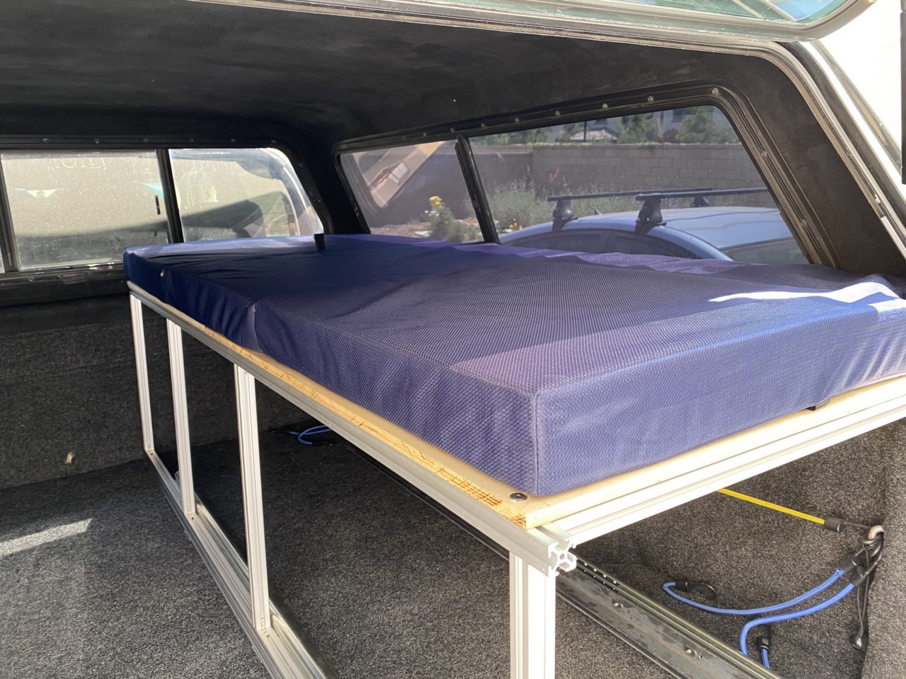

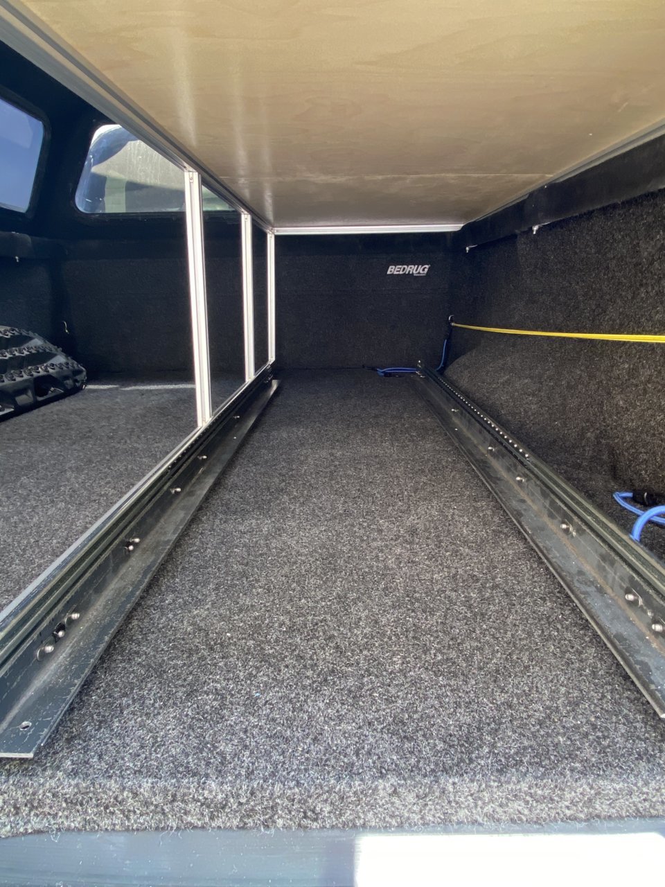

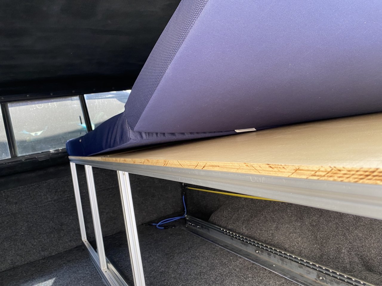

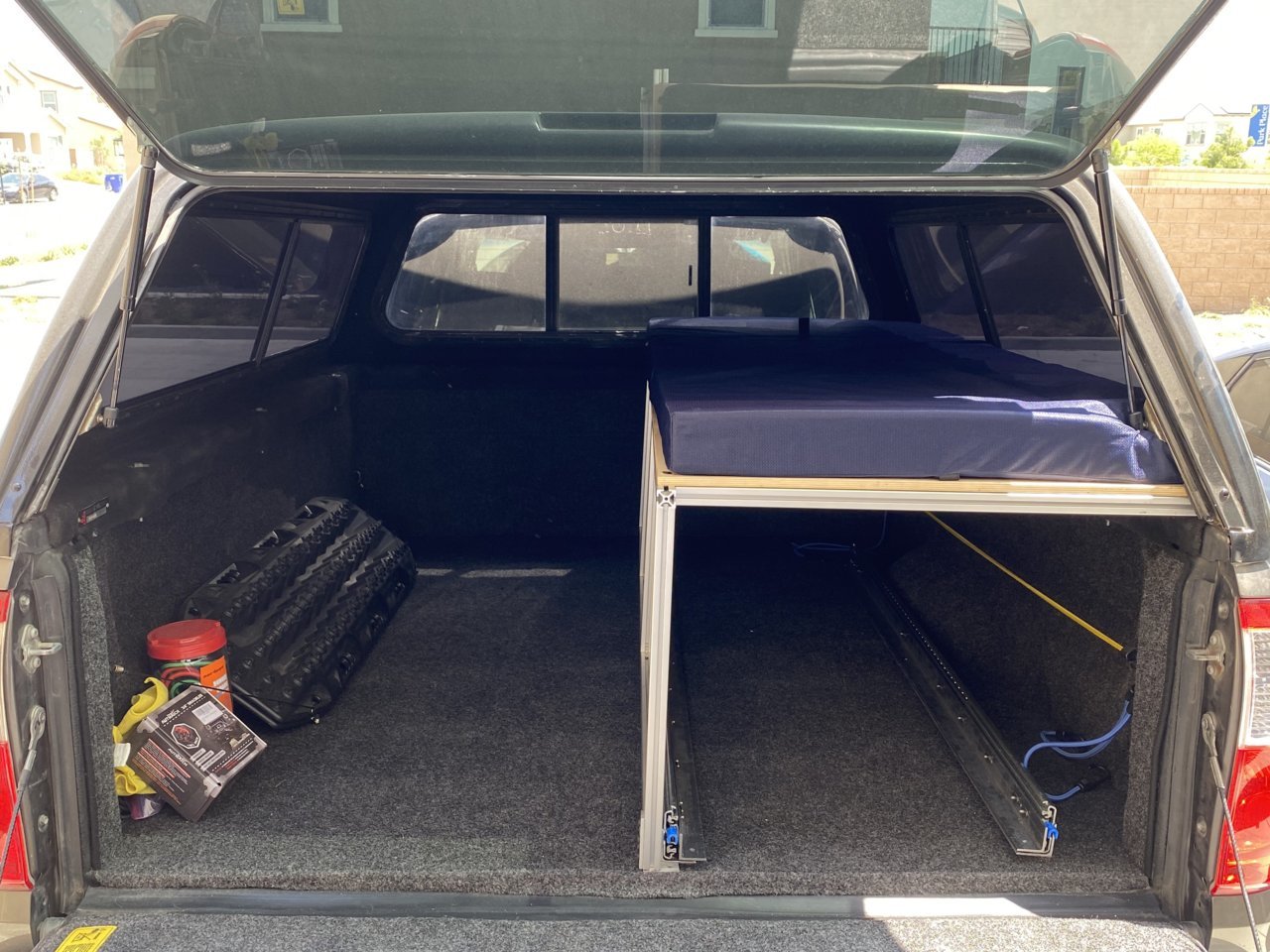

    Phase 1 is done, next is making the fridge slide with stove,pantry & sink.
    Back up sleeping platform for an extra person/stealth camping when the vagabond arrives.
    Platform:
    Used 1"x1" 8020 extrusion and 1/2" baltic birch plywood for the platform
    Cheap $35 mattress from Amazon but surprisingly comfortable

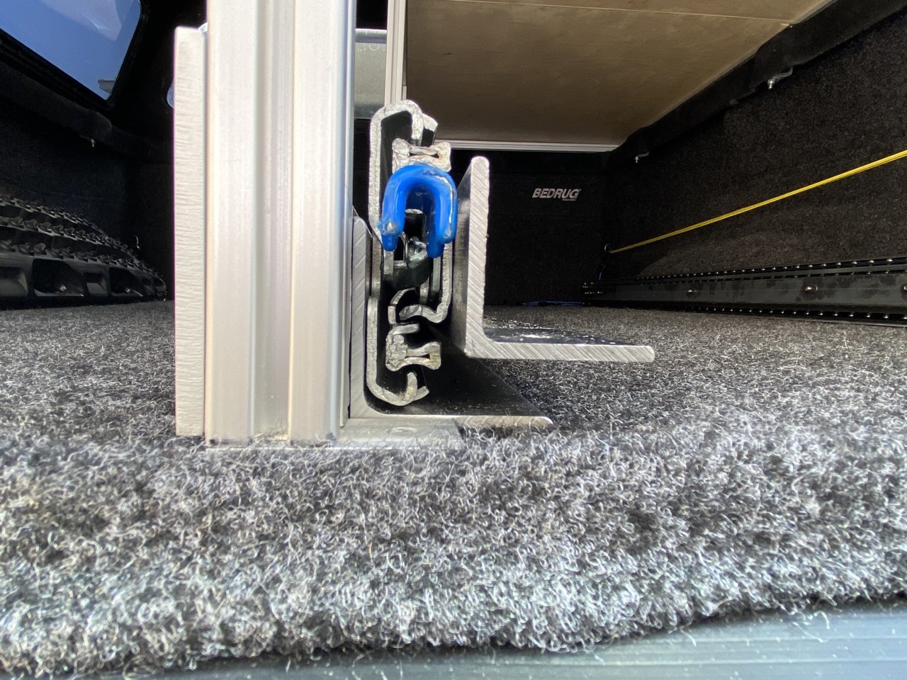

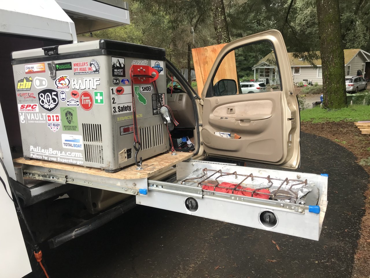

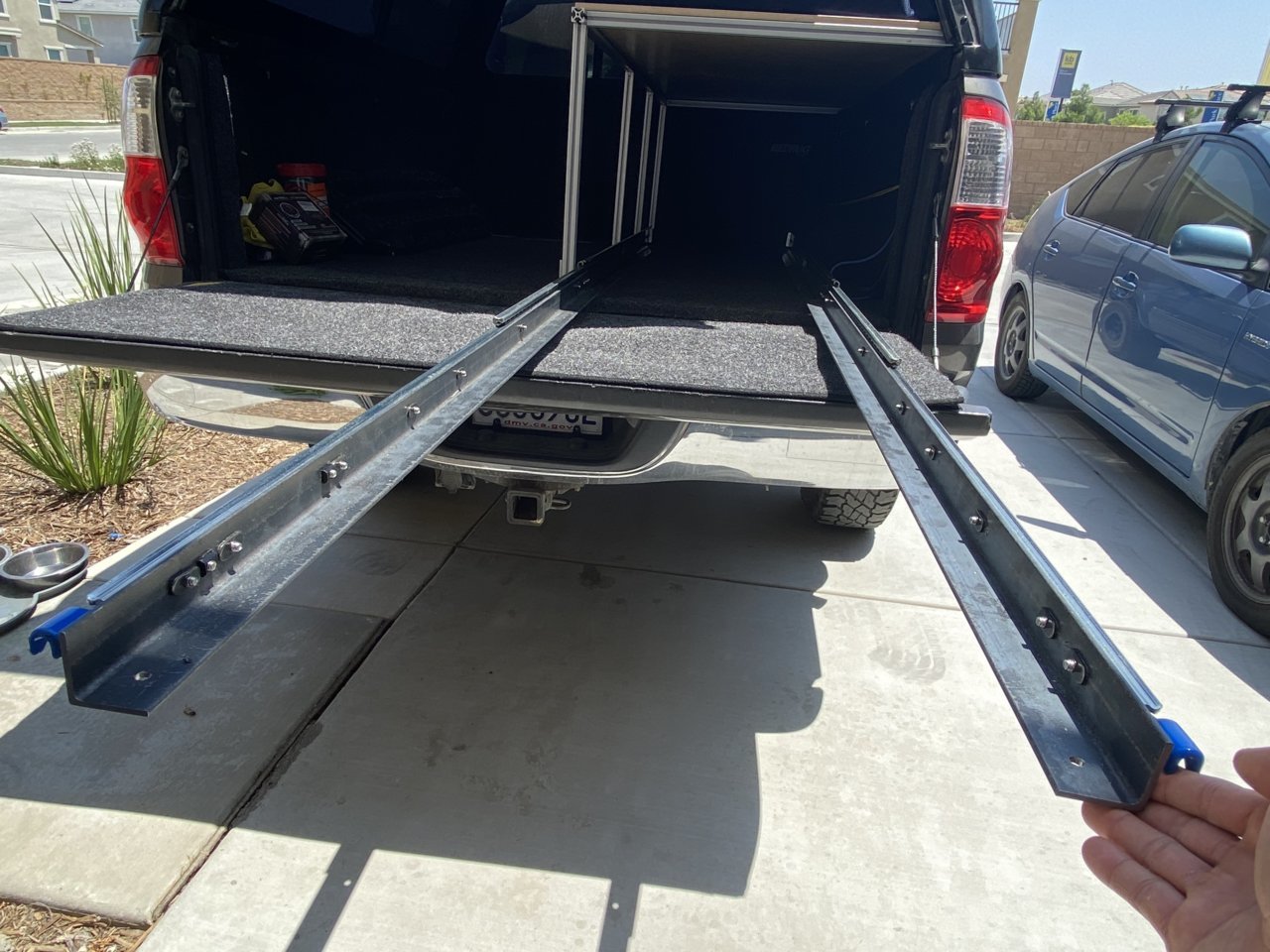

    Kitchen Slide:
    (5ft.) 2"x2" aluminum angle for the base
    60" lockable drawer slide to rest ontop
    1.5"x1.5" steel angle for the base of the kitchen slide.
  8. May 9, 2020 at 3:20 PM

    Looks awesome! I’m going to be making something very similar. I’ll be attaching my 8020 to a DIY Goose Gear style wooden bed baseplate.
    Is the 2x2 L aluminum necessary?
    Can you share links to the drawer slides?
    Still on the fence on buying a fridge slide or making one.
    Happy Heathen likes this.
  10. May 10, 2020 at 2:37 PM
    #3350
    migx333
    migx333 Well-Known Member
    Jun 18, 2019
    #296666
    249
    Ive offroaded with mine and its a 1"x1" extrusion and its held up pretty well. I think the 1x1 should be sturdy enough.
    I would say build your own if you're trying to include something else on the slide, like a stove / pantry / sink.
    But if its just a fridge youre putting on there, might as well just buy the slide. Its still a lot of work to drill the perfect holes and piece everything together yourself.
    drawer slide: https://www.ovisonline.com/60-Heavy...PHxoegbajEnAIDP1Ksd87qxGDzgB0KvcaAuGDEALw_wcB
    but these are 60" slides, so its the entire bed of the truck

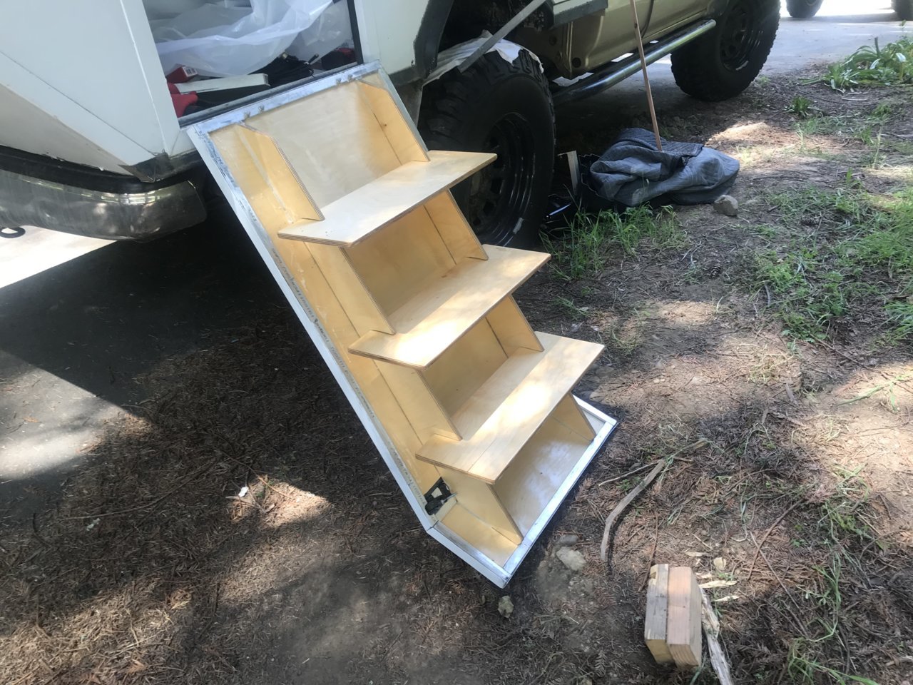

    For sure!
    I’m going to replace that OSB all together with some of this super nice 1/2” Latvian birch plywood I have and cover it in clear epoxy.
    Like my steps below.

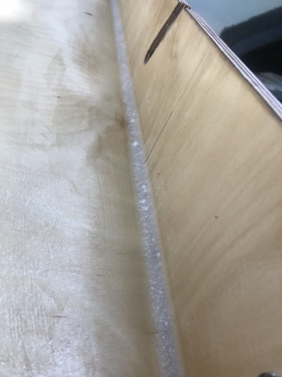

    I think this picture was taken with just the sealing coat on. I was going to wrap the stairs in fiberglass and epoxy but I don’t think it’s necessary. They’re plenty strong as is.
    I did thicken epoxy for filets on the right angles. Also the uprights rest in 1/8” deep dados.
