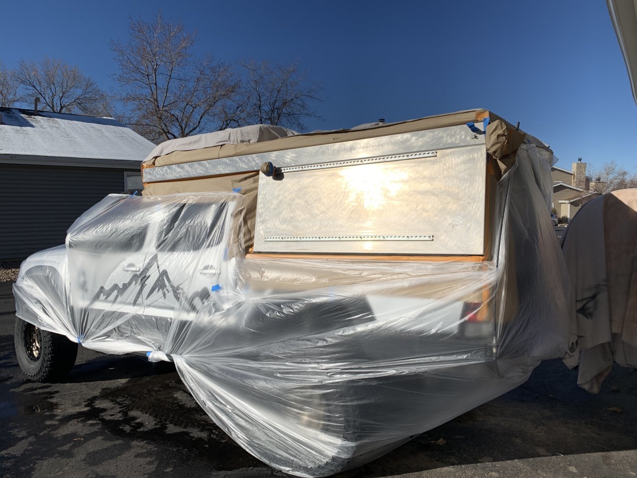

    Yo! I painted the sides and left the lid. I sanded it, used acetone to clean it up. Spent a lot of time masking everything off, then sprayed it with Rustoleum Aluminum Primer. Did a couple coats of that, let it dry and then used about 8 cans of Rustoleum Bed liner on it. Thats what I use on all of my armor/hood/roof so all of the black on my truck matches texture haha.

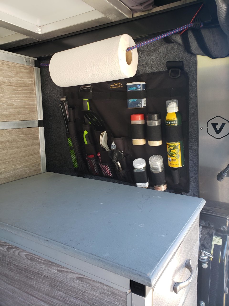

    I can't comment on how @cwhet10 did it, but I glued some indoor/outdoor carpet to 1" foam insulation using 3M spray adhesive. Then attached the carpeted insulation to the wall of the Drifter with some heavy duty velcro. It works really nicely for attaching things to the wall with some velcro strips...
    vqgO86j4jVZr-y3mISvY4sn3lDJMe0vVErx4Ikug_ff42be938e6332be1a36a69e83f030b70c204e4a.jpg
    I planning to get some little organizers to store small items and velcro those to the walls as well.
