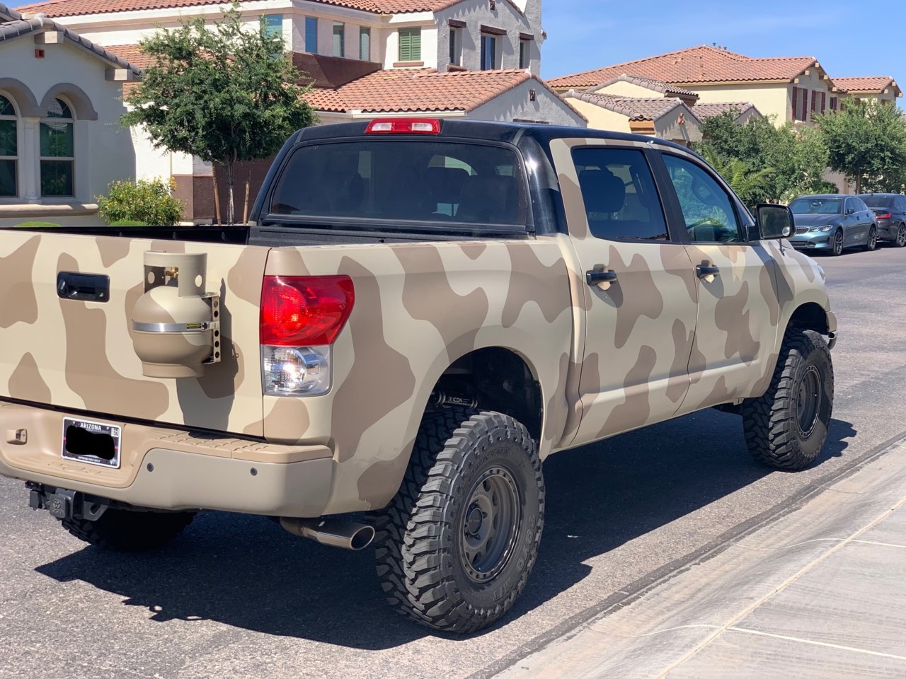

    Question: Any downside in your experience to the propane location?
    Thank you.

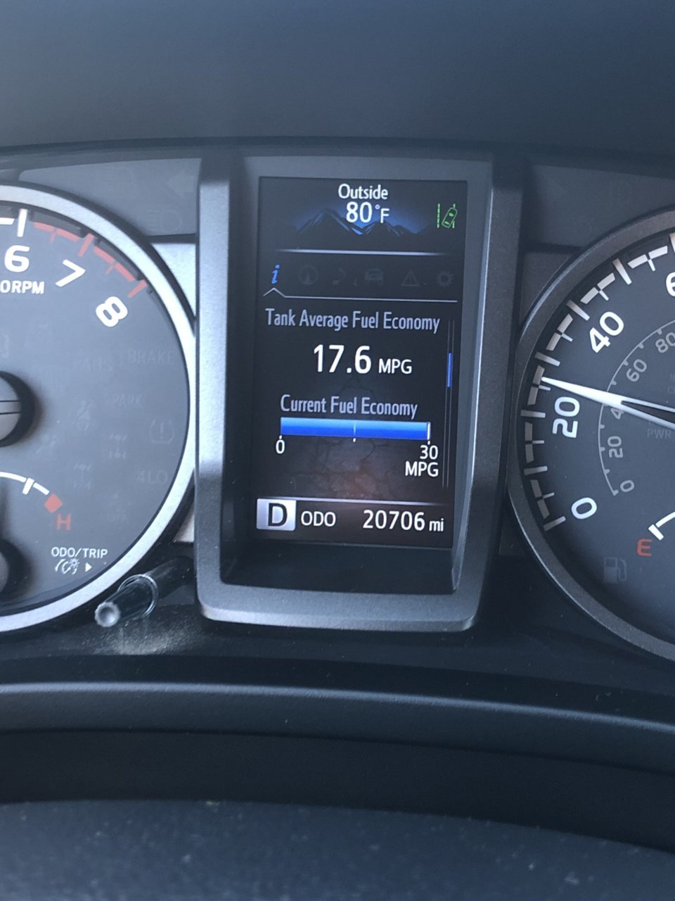

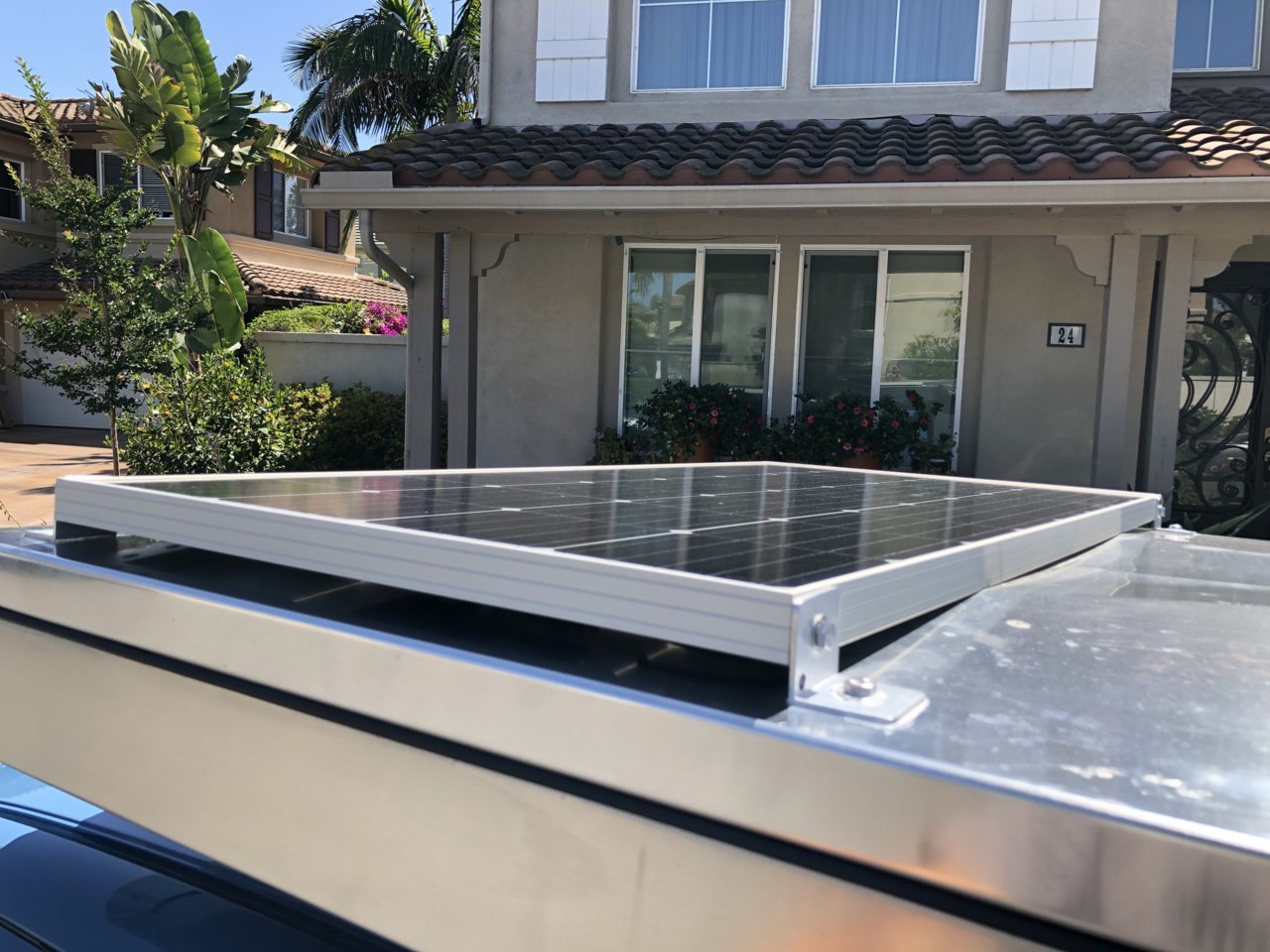

    5,396

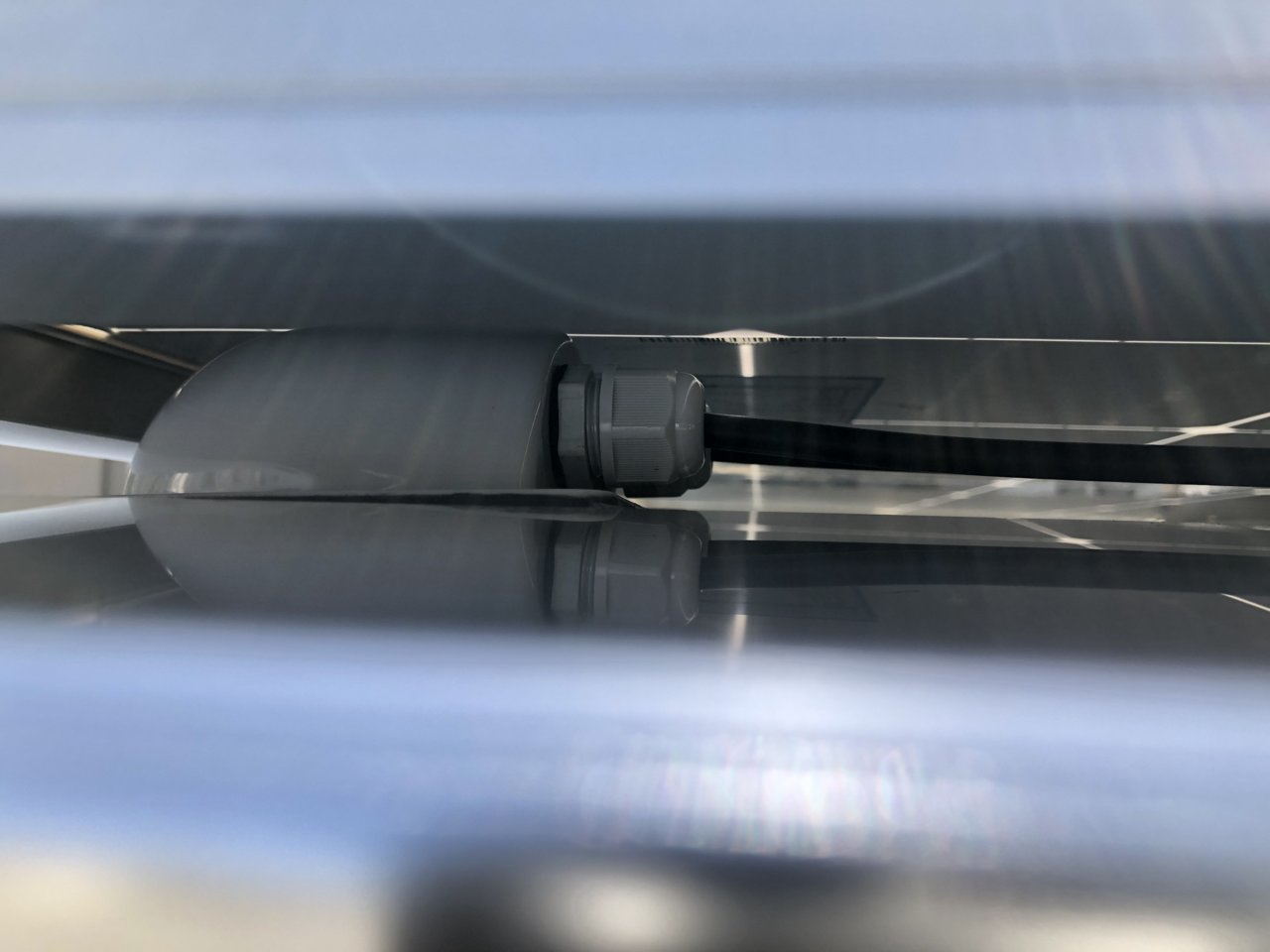

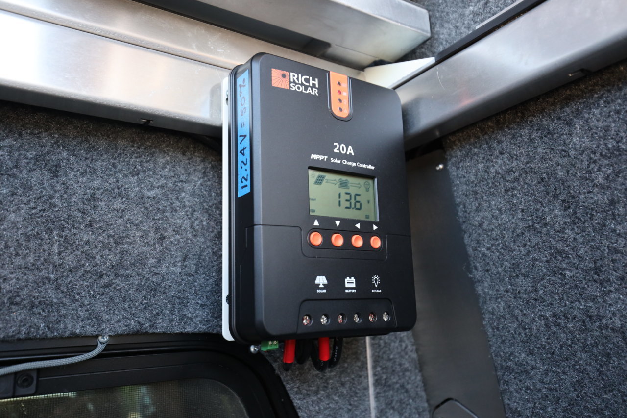

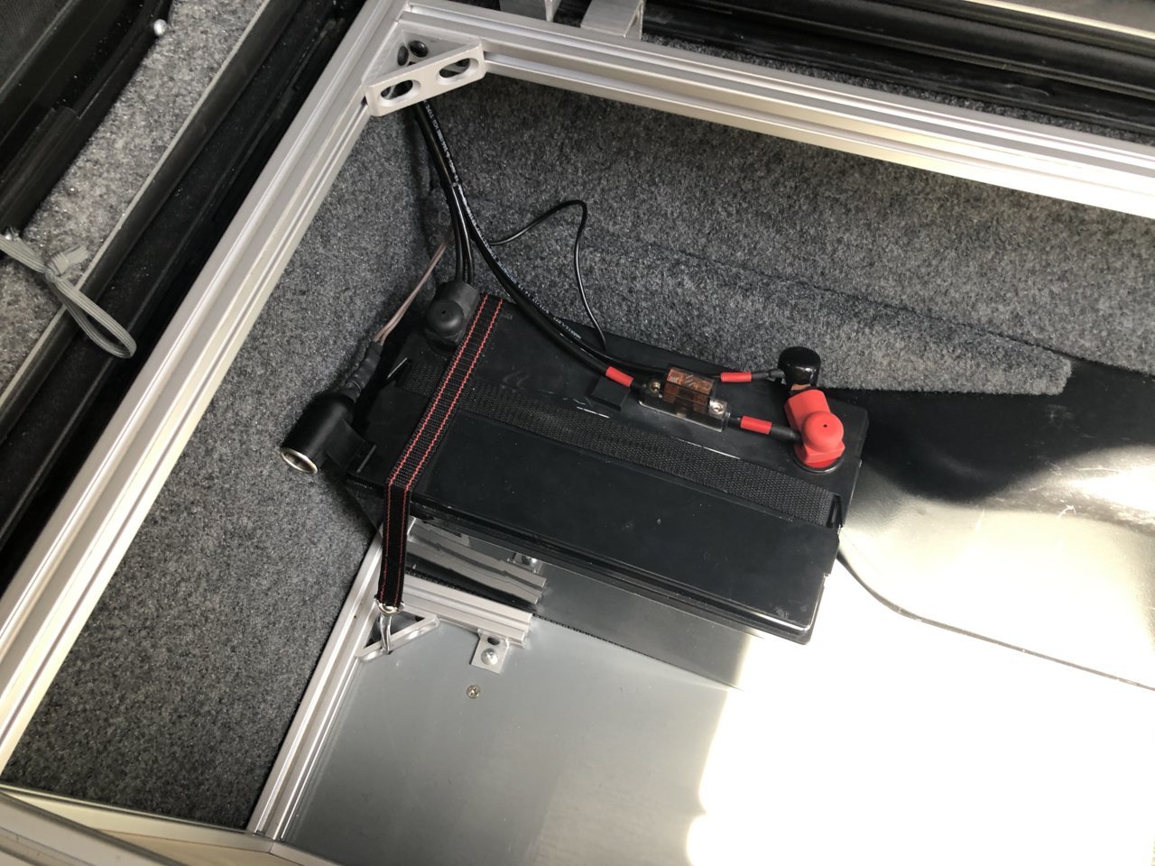

    Renogy 160W Solar Panel to a Rich Solar 20A Charge Controller to a 100Ah Deep Cycle Battery from Windy Nation.
    I'll be adding another 160W Renogy panel, as well as another battery. I found that I'd easily drain just the single battery using an inverter for charging my laptop. If you keep everything 12v, you'll be able to get by with a lot more.
    I'll add pics on here in a second. This isn't my work; the previous owner did a fabulous job and I'm sharing his work. I'll be removing the panel up top and putting both panels on L-Track.

    74
    Jerry
    Illinois
    2012 DCLB 4WD SR5
    The battery came from Windy Nation(www.windynation.com) - 100Ah.
