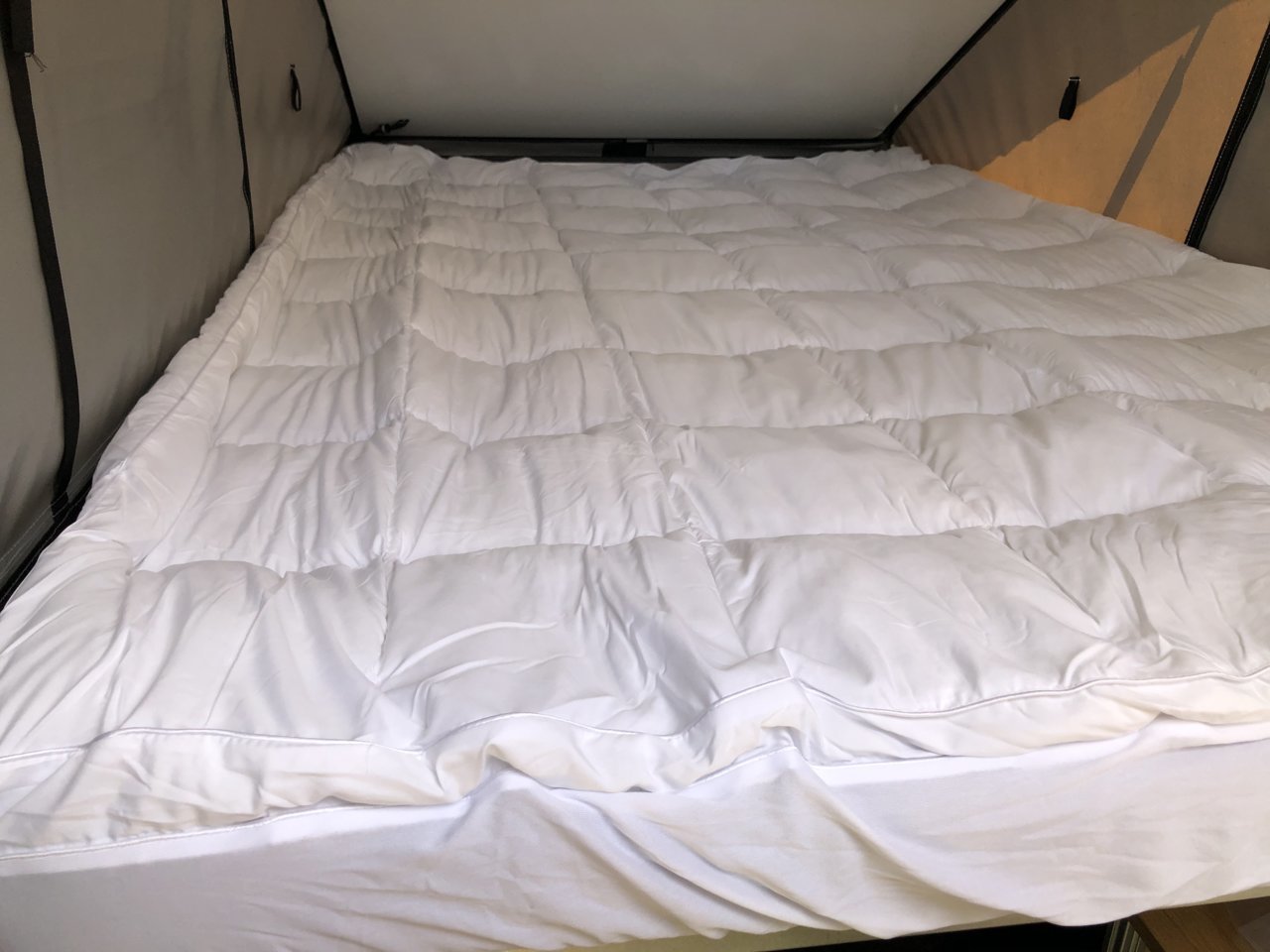

    After sleeping 8 nights in the Drifter, I was having some back pain from the mattress.
    Stopped by Walmart and bought this 2” Mattress Topper that’s like a fitted sheet. Made a huge difference for me and no more back pain in the morning! Threw a fitted sheet over and also used these really thin alligator clips to hold the bedding tightly together.

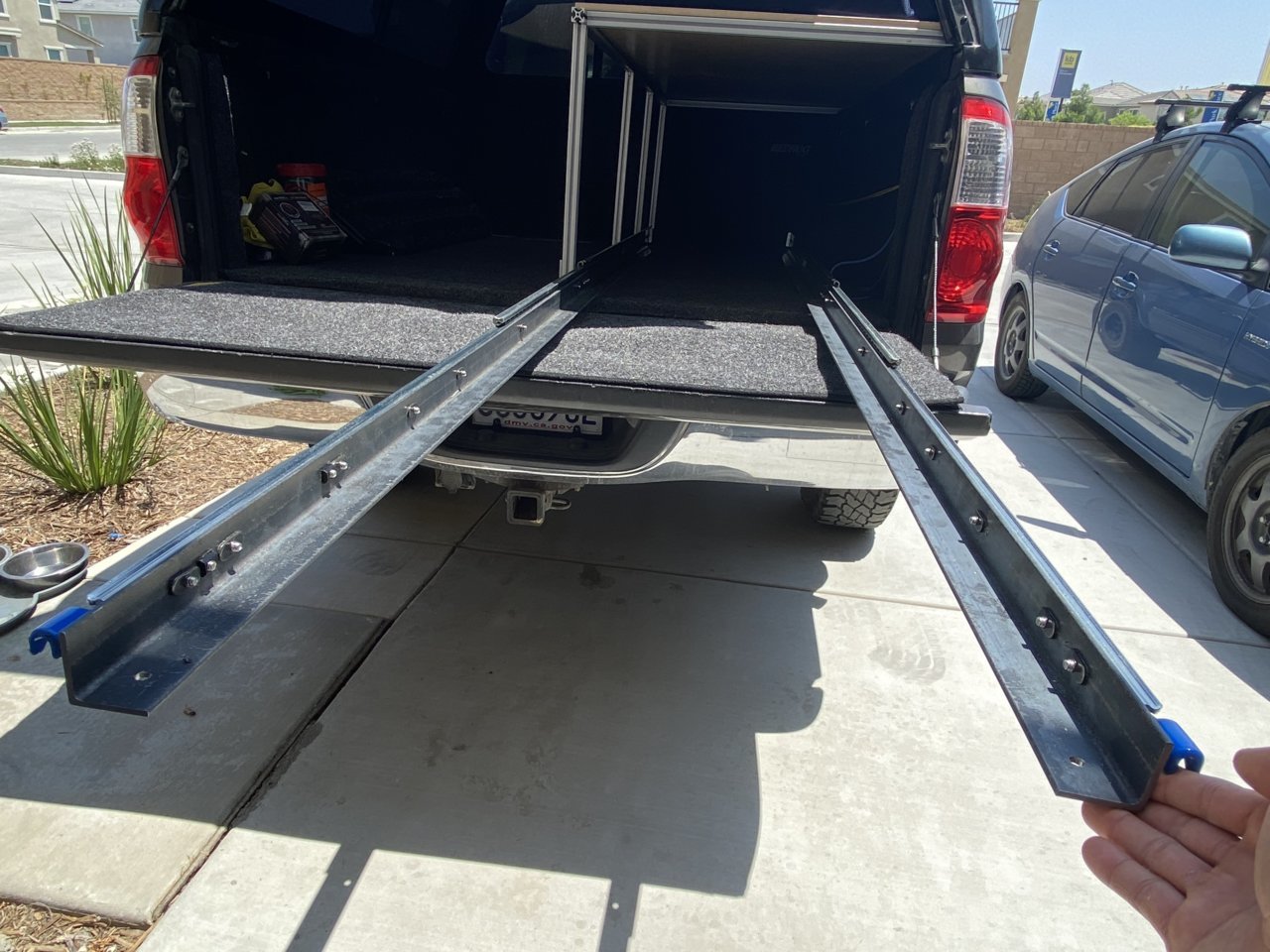

    Can someone who has the L-Track installed from Vagabond send me a picture of the bolts they use for mounting it to the roof?
    Thank you!! Got 440" of L-Track to mount...

    They are bolted through every 2 nd hole in the L track.

    Hope this at least shows what you wanted to see @SoCalTacoTruck.
