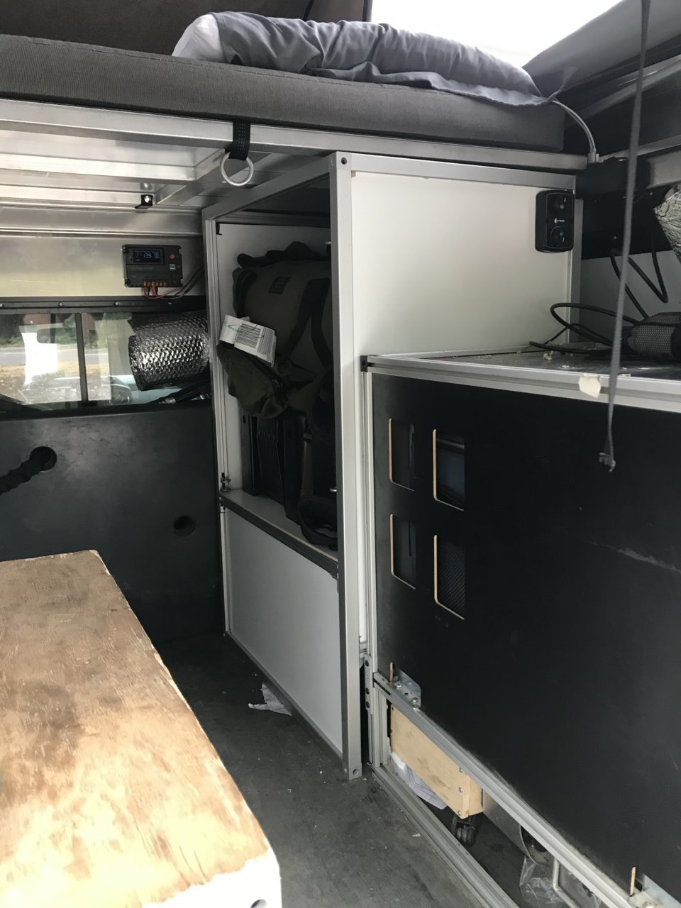

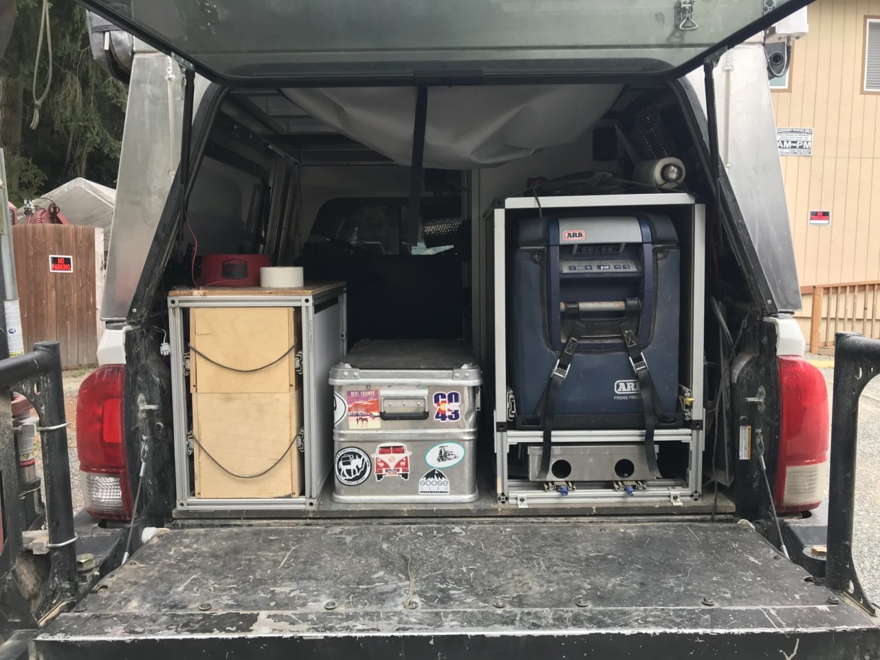

    Mostly finished building the storage and cubby for the Propex today.
    Bottom part holds propane and the Propex.
    Top part is storage. Not sure how secure (read not) stuff will be there while driving so gonna have to figure out something for that. Maybe those new Goose Gear tie downs and some bungees?
    The big things left to do is the propane, electrical wiring for the Propex, and cutting out/routing for the vents and air intake.
    I'm going to put the vent on the bottom in that panel so it creates a more even heat (since heat rises) I think. If necessary I might create a little shelf/shoe nook so that the vent won't ever be blocked.
    Plan on routing the cold air intake around the back and have it near the rear window.
    Slashaar, angeldavid216, Iggy and 7 others like this.

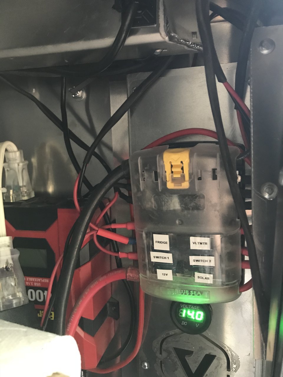

    Doing the electrical will probably be the hardest part since I need to swap out fuse blocks. My current Blue Sea fuse block has reached it's capacity and just bought one with 12 banks that I need to swap it with.
    No video, but here's a shot of my back. On the left is two stacked drawers that I made. The top lid is on a hinge allowing me to use it as a chair and the fridge as a desk.
    Middle is an Alu Box with Goose Gear step plate. I pull that out and use it to climb into my camper.
    On the right is a Goose Gear fridge slide with a DIY stove slide.
    The electrical wire hanging on the left is for my third brake light - still haven't wired that up.
    Short term improvements - new stacked drawer system, similar to old but better built (I built it in a hotel room).
    Longer term is to get rid of the Goose Gear fridge slide and build an all in one unit around an AT fridge/stove slide that also allows me to get stuff out of the fridge from inside of the camper.
    Slashaar, Iggy, Overlanerd and 5 others like this.

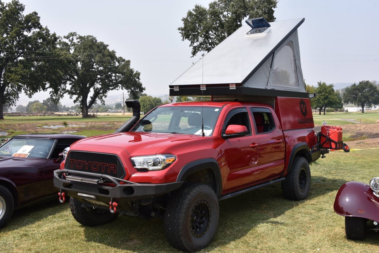

    Also happy with my wrap. Was hard to get an exact match to the Barcelona Red. But I’m happy with how close it is.
    Slashaar, dskakie, Iggy and 8 others like this.

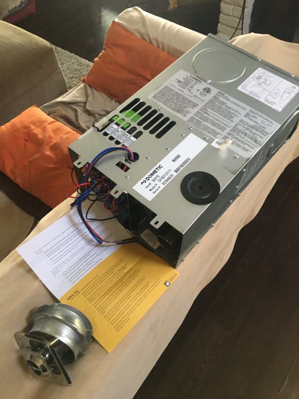

    @Iggy and @danneskjold I got the heater from Dometic so not sure if your build and product ideas will work with my heater but I’m definitely all ears! I wasn’t aware of the external Propex either...that’s gold!
