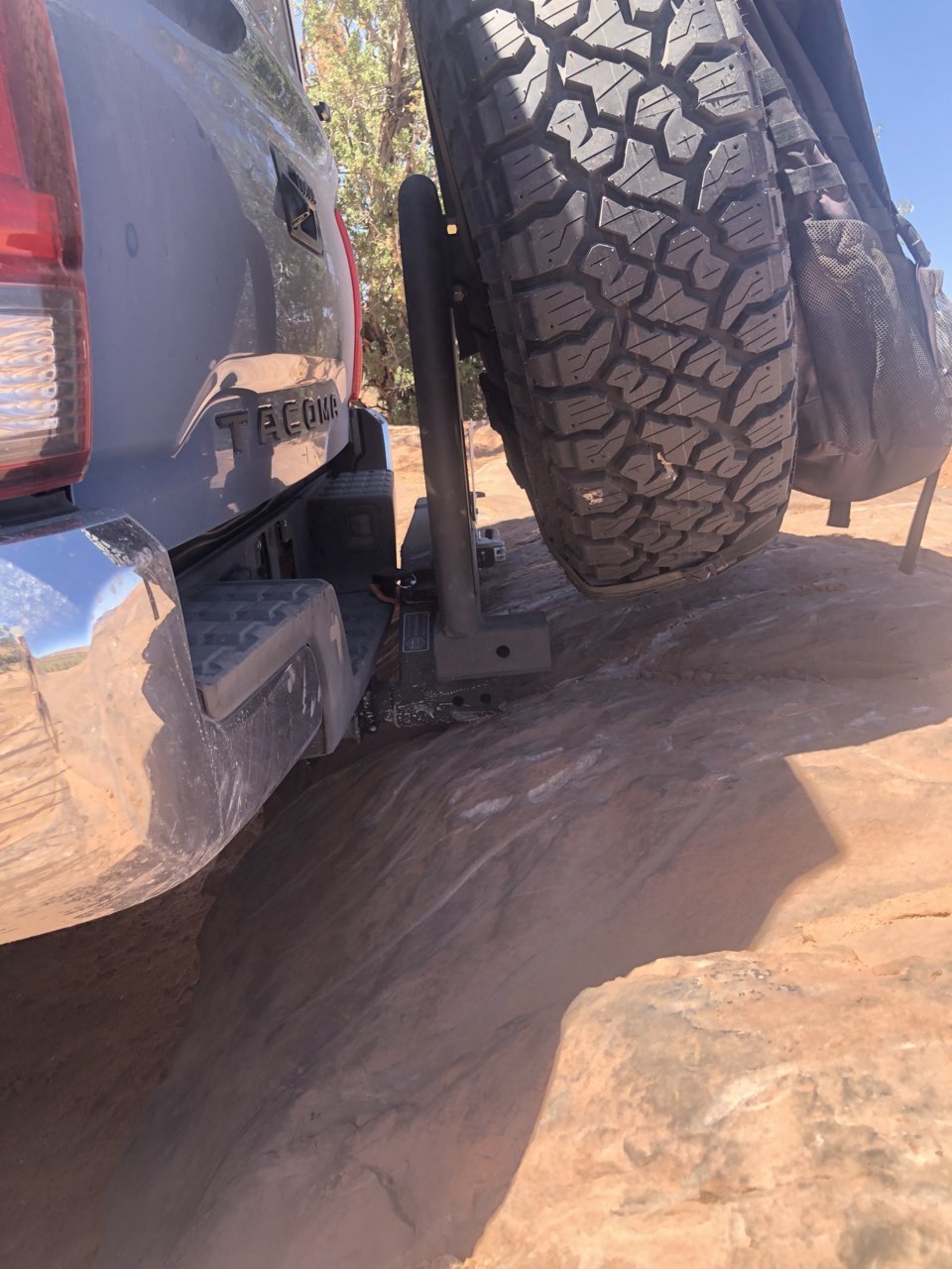

    Just did Fins N Things in Moab with my bed buildout and camper on. Was surprised at how well the truck did. Little top heavy, but was manageable. Spotted myself through the majority of the trail.
    I was going to do Hells Revenge, but figured that’d be best with another person to spot.
    Didn’t take a single picture minus this

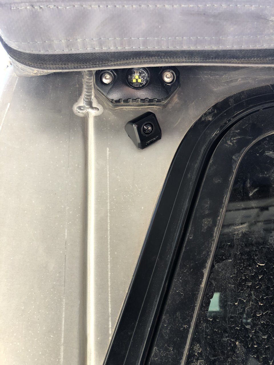

    Here’s what I did

    Thanks dude. So that wasn’t your original oem camera? If not why did you choose that one over the oem one? Thanks

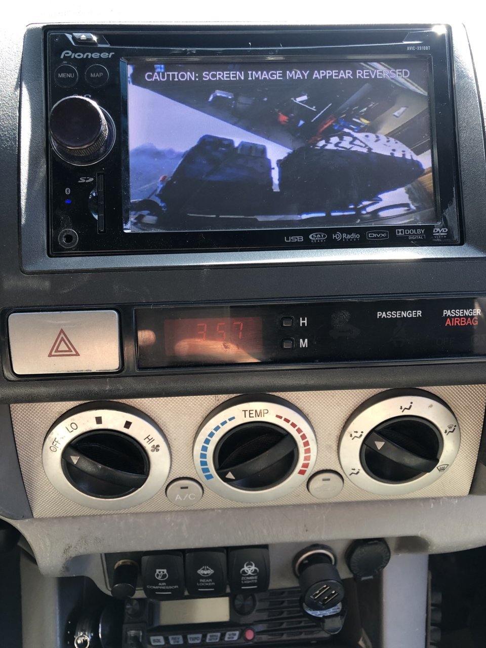

    I have mine relocated to the swing out now, but do plan on moving it up above the hatch once I get my Drifter. I'd be curious to see pictures of what can be seen on the screen with it up that high.

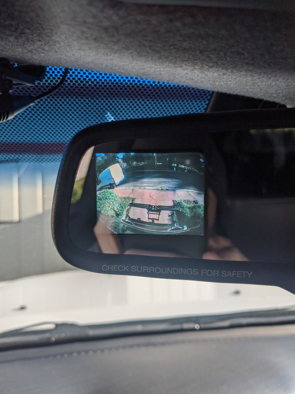

    I extended the OEM camera wire harness (it's just regular wire not insulated like a RCA video cable). Was easy to pull the whole section out of the tailgate and do clean staggered splices on my workbench. Made a simple bracket to mount above the rear door of my GFC. Not a good picture, but way more useful mounted up high.
