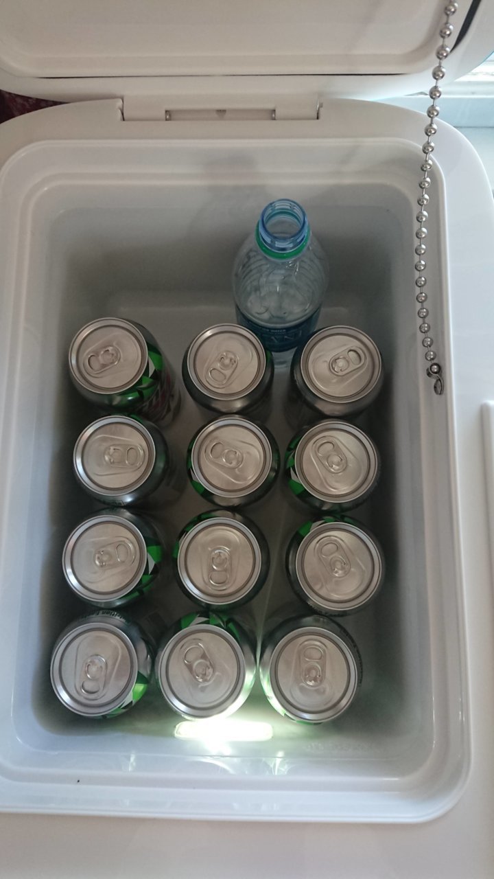

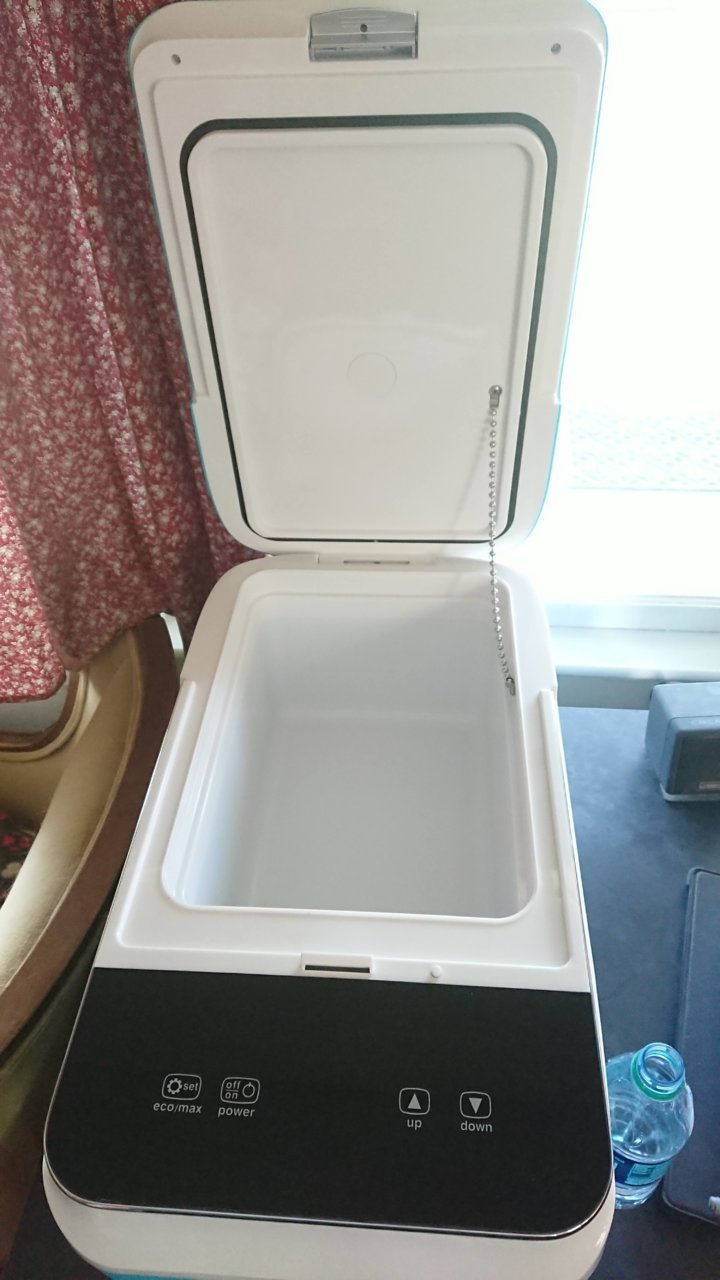

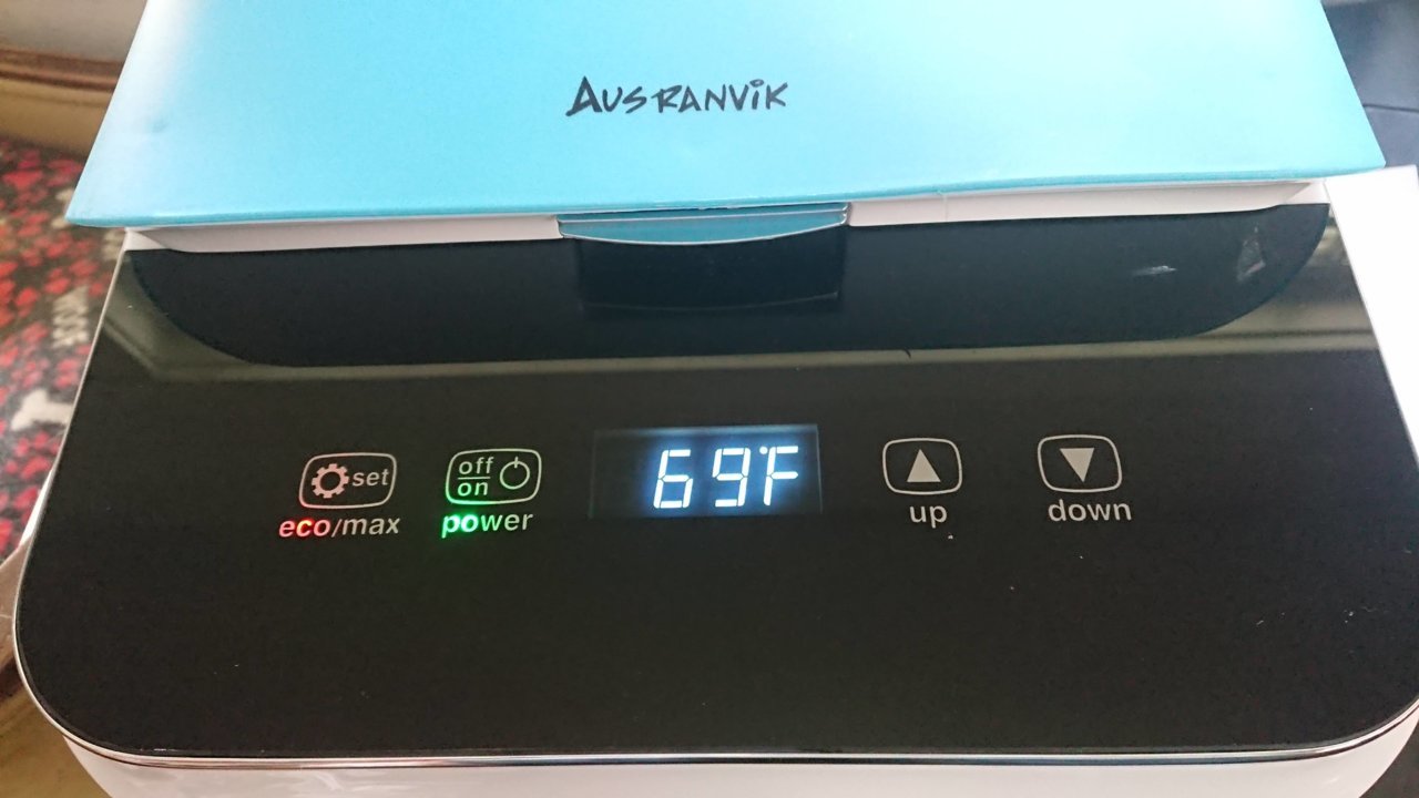

    Have been wanting a small drinks or lunch fridge in the cab since I was aware of the Waeco CF-11 (and now Dometic) many years ago. I organized the back of the Land Cruiser's sleep platform to cradle my 40L fridge just behind and center to the driver so I could reach for cold drinks. So I took a look at this, as I randomly do with many things from time to time, and find that the CF 11 is starting to push $500.. which is a bit crazy even if Dometic makes a very quality product. Happily Amazon has the related/recommend bar from time to time and an "Alpicool" 15L showed up.. for $179, or about 1/3 the smaller capacity Dometic. Looking closer at it, the Alpicool appeared to be a legit compressor driven fridge/freezer in a small package (not thermoelectric), which is perfect for a Tacoma cab which leaves a food fridge or freezer dedicated unit for the rear and doesn't require me to carry a soft cooler or get into the back to dig for a drink.
    Wow, this is getting long. So I dug more and found about 3 other models of varying design and landed on this Ausranvik (lol) unit. https://www.amazon.com/gp/product/B07KSPY3KQ I chose it because the lid latches and it came with both AC and DC connectors. It is a little different design than the more gray "Engel" looking competition. I haven't had much test time, but it is taking it about 45min to drop from 75 to 32F.
    NOTE: If you look at these, you need to be careful. The thermoelectric (worthless imo) units will advertise in terms of -10/20 degrees, and they can heat (+10/20) against ambient temps. You could also hold a drink next to your AC or heater vent too...
    Here's the Alpicool https://www.amazon.com/VBENLEM-Compressor-Portable-Refrigerator-Electric/dp/B07TKRY1FG
    ok, that's another one. HERE's the Alpicool https://www.amazon.com/Alpicool-Portable-Refrigerator-Vehicle-freezer/dp/B073WYS3TR
    I'm heading out for a few days around July 4th so it should get a better test then. Should work good in the passenger footwell or behind the passenger seat. It would fit well in a dual cab in the rear center seat as well, and the fan exhaust lends itself to not be potentially blocked.
    ok that's enough, thought I would make a post to bring awareness that something like this exists and is pretty reasonably priced.

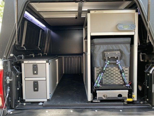

    Got the GooseGear buildout completed, had a few fitment issues that I had to sort out as things didnt really line up the way they should have. One thing left to fix is the height of the brace on the fridge side so that I can place a board down to create a sleeping platform on the bottom, right now its about 2” higher than it needs to be.

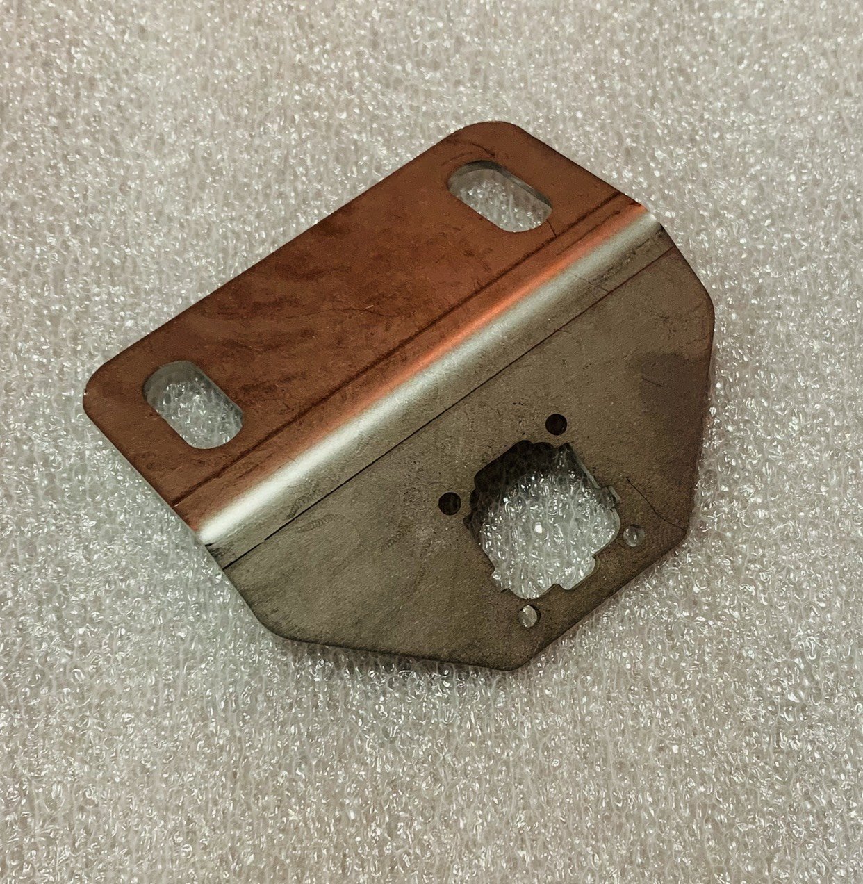

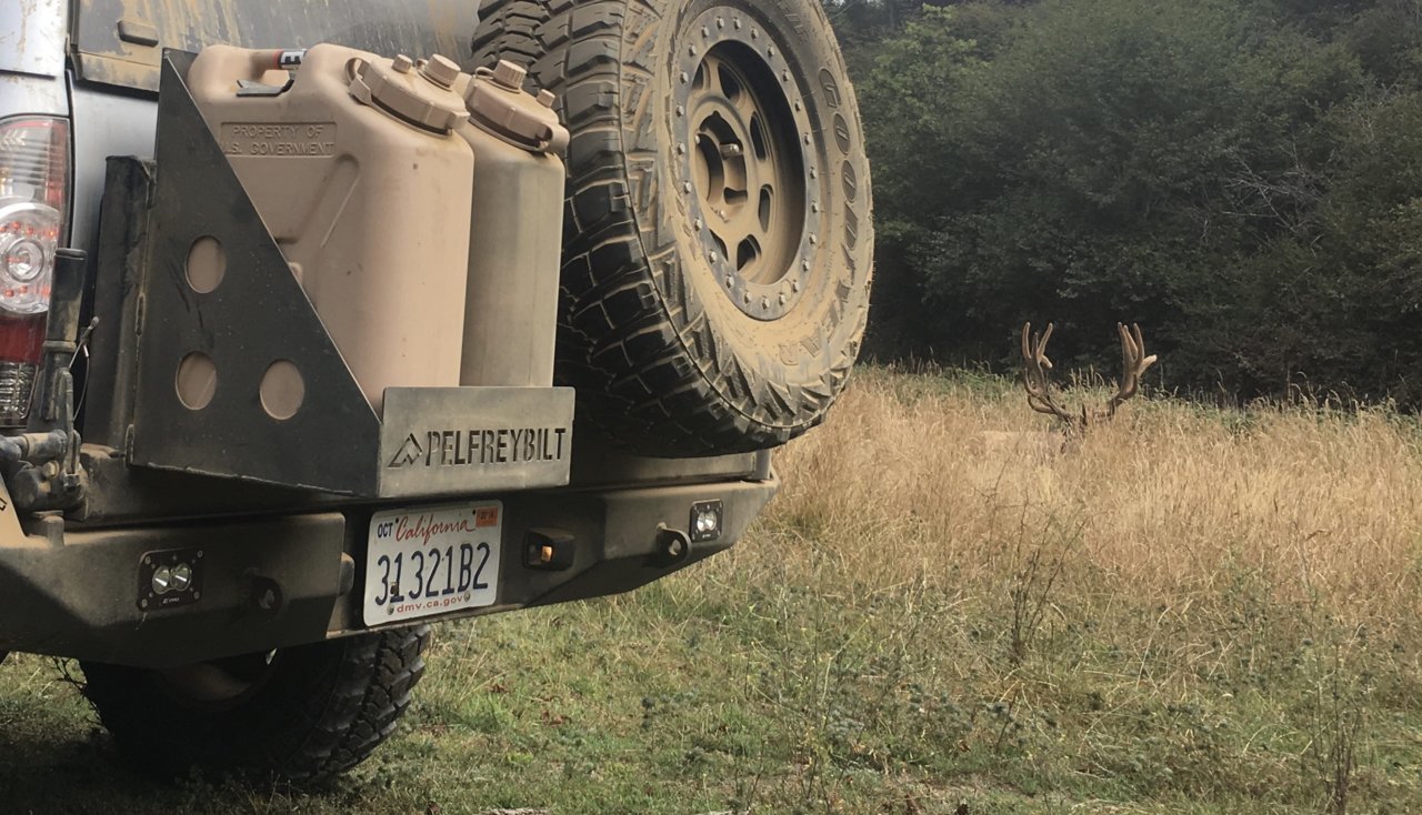

    i relocated mine into the license plate area. i had hoped it would fit 'into the numbers' but wasnt to be....

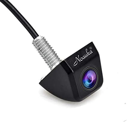

    Not oem. It was from Amazon for $15. The oem one mounts weird. Has a weird cut out and then 4 small screws. See this relocation bracket for reference
    The amazon one has the wiring go through one threaded stud and you use one nut to tighten everything.
    As for wiring, I just tapped into the wiring under the bed that goes to the oem camera. Like someone mentioned, there’s a small connector under the tailgate you can follow to see where the camera wires are. I pulled out one of the connectors and tapped into the wiring. Btw it’s not your traditional wiring colors:
    1 CV- (White) Camera Video Negative
    2 CV+ (Red) Camera Video Positive
    3 CGND (Blue) Camera GND (Shield)
    4 CB+ (Black) Camera Power
    Then I chased up the wires near the driver bed rail and connected it to the Drifter corner panel using this deutsch connector:
    Here’s more pics of the camera and output picture:
