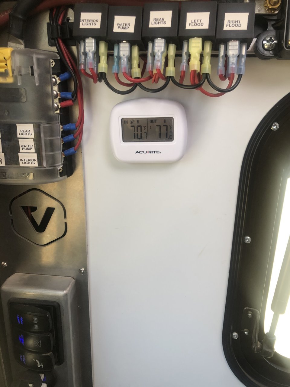

    My Dometic CFX50 runs on 7.8 amps.
    Each circuit on the Blue Sea aux fuse panel is rated for 30A max and I played it safe because I have a ton of electrical in the Drifter: fan, rear lights, R & L flood lights, LED bar in front, interior light - lower and upper, water pump, diesel heater. (btw the other electrical I have in the Drifter that’s hooked up separately is the back up camera - powered from oem camera under bed, fridge - separate run to other blue sea aux fuse panel under hood, and air compressor - directly to starting battery)
    If you even think you’ll add any other electrical in the future, run a larger gauge.

    Any ideas on keeping the LiFePO4 cool in the engine bay? I have shied away from that location because I didn’t want to see my lifespan for an expensive pack reduced prematurely. My current Valance (eBay) pack specs say not to charge higher than 113deg F. Something I am betting happens often in the engine bay. On the plus side, the engine bay would almost always be above freezing for winter charging!

    Where did you stick the thermometer on the outside?

    On the Drifter with the maxtrax sandwiching it in place

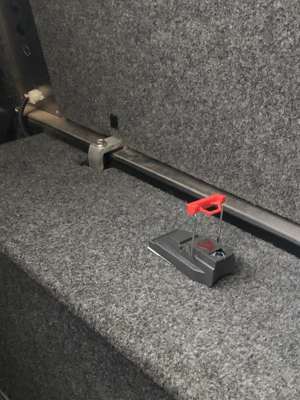

    This morning, I realized I had a stowaway inside of the camper. Only way it got in was climbing through the gap between the window and my bed
    3 mouse traps set. It is hiding inside my bed cap...I did not place it in this location. I put all of then in corners where I saw Jerry.
    Weirdest thing ever. Pretty sure I just heard one go off right now...will report back in the morning!

    Mouse traps have changed quote a bit... haha

    This thing was so high tech, and 3x for $7!
    It worked though! I caught the mouse.
