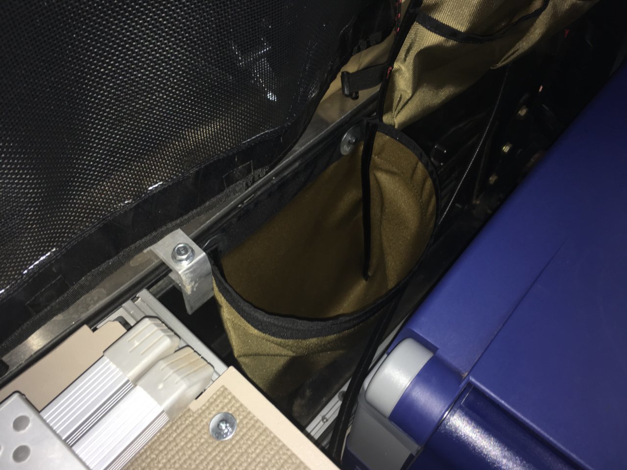

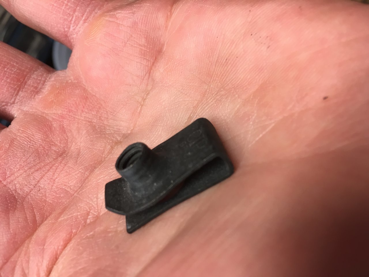

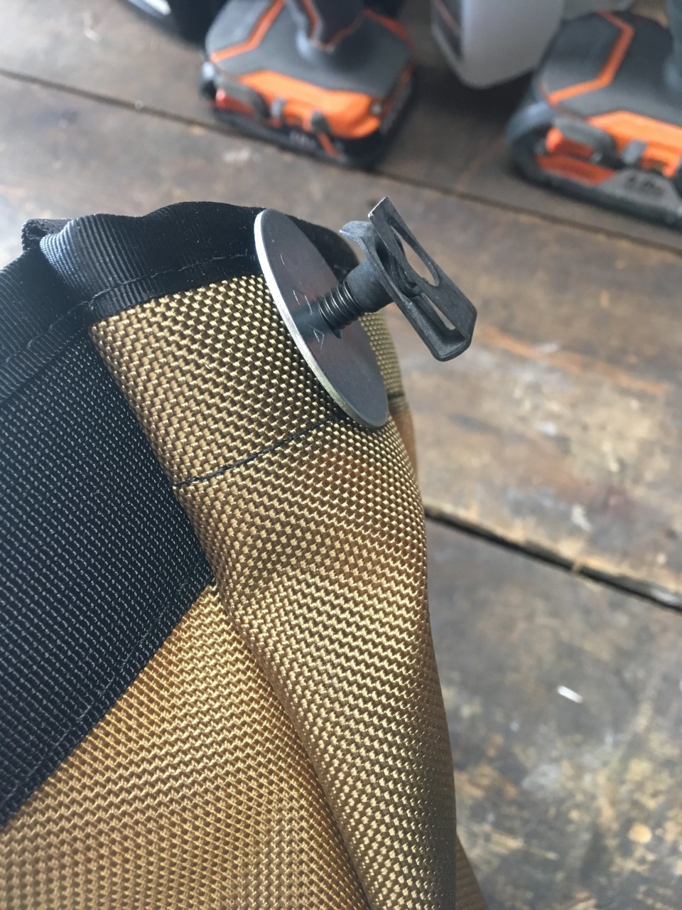

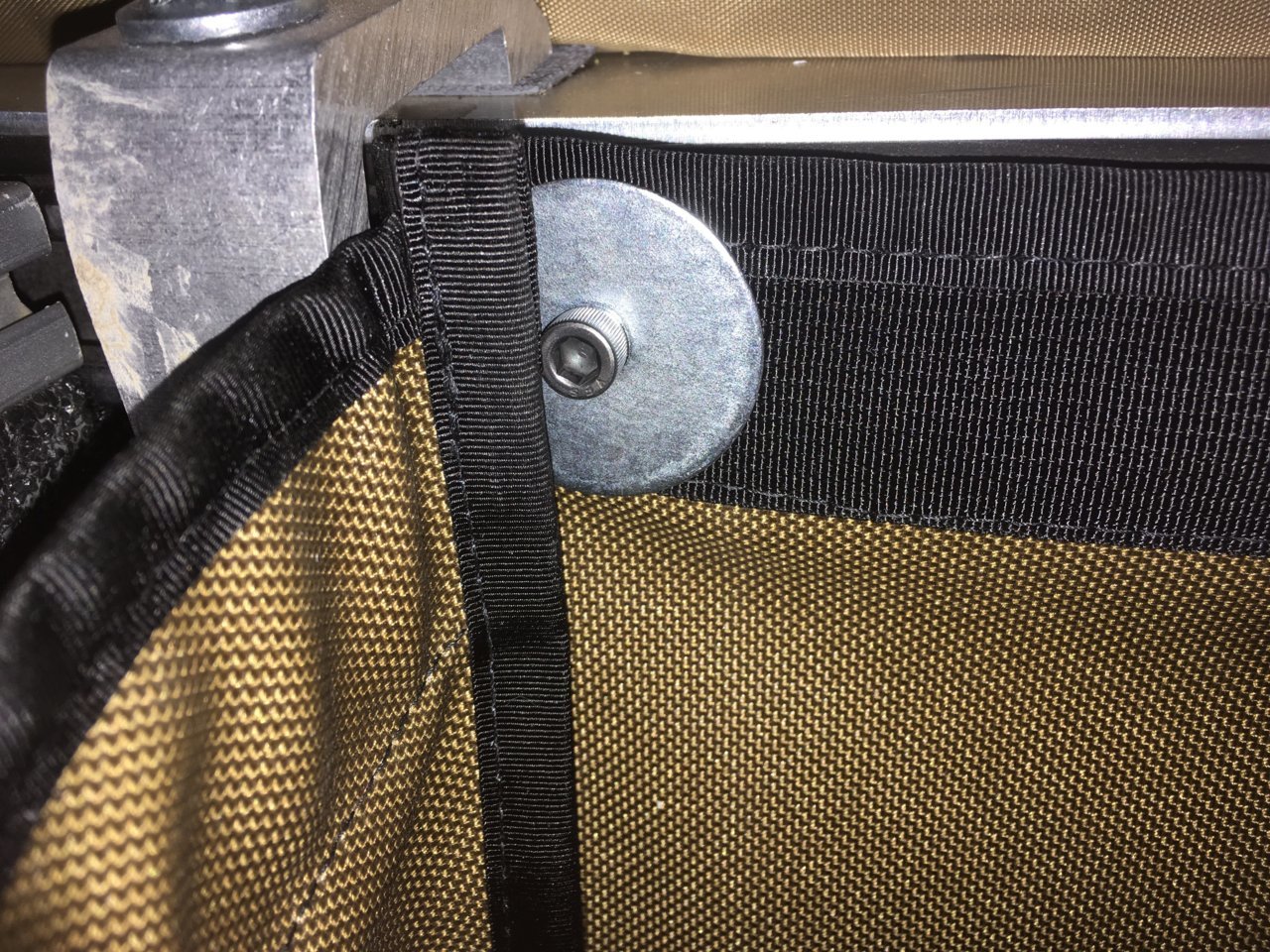

    If anyone is looking for a way to attach cabinets or other items to the factory accessory rails inside the Tacoma bed, here's what I've been using. I know there are various track nuts out there, but a quick search didn't turn up anything large enough for the rail that also had a small thread, and I wanted to just pick something up at the hardware store. My local Ace had these U-Nuts in 1/4-20, and that's what I've used to attach everything from my cabinets to my fire extinguisher to the little trash bag I just made today (uses the wasted space behind the fridge). These things interface with the rail quite well, are cheap, and I've had zero loosening even on lots of washboard. I'll attach thumbnails so as to not blow up the thread with huge photos of boring stuff: (EDIT - yeah, the thumbnails didn't work out somehow.)

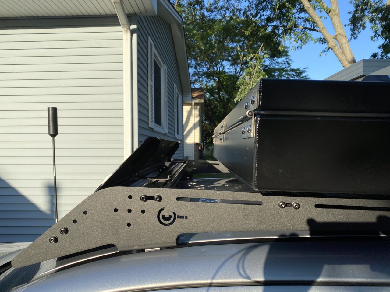

    Got the Prinsu Habitat Rack installed today. Also added a Front Runner fairing on top but it ended up being too small, oh well maybe once I come up with something better I will modify it but at least this will keep the bugs from accumulating on the wall at the back of the cab.
