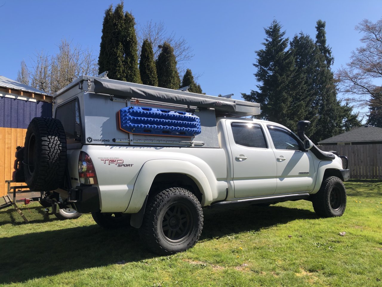

    I ordered my drifter without side doors or windows with the plan of installing traction boards and rotopax to the sides. I think a few people might have done this already. I would appreciate any photos and words of wisdom.
    Cheers!

    I am glad I don’t have windows. Birthday suit all the time.
    I installed L track on the sides to mount stuff. You can have them install it, or do ir yourself!
    tyfoon11 and BZ4X4[QUOTED] like this.

    Did you add anything to the backside to add support or just nuts and washers?
    Thank you for not having windows :thumbsup:

    #230791
    5,406
    Yes I added 1/8 or 1/4 alum flat bar. @tyfoon11 told me you can also use large fender washers.
    tyfoon11 likes this.

    I have no windows and the insulated walls. Mounted L track top and bottom on both sides and yes aluminum bar for backing. I had the insulation loose attached back when we picked up the camper so that I could remove it and mount the track without sandwiching the dilation and panel.
    BZ4X4 and kceastsparks like this.

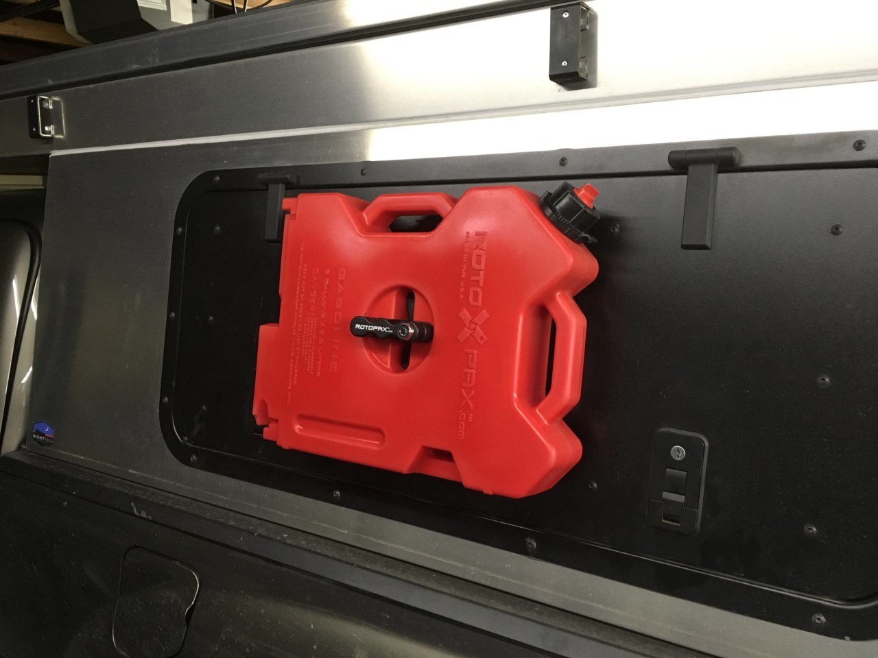

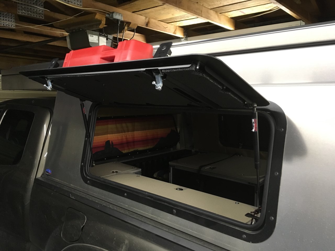

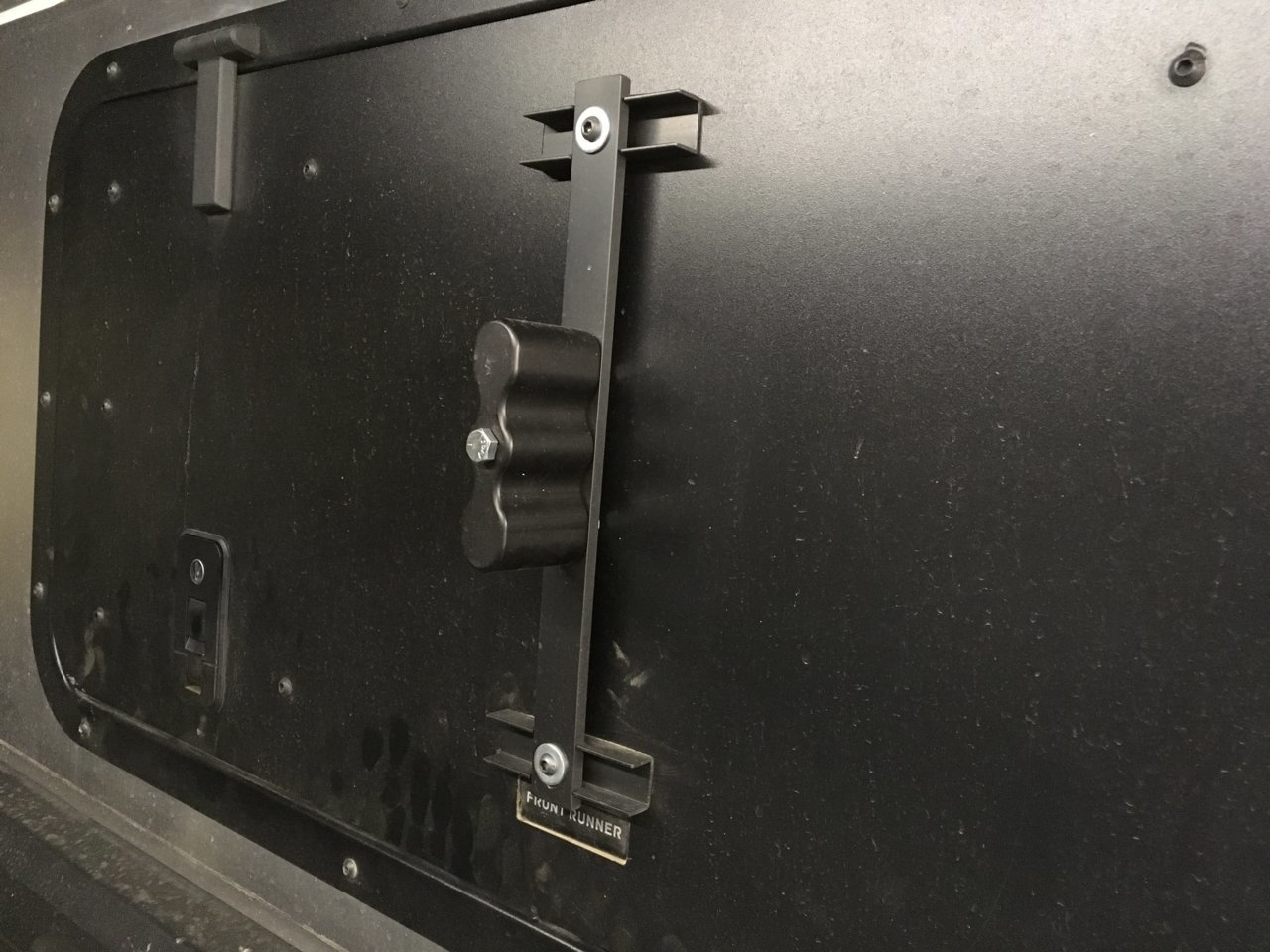

    Just in case you want a slightly different take - I have the solid FrontRunner doors and I made Rotopax mounts for them. (See photos.) The 2-gallon Rotopax cans fit really well, and the FrontRunner gas struts can actually hold a full Rotopax up! I just remove the outer part of the Rotopax mount when not in use, and plug the exposed threads with a small bolt to keep dirt outta there. I really, really like having the FR doors... I use them all the time. Not having to crawl into the camper to get anything I might want is a definite bonus. But I suppose I can see reasons for solid walls, all personal preference of course!
