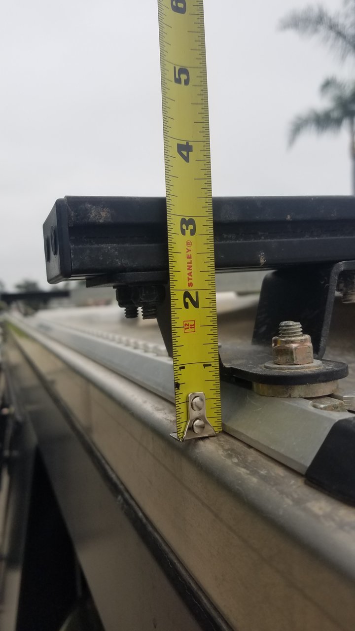

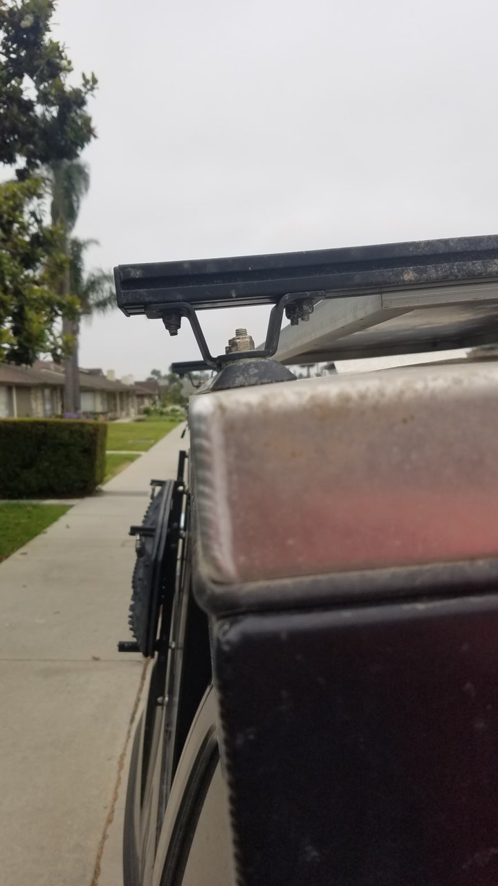

    I used the vagabond provided Ltrack and the prinsu mounting feet w/extrusion. I had to buy longer cross bars tho because the prinsu ones aren't long enough. Only sits about 3 1/4" above the roof.
    A benefit with the Ltrack is with the right mounting pieces you can enter the track at any point because of the circular openings whereas the yakima or thule rails you can only enter at each end.
