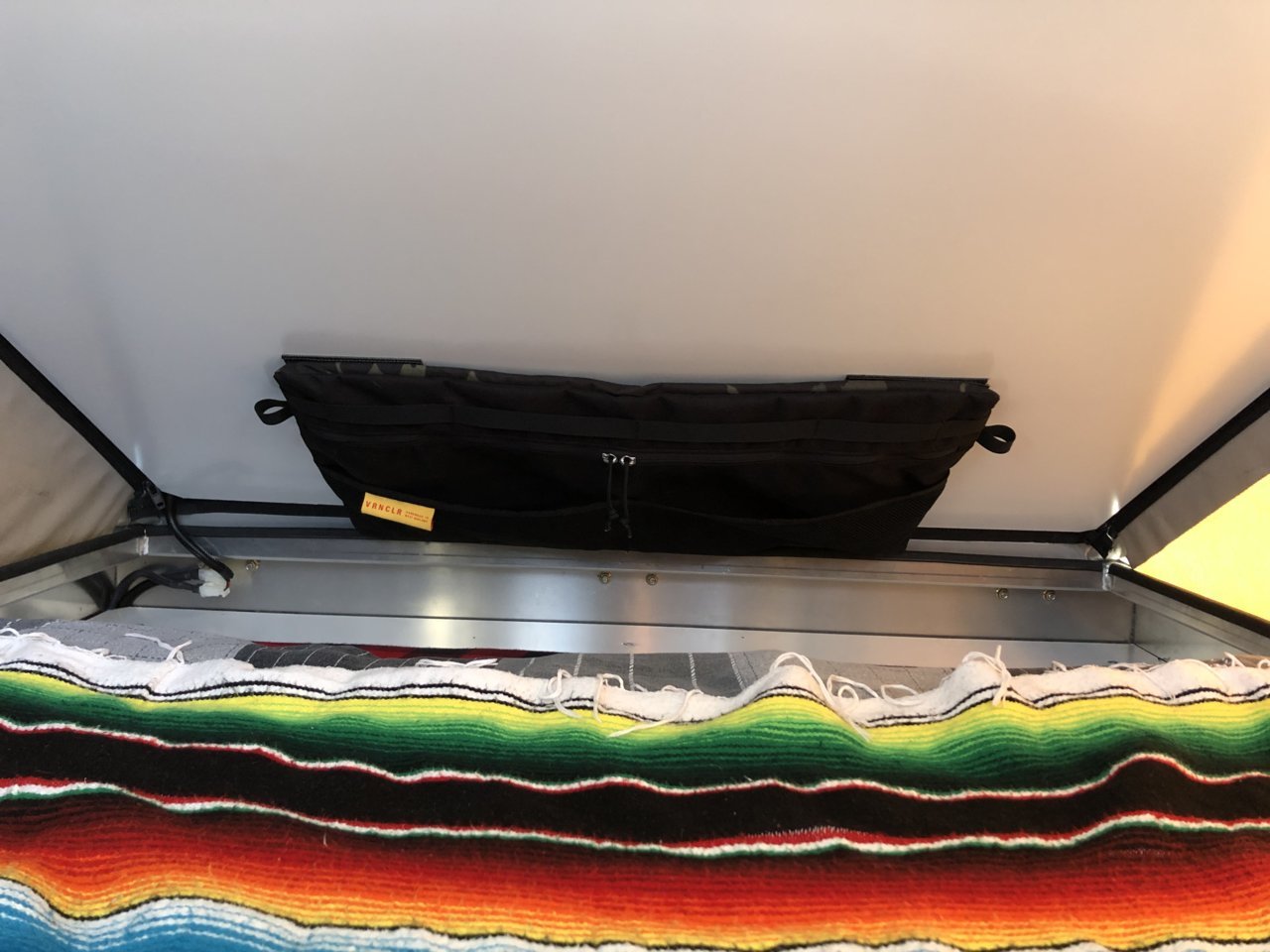

    https://vrnclrsewnstorage.com/products/the-top-shelf
    so to help solve some storage in the drifter i got one of these - its a vrnclrsewnstorage “top shelf” which can be placed anywhere on the “ceiling” of the drifter. i placed mine pretty far forward - partly because i like to sleep with my head in the wedge (the view is better) - its super well made using sturdy materials - vrnclr makes sweet bike frame bags and stuff - bags - gfc things etc - he is a one man band out of oakland - and as much as i know there are possibly cheaper mass produced ‘similar’ items - i enjoy supporting when people handcraft things
    - it has a couple net open pockets and a large zippered pocket (which he lined with a bright color so its easier to see inside)and spot’s to attach and hang things - i have crap shoulders from rugby and years of working in skydiving so this is making my life easier to be organized - for sure
    happy fourth

    Yeah I tried sleeping with my head in the wedge and thought I broke the roof panel and my head when I got up foggy eyed...
    I'll never be doing that again

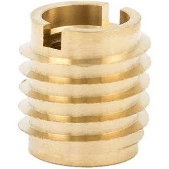

    So, for those of you who have constructed your own baseplate (I am using 1/2" baltic birch) & storage/fridge slides etc., does everyone feel these threaded inserts below are the best solution for adding tapped holes to your base plate for the mounting of a fridge slide or other stuff?
    https://www.amazon.com/dp/B00207NF6...olid=1A14TC8VYLB4T&psc=1&ref_=lv_ov_lig_dp_it
    It seems like these would be more secure than the only other alternative I can find, which would be the hammer in style Tee Nut Inserts. McMaster has other options than brass, (steel or stainless) which I think are most likely a better choice than brass which I worry about being too soft.

    Tee nuts will be much stronger than the threaded insert and much easier to install. Those brass inserts are really easy to break and pullout strength will be pretty weak relying only on the threads. The tee nut has a large flange that will result in a much stronger connection.

    Thanks, that makes sense to me now that I understand how they work. Tee Nuts it is.

    I used tee nuts, but the kind without teeth. If I remember right, I tried the teeth version on my 1/2" baltic birch, and it was super tough to get them set down into it. I just used an under-sized drill bit so the core fits really snug.
    Also keep in mind that it's best to have them flush to the underside of the baseplate if they're sitting on top of a bed rib. It was easy to use a spade/forstner bit to get them sitting flush in those spots.
    Edit: Found the link for what I used. They also have small holes so you can use a little brad nail or something to keep it from spinning, if you want.
    https://www.mcmaster.com/90611A400/
