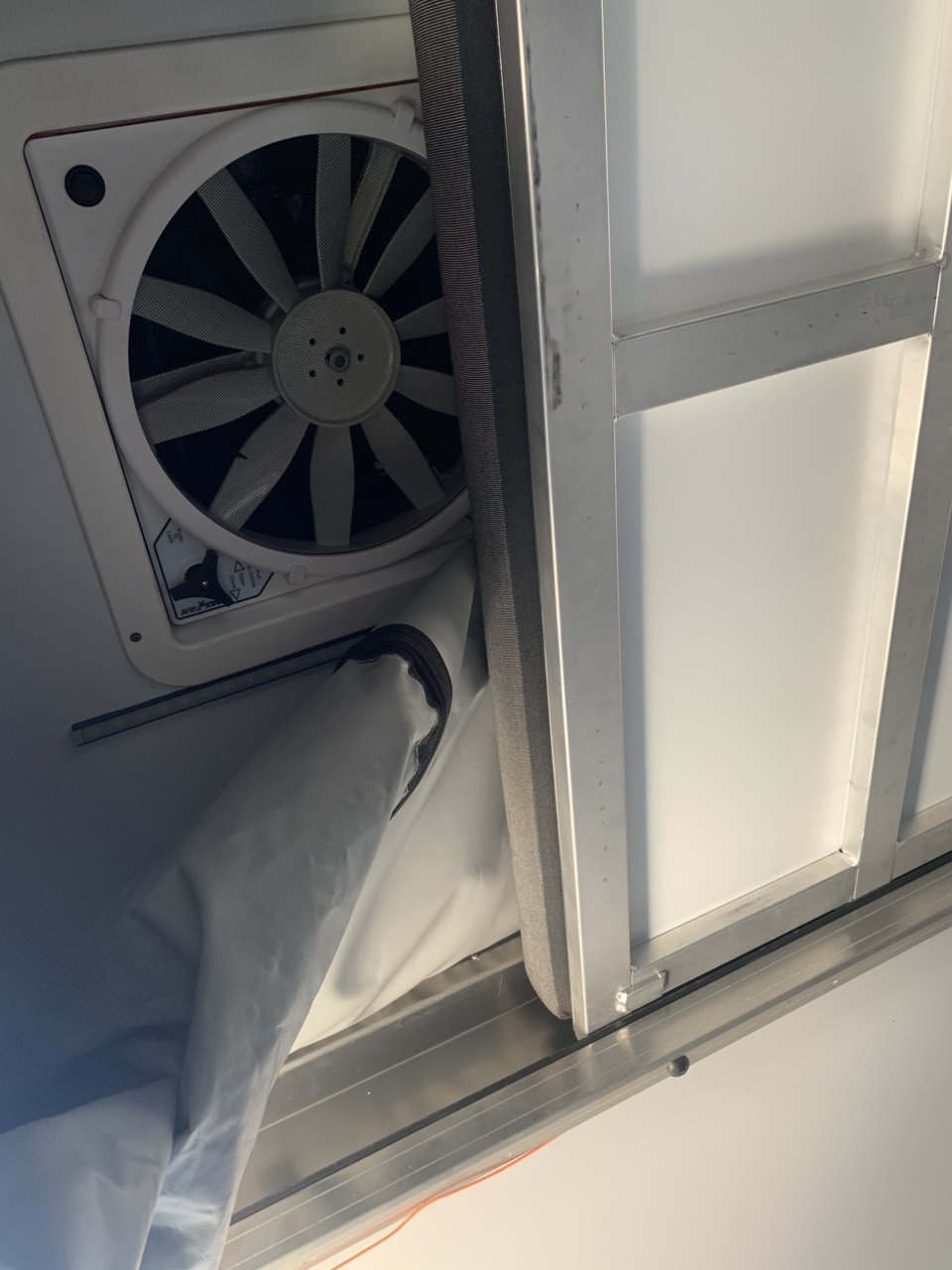

    Hope this is ok. Platform isn’t really blocking it at all and the tent gathers around it without the platform supporting it

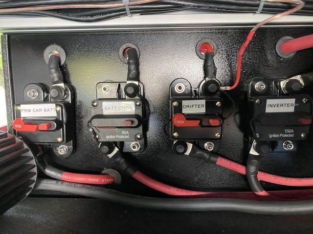

    Did some after work therapy today and swapped out the breaker for charging the battery as the 40A breaker would pop with 35A going through it, put in a 60A and finally labeled them :)

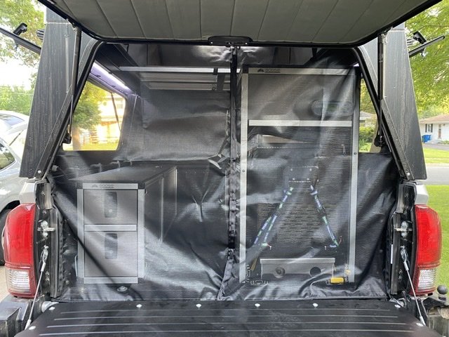

    If anyone ever wondered here how the bug netting looks like for the Drifter, got it installed today in about 20min. Really happy with it, only gripe is that the bottom seems to be too wide for a tight fit, probably 2” too wide, fit is perfect everywhere else.

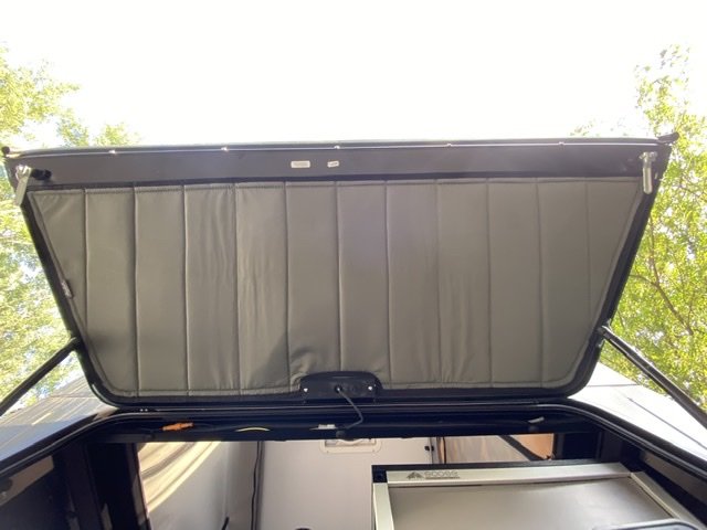

    Here is what the rear hatch cover looks like from the same supplier. Good thermal insulation and privacy. You can see the cut around the brake light is not very good. I trimmed the curve a little bit and massaged it into place but it still creates a crease.
    *other than that one small thing the cover is perfect. The materials are very high quality and the stitching is clean.

    Hi Konstantin,
    Thanks for your input, The bug screen doesn't seem to be positioned correctly on the bottom tailgate section. It's meant to sit behind the striker latch and far to the outside. Regardless, the cover drops about an inch lower in the center so that no matter where you have the sides positioned, the center can always drop into the tailgate gap (unless you have a dust protector like me). This is intentional and will work with 2nd and 3rd gens.
    As far as the cutout on the rear hatch is concerned, there is a chance that when binding that tight corner, one side could have gotten sucked in, making it lop-sided. However, it's really difficult to tape a seam in a hard 90 degree square corner. So we error on the side of a slightly too tight corner to protect from light leak, as opposed to creating a gap and letting sunlight through. Also, that cover and insulation will relax and the corners will be come more pliable. If you trimmed the corner, then you have cut into the seam tape and then we have another set of issues. If you have grievances with the product, let me know directly so I can help advise since we've already had email correspondence. We're a small business and spend a lot of time perfecting the fit. I'm happy to figure out any issues. - Garrett

    I will play around with the bug screen a bit more like you suggested to get a better fit, its not a big deal as its fully functional and looks incredible.
    With the hatch cover I plan to have my wife do some fine tuning on that curve around the brake light as she is good with a sawing machine, its an incredible product that no one else even makes so its the best on the market :)
