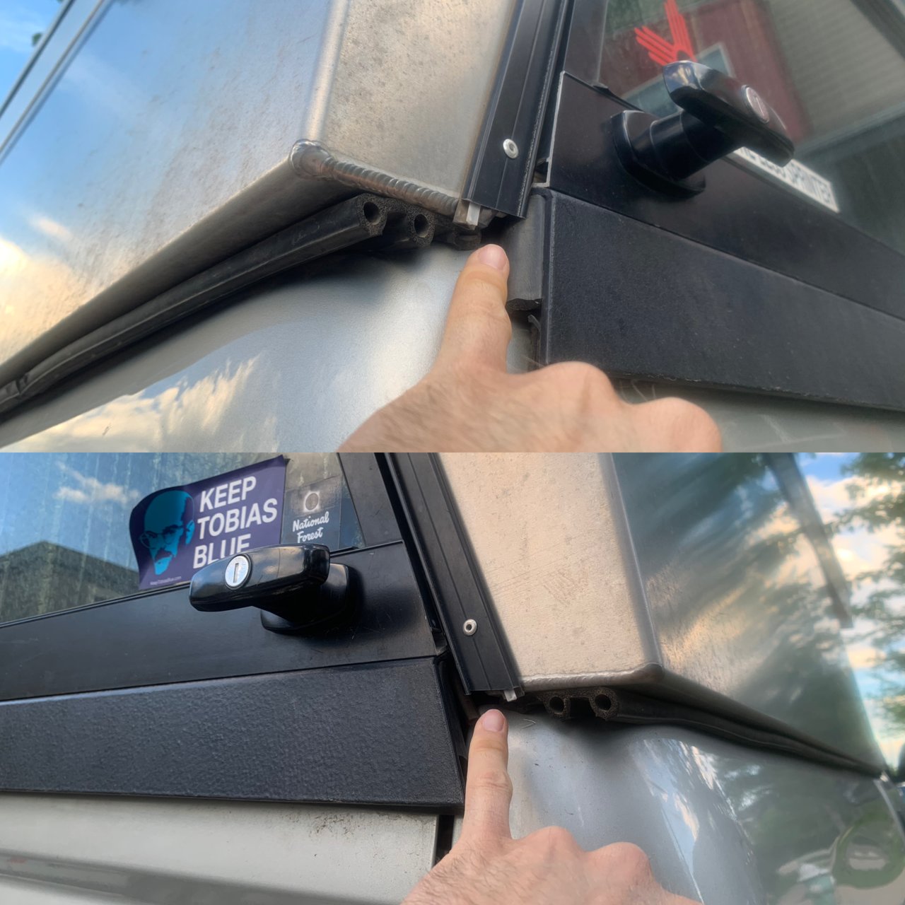

    New drifter owner here, picked it up used this past weekend and I'm in love.
    A few questions for the collective hive:

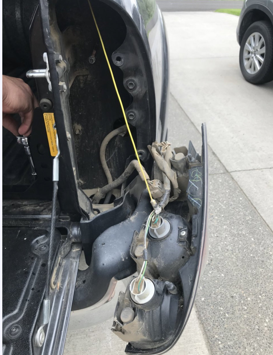

    The previous owner supplied a small wiring pigtail to tie into my tail lights for the third brake light, does anyone have a schematic or instructions for wiring that up? I realize its probably just finding the power and ground for the tail light circuit.
    I need to install some aluminum bed rail caps, which I may just end up making myself similar to the relentless units (sadly they aren't offering them right now). If I go with a 1/8th or 3/16th thick bed rail cap to replace the factory plastic caps, how much does that lower the drifter? I'm trying to make the front bed wall, and side walls all one level for ease of sealing. It would have been best to do this before I picked up the drifter, but time was very short.
    What is the preferred storage method for the windows when stowing the camper? Currently I roll the two wide windows in when lowering the roof.
    When stowed, the tent material hangs down, has anyone come with a solution to support or hold the material up and out of harms way? I'm thinking some easily removed webbing/straps. My truck still gets used like a truck a lot, and I don't want to snag the tent material when loading/unloading.
    My drifter was originally intended for a 3rd gen taco so the lower trim piece on the rear flip up window is different than what's required for my 2nd gen. For the time being, I'll probably just make something work to cut down on dust intrusion, I was wondering if someone could post a picture of what the lower trim piece looks like on their 2nd gen?

    Send a note to VO. Another user here upgraded trucks from 2nd gen to a 3rd gen and they were able to fit a new seal for the tailgate to accommodate the 3rd gen tailgate. It could very well be done both ways, I’m sure they’d be happy to help.

    To install the third brake light, you will need to remove the taillight (some photos in my build thread below). I took off the taillight to install my Bed stiffners.
    The yellow Drifter brake cable needs to be clamped into the brake light cable coming from Tacoma. I assume there is a ground cable that needs to be screwed into the Tacoma frame. VO did this part of the install for me.

    Congrats - I assume you picked this up for "$7500" from Tim/OrdinaryOverland, which may have been one of the shortest Drifter ownerships so far. https://www.instagram.com/p/CBetA_hABks/
    Wiring: You'll also need a constant 12V source for the interior light(s). This is not available at the taillight from Toyota - you'll have to add this yourself.
    Bedrail caps / rear window flap
    As another member here stated, send an email to Vagabond Outdoors and they should be able to get you set up with a new rear door piece for your 2nd gen as well as the Relentless Bed Caps (Vagabond is the only one selling these - Relentless doesn't list them on their site).
    Here's the lower flap for the 2nd gen (installed on my 1st gen truck):
    MJonaGS32 and shmabs[QUOTED] like this.

    I sent them an email last week, and haven't heard back, tried instagram and phone call too. I know they're busy, so I'm sure I will hear back one of these days. It actually looks like I may be able to remount the existing trim piece I have. When I get the bed caps swapped out, it should lower the camper a bit, so that may change things again. I have a steel tailgate skin and cap so I may investigate a rubber seal that has a magnetic strip to hold it against the cap.

    I think I may have the lower trim piece you're looking for (from swapping my camper over).
    Let me check and I'll send you a DM if I do.

    I'm going to probably be making a custom third gen tailgate piece. I'm unhappy with the way the seal sits on the tailgate and you have to follow this proper opening-closing procedure to not bend the seal upright (which I have done). I'll probably copy the ARE design.
