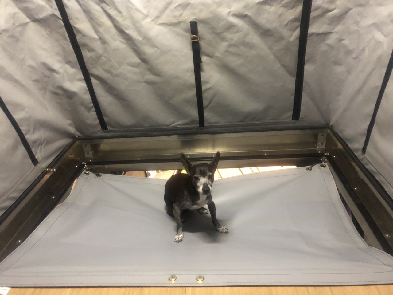

    Thanks bud. Just ordered. Gonna play with the idea with adding grommets to the center (dipping section) or toward the corners like @snwbrdr852 mentioned. Thanks gents!
    Also, I like the breathability point you mentioned about a mesh netting. That may be in the future, but I wanted something to block out light so we can try to mimic the same way we put her down at home. It's definitely going to be different, because it isn't her crib, so we're trying to make everything else as close to the routine as possible.

    the Sherpa guys were planning on releasing the rack you speak of last week but nothing yet. Prolly had a few things to iron out still.
    I have a g31 odyssey in the cubby on the passenger side back seat. I have the seat removed and have an 8020 platform that holds my fridge so I made a little shelf and battery box behind it out of 8020. Been running it like that for a little over a year with no issues minus lifting that big SOB in there when I installed it lol
    could also look at some HD Velcro? Not sure how well it would stick to the tarp tho.
    We took our little one out for her first trip last week and she slept with mom up top in a similar sleeper. I slept on the bottom bunk but next time we will both sleep up top for sure.

    My recommendation is to just put the little girl as low as possible. We actually had great success on our recent trip putting our daughter on a pack-n-play mattress on the truck bed floor. No risk of falling down there. I know that doesn't exactly solve the problem you mentioned, but it kinda does right?

    Its the night before our baby’s maiden voyage, but I got it done. Not the nicest, but it’ll do for now - it’s all temporary anyway. Thanks again @snwbrdr852 and @4wdExplorer for the ideas. Had the pup test it out for good measure
