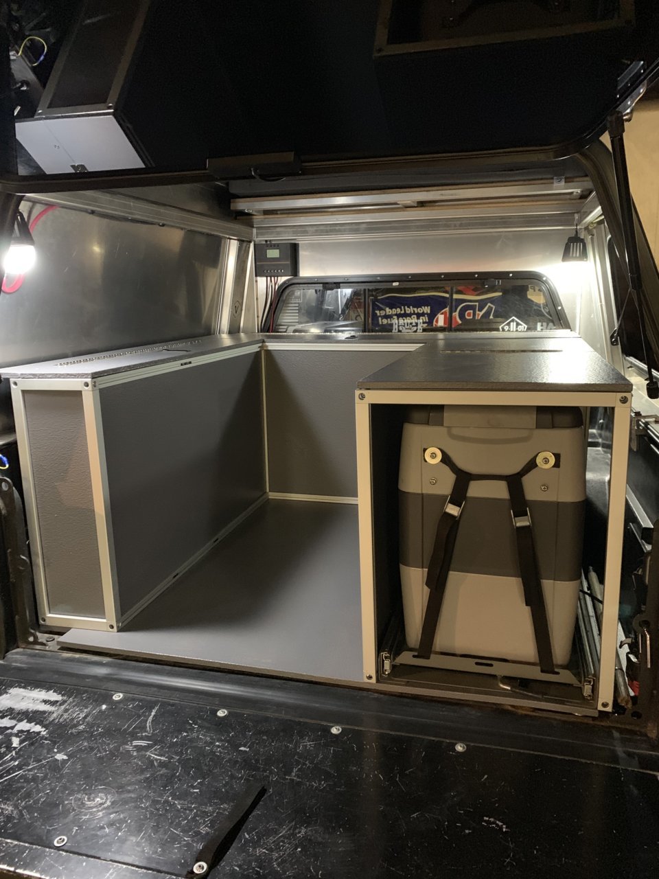

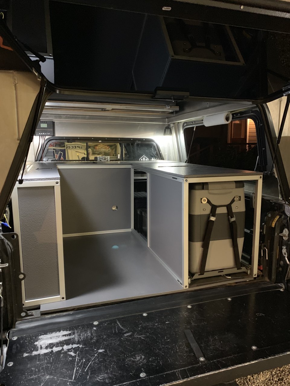

    And in regards to your questions about wood thickness i went with 1/2” birch for all tops and the baseplate. 1/4” for the verticals. It fits into the 80/20 perfectly. And used 1” for the frame.
    I also double coated everything with MonstaLiner. Not cheap but very strong.
    Couple pics for reference
