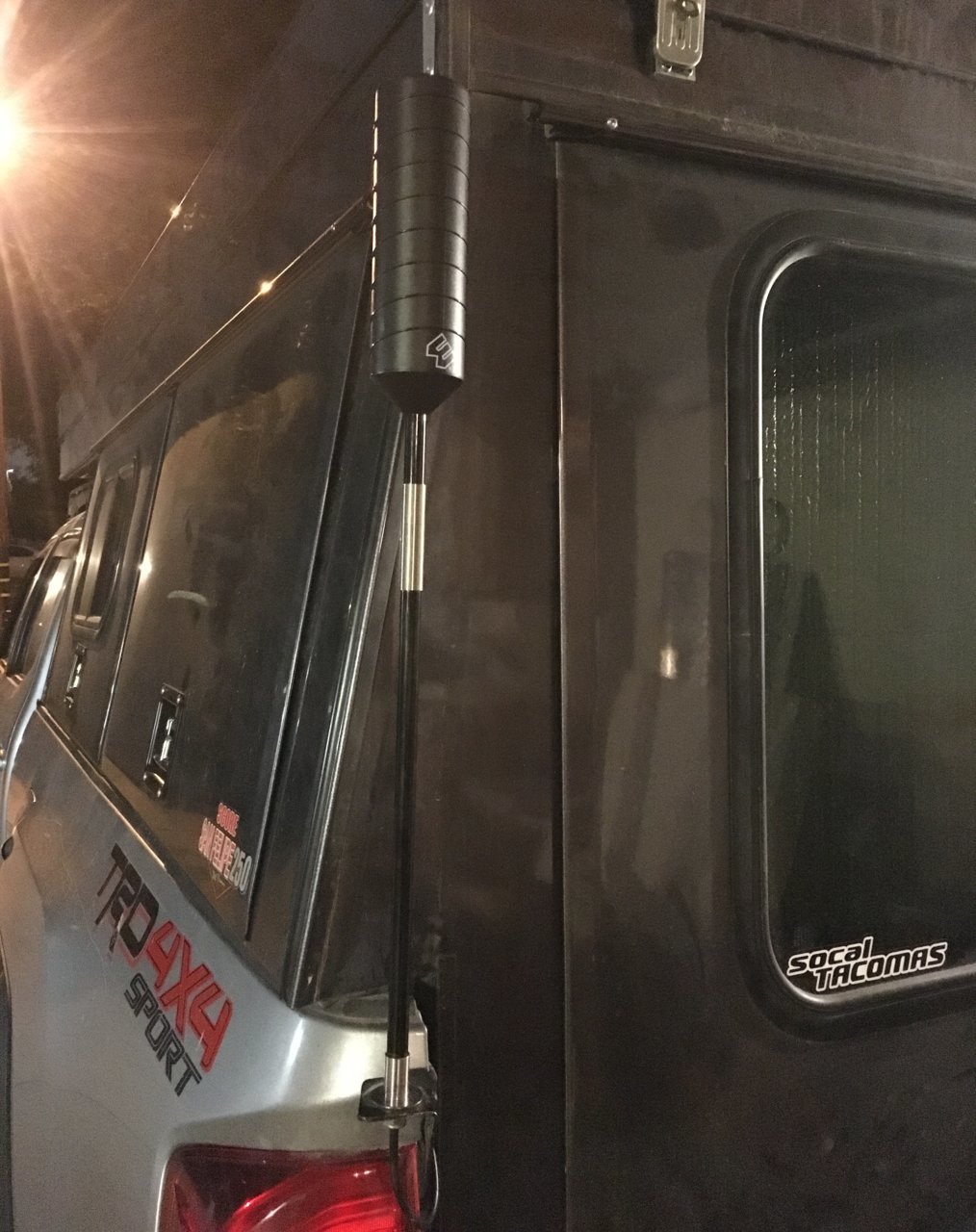

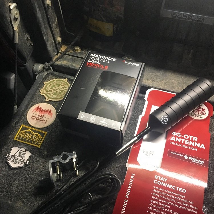

    I’ve been using the Weboost Cell Signal Booster for a few months now on trips all over the place with varying service capabilities. I finally decided on this spot to mount the antenna. This post is more for mounting location...the antenna works well even with the wall of camper in front of it!:)223D7E27-AA65-4226-B7D3-080A31B5FA14.jpg

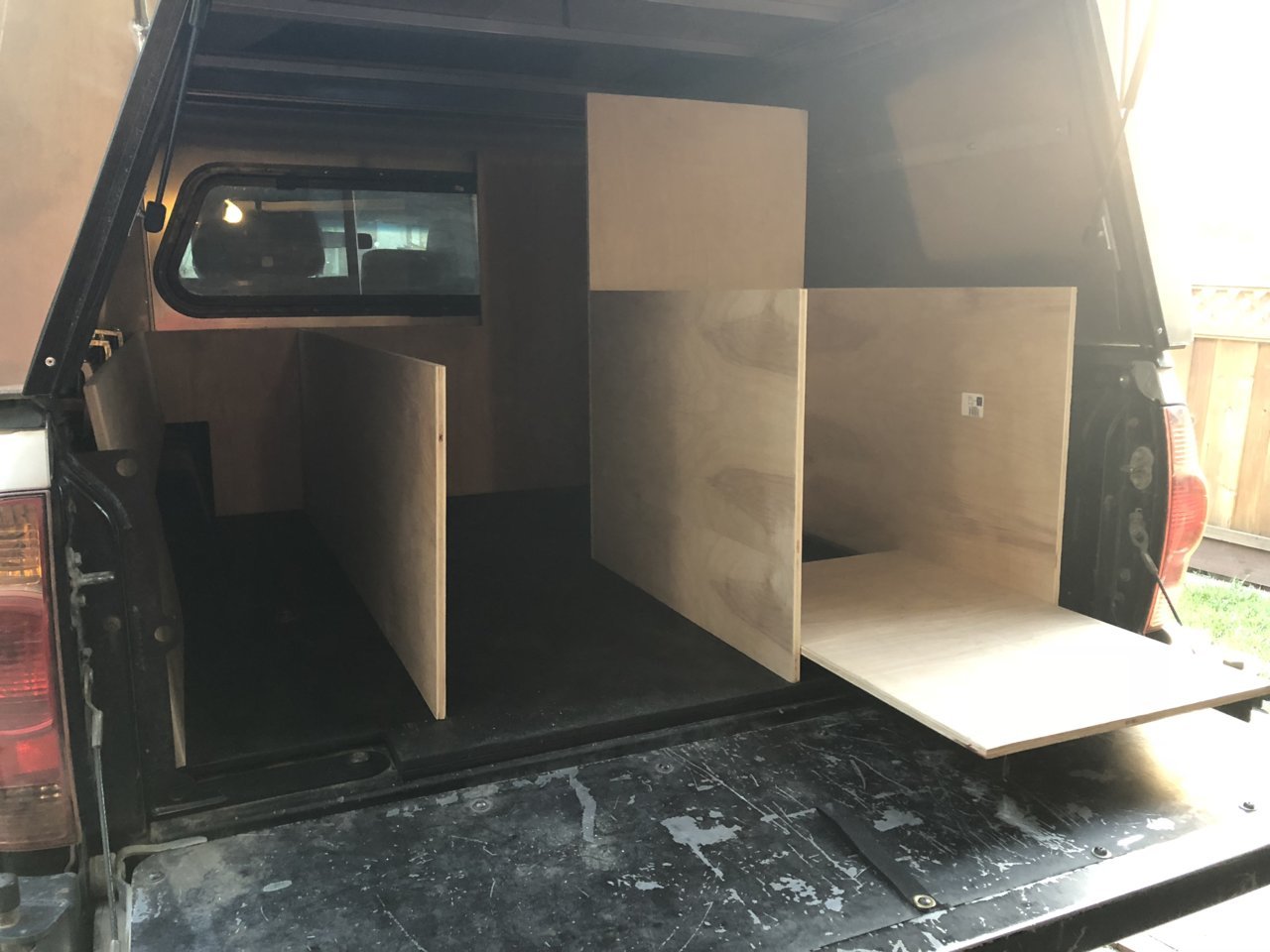

    I don’t have much done, but here is what I have so far:
    All material is 1/2" birch plywood. The base platform has roll on bedliner. (2) pull out drawers (on top of each other) will be on the driverside. Fridge slide on the passenger side with a tall cabinet behind it. Along the back wall will be the toilet and water tank.

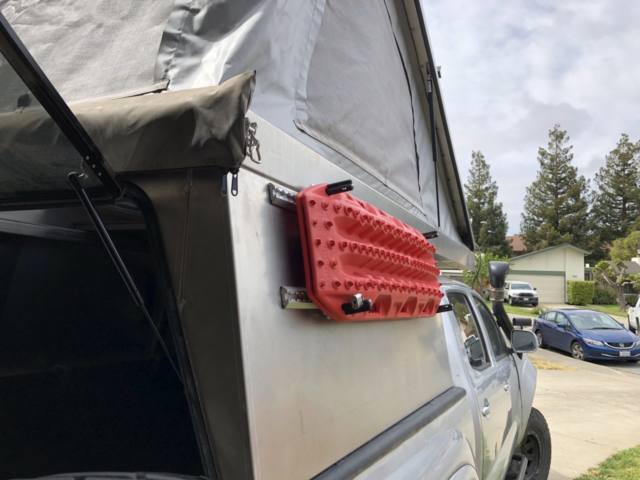

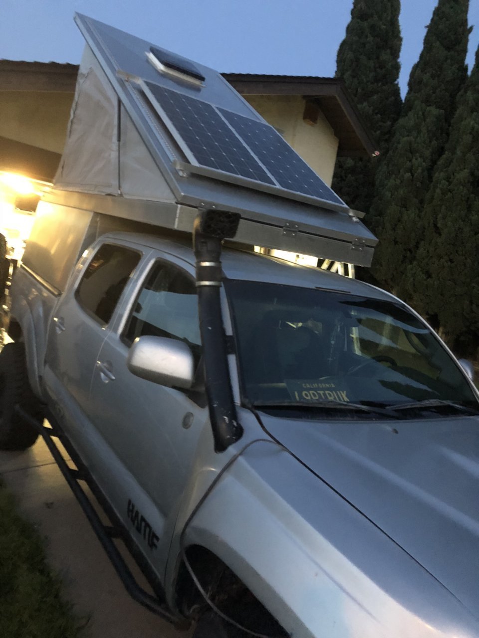

    Exterior has a couple of mods (4’ awning at the rear, L-Track on the passenger side holding the maxtrax, and (2) 100W solar panels up top)
    Hopefully will have more to come soon
