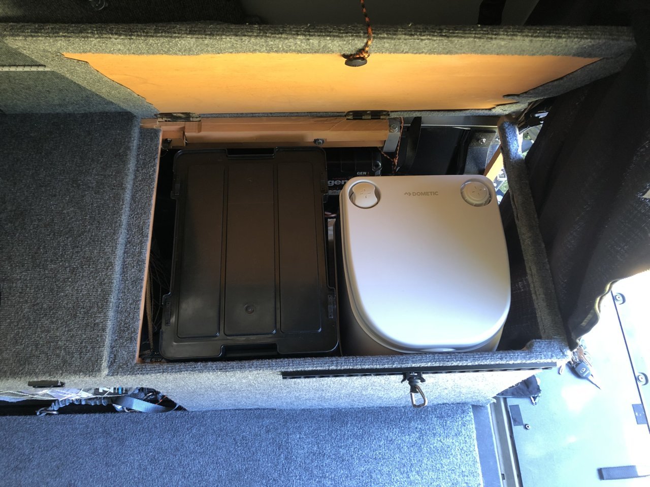

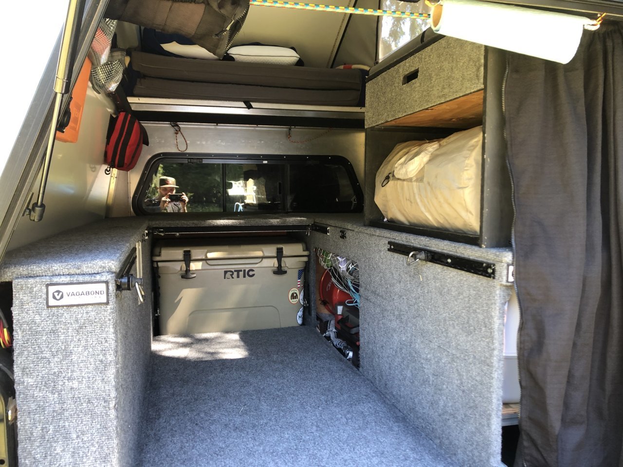

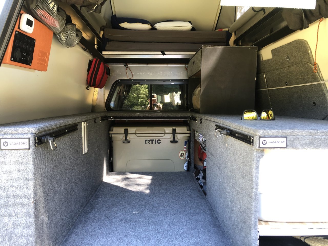

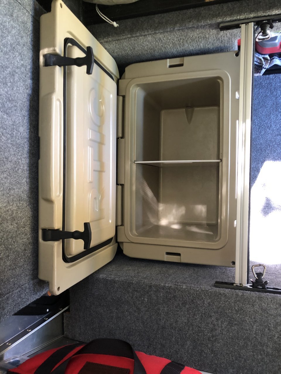

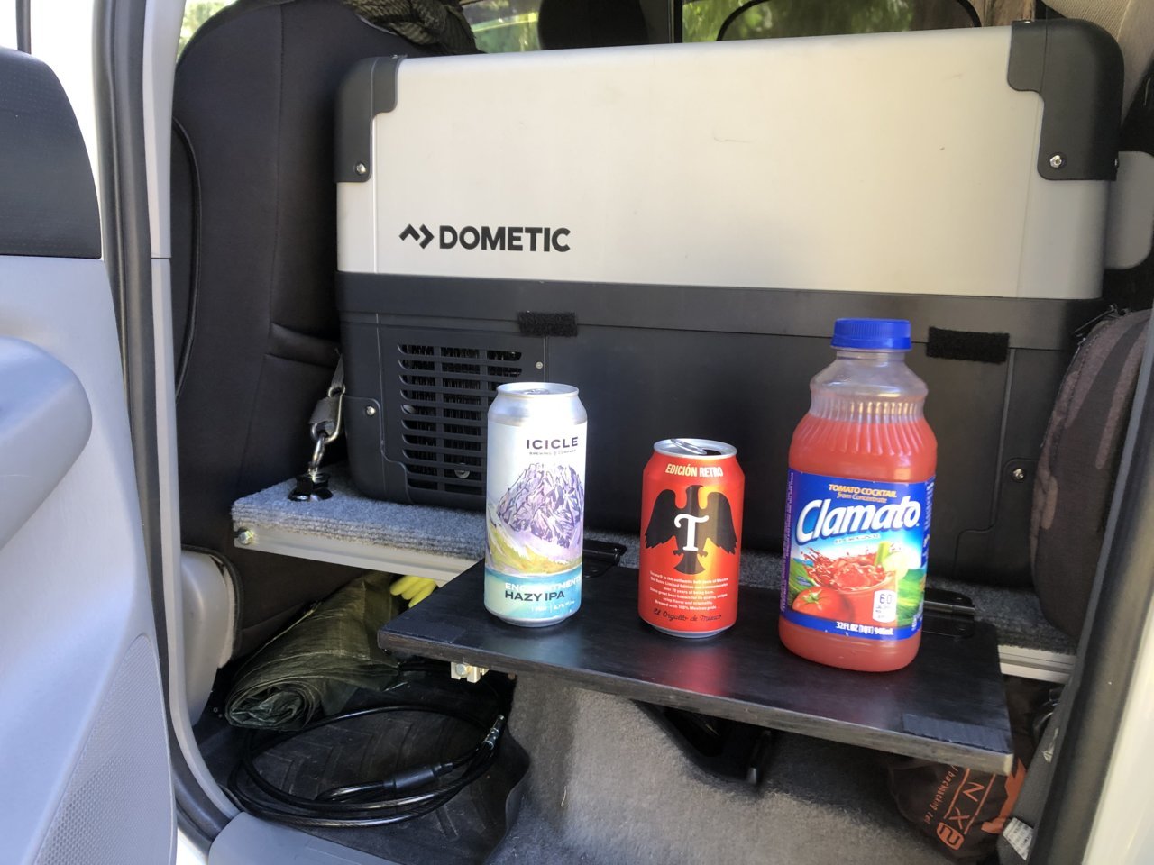

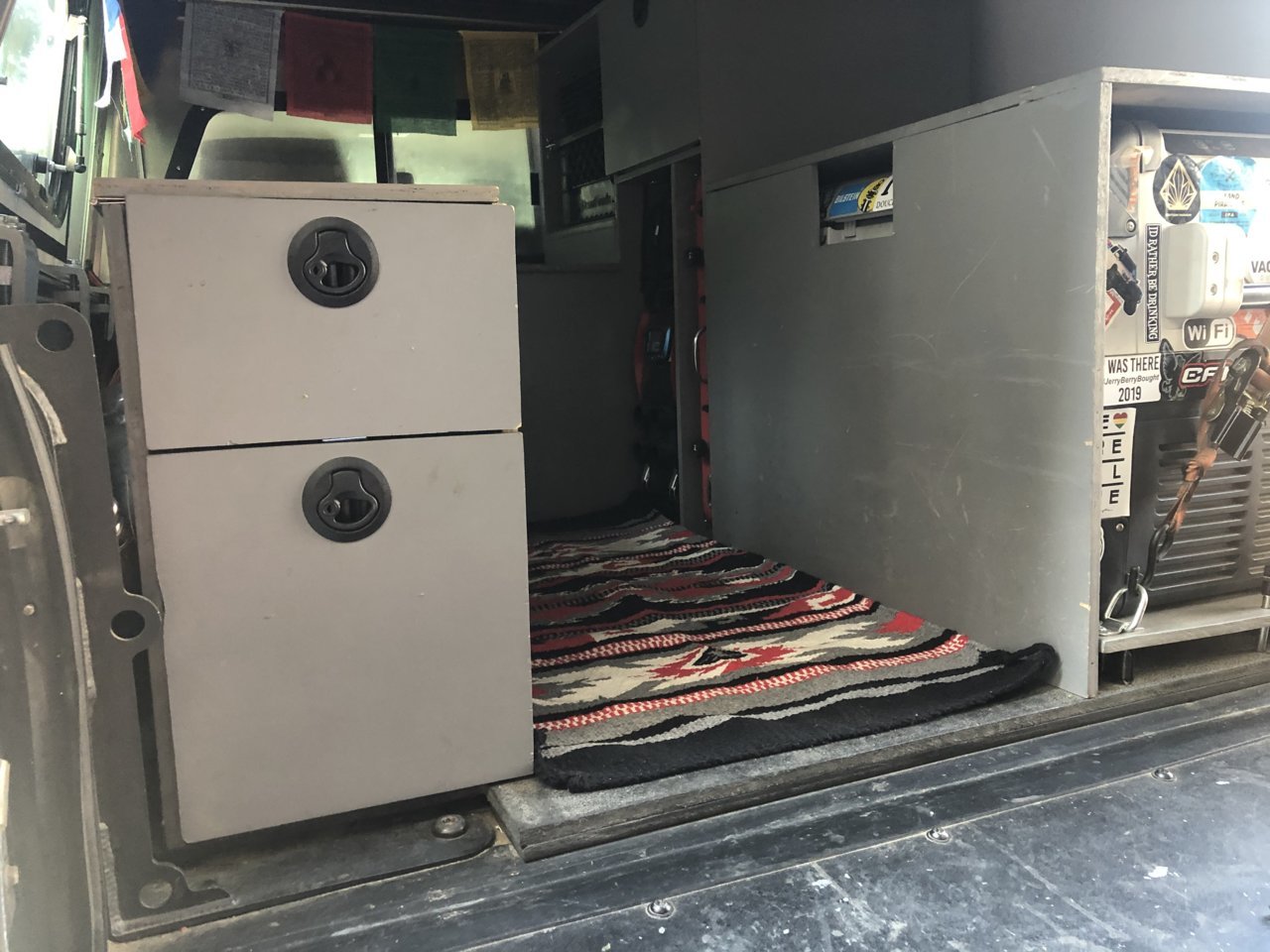

    Seeing everyone’s builds and having sone spare time lately to think had me wanting to rebuild my interior. Thankfully playing around with the current set up rejuvenated my contentment with the set up. I made it as modular as possible and this reminded me of why!
    Pulled the cooler off the slide and stick it up front with the short floor leaf in bench mode above the cooler, flips up to access. The cabinet that’s there normally get moved to the right side bench top and can be slid from the forward to the back. Standing hight table top, cook surface, or more recently a baby changing station. Whipped up a little platform to span the fridge slide area to get the toilet at “seat hight” and two front runner cub packs that normally reside in the front cabinet stack nicely next to it. Th slide becomes some what useless, but I’m sure I’ll find something to throw there.
    I considering this “summer mode” once the baby is older and sleeping on her own below, I will end up taking everything out and building a more “four wheel camper” style 8020 interior with a narrower isle and a little sink etc.
    But for now I’m still stoked lol
    2CEFDECA-8E05-415F-B710-5ACE5FC708F7.jpg 6B4D649A-DA88-484F-8B75-7CB8FA073FAA.jpg 76CB6D06-895C-4543-A5D4-2650006570D0.jpg 0C48B2B0-EE03-4DC1-A857-A505A0A36298.jpg
    My slide in the back was build to hold our fridge, Sonia will also fit where the cooler is right now but currently it resides in the cab, summer requires more storage for beverages :cheers:
