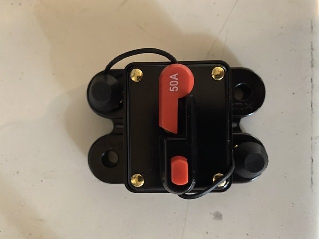

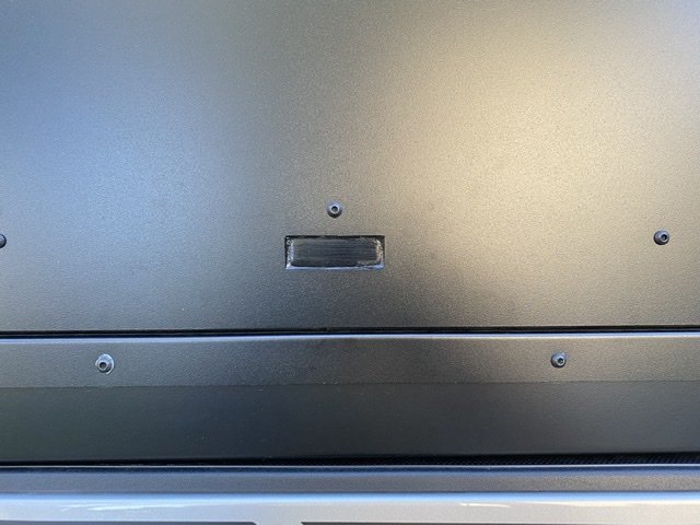

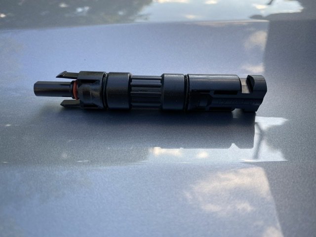

    Got the Frontrunner doors sealed today, hopefully this takes care of the water leaks!
    Also installed blocking diodes into my solar setup to prevent one solar panel from drawing current from the other one when its in shade.
    And lastly upgraded my main battery to charge controller breaker as the cheap chinese one kept tripping even when current draw was less than the rating.
