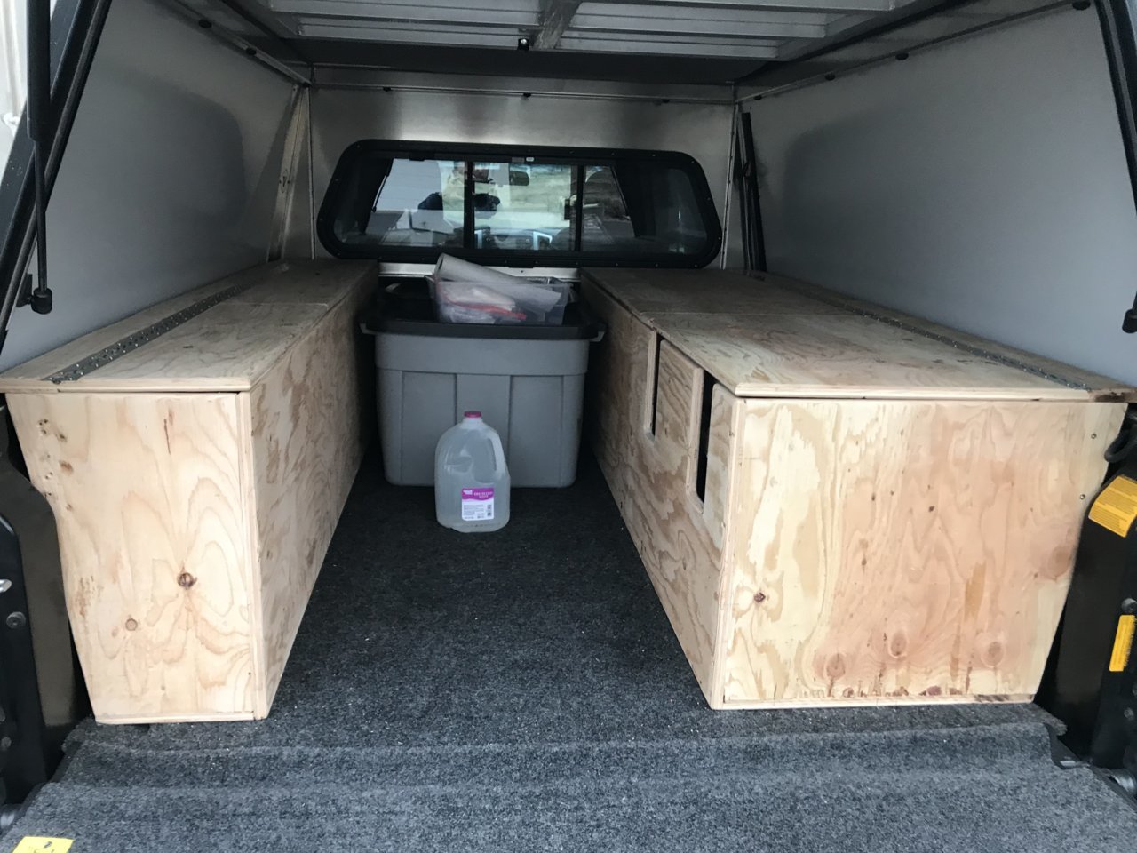

    If anyone is interested to see our second prototype build, we are headed to Utah from Washington later this week. Itinerary is listed below.
    Our first prototype was of cheap plywood. The second is of 1/2” Baltic Birch that looks really nice and is quite light. Unfortunately, it has already warped in a couple key places. So there will be a final prototype at some point. I have a busy that is a cabinet maker, and he has given me some great ideas and helped me get a high quality build.
    It would be great to meet anyone along the way and get ideas for our build.

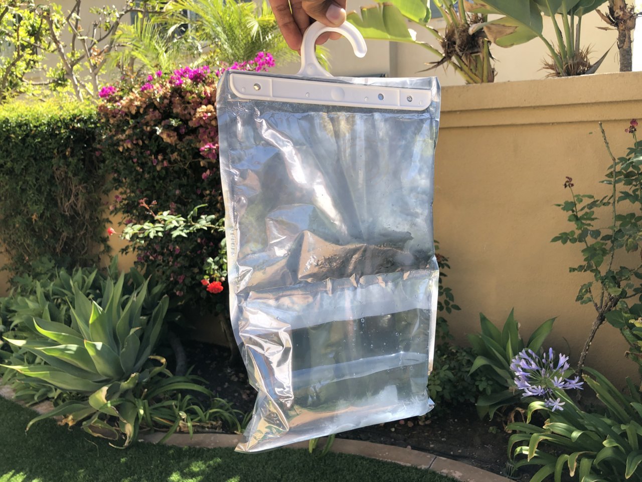

    I always keep a Damp Rid thingy hanging in the camper. Bought it before a month long trip and had no idea if it worked...
    2 months later and this is the amount of moisture it’s collected! Just swapped it out for a new bag.

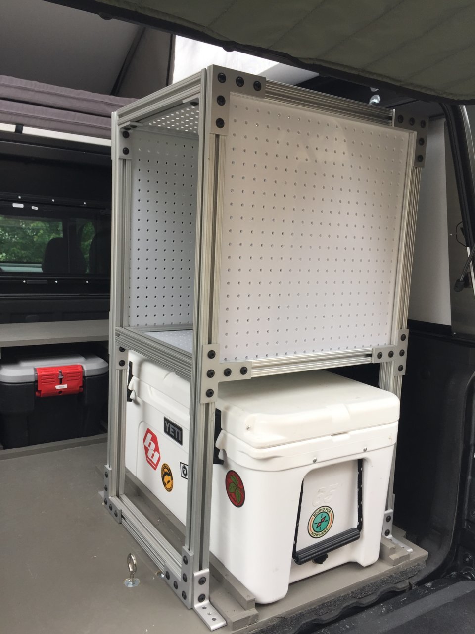

    I used 1 1/2" from 80/20 for a rack in my build and honestly I think I would have been fine with 1". I have a horizontal cross bar that acts as a step to climb up into the bed. It has worked out great. I added plastic pegboard that I got from U-Line for sides and top inserted into the extruded aluminum channel and so far I am very happy with it. The pegboard gives me some options on mounting and secruing some things and the top of the rack works as a nightstand/work area if needed. I think you can save some money and go with the 1".
