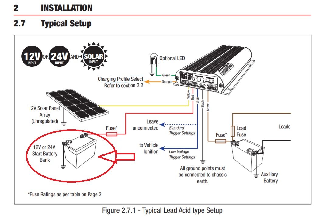

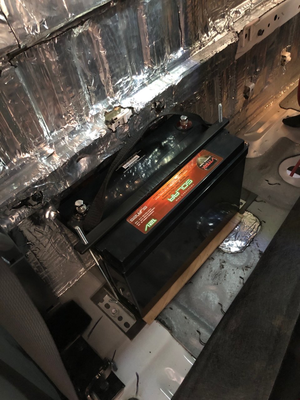

    I am in the process intalling my Redarc DC to DC charger. Do I need make a full run of the negative wire from Starter battery to the Auxillary battery? I am just thinking of making a chassis ground for Auxillary battery? Is this okay to do?
    Looking at the Redarc Instructions on page 11. It dispays a chassis ground at the Auxillary battery in the diagram. When searching I see some people making a full length ground wire run from starter battery to auxillary battery.
    Personally I think it is okay to make a chassis ground if I sand off all the paint of the metal surface where I attach the ground cable to.
    Here is a diagram. I circled the the area of concern in a red circle.
    For the power wire going to the bed I will definately make a chassis ground near the bed.
    Wackyhacky likes this.

    MJonaGS32
    MJonaGS32 MJ on a GS
    Apr 14, 2009
    #15949
    12,409
    MJ
    SF Bay Area (East)
    07 LT 4x4 DCSB 6spd Vagabond
    Drifter wedge camper, Dual battery, OBA, ARB locker, 4.56 gears
    It’s probably OK, but if you’re planning on hooking up a lot to the aux battery, I would connect the negatives in addition to grounding the chassis.
    Look up “Big 3 Upgrade” to get a better explanation about how the ground is important
    4wdExplorer[QUOTED] likes this.

    I've got a BCDC1240D and I just grounded mine to the frame.
    Though I did make sure it was overdone - cables were doubled compared to my actual charging/load requirements, and paint completely removed from the frame at the connection point.

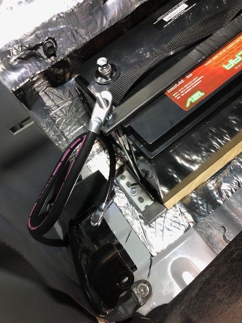

  13. Aug 12, 2020 at 10:06 AM
    #4073
    4wdExplorer
    4wdExplorer Well-Known Member
    Dec 31, 2009
    #28499
    1,079
    Orange County, CA
    I definitely understand how a good ground is important.
    I used a 1AWG ground cable I had laying around and grounded it to the rear seat bracket. I removed the bracket and grinded off the paint of both sides and the body as well. Maybe I will go the extra measure and route another ground cable directly to the frame as well so I have both chassis and frame grounds.
    Power wires are 6AWG which was more than enough using the bluesea calcuator (bluesea said 8awg but went one size bigger).
    Pic of ground cable.
    MJonaGS32[QUOTED] likes this.

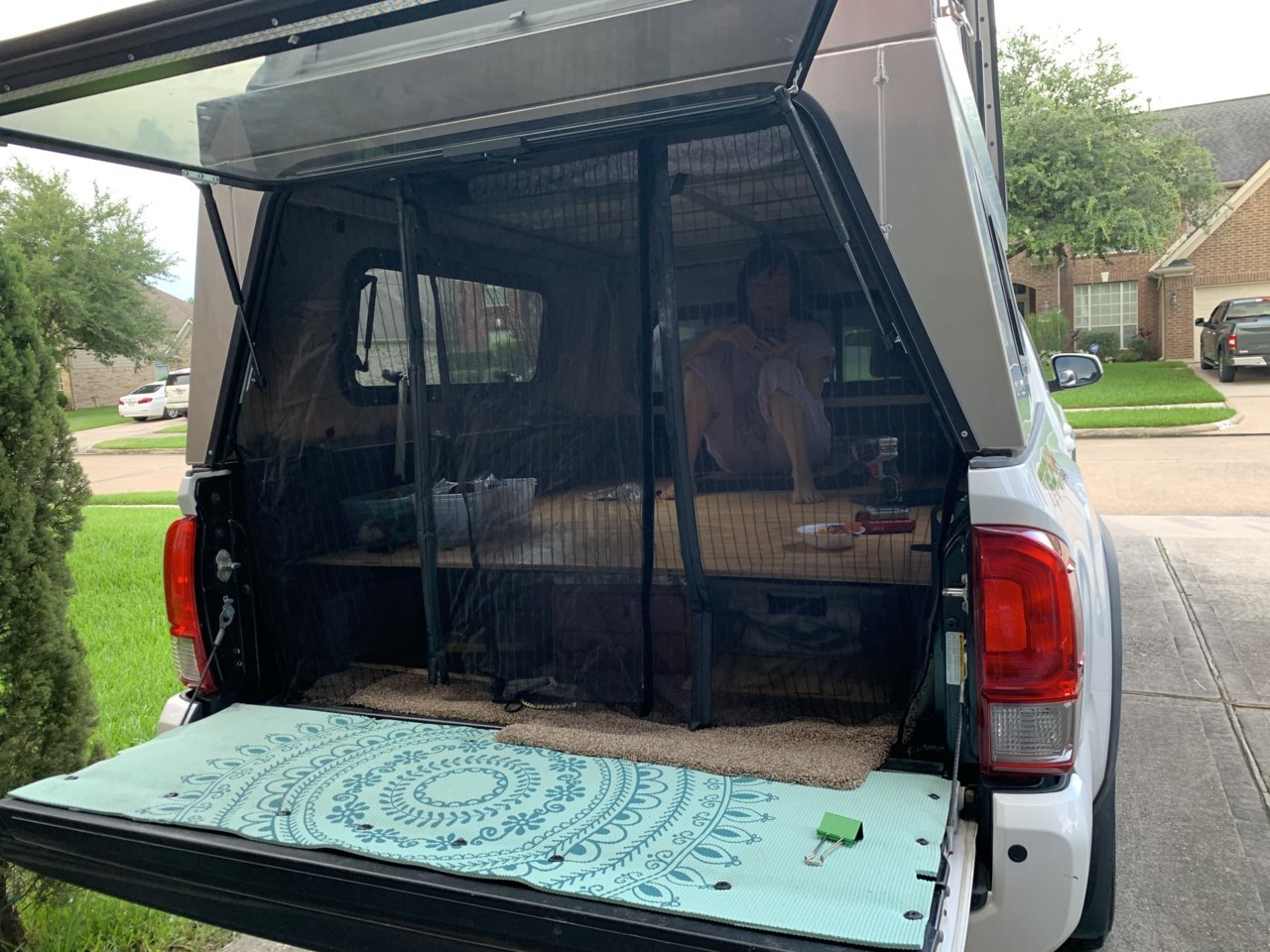

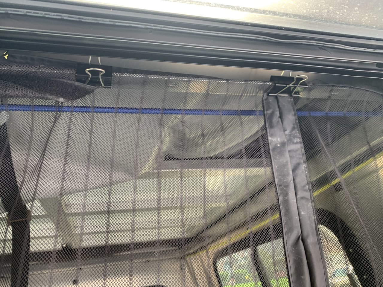

    Hi Vagabond family! Just wanted to share :cheers:
    A few weeks ago I installed a very simple mosquito net using an existing one I got from Amazon that just velcroed to the doorway of my house.
    I cut it in half horizontally and then attached it to the drifter using binder clips plus Velcro!
    They overlap a little bit in the middle but it’s not a big deal (you also get a magnet less entry). It tucks away into that little space on the top for the wires.
    Very convenient and easy install. Not perfect, but worked well last weekend. :) Happy camping!
