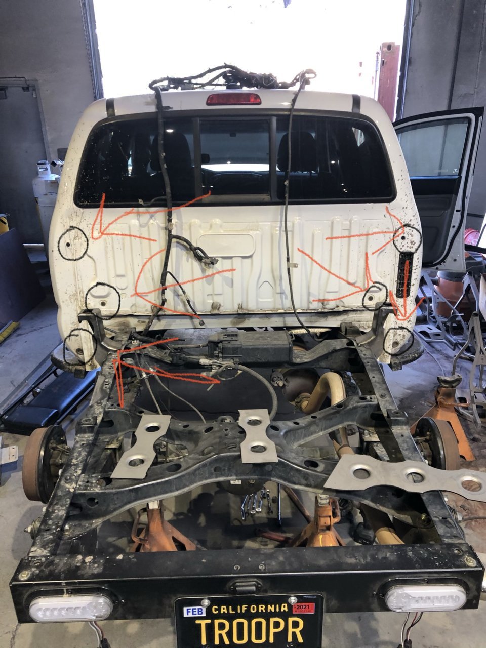

    Ok so - my power source is going to be in the rear seat area of the truck. For those with a similar setup - where are you running cables? To the spot under the drivers seat? I thought there may have been a penetration in the rear wall?
  17. Aug 12, 2020 at 8:28 PM
    #4097
    Anderson
    Anderson Dudemanbro
    May 21, 2014
    #130329
    3,629
    Anderson
    Benicia, CA
    ProBro
    Stuff
    There are several locations all over the cab that you can use. The rear outermost corners of the cab have very large pass through grommets.
    I attached a super descriptive photo for your perusal:
