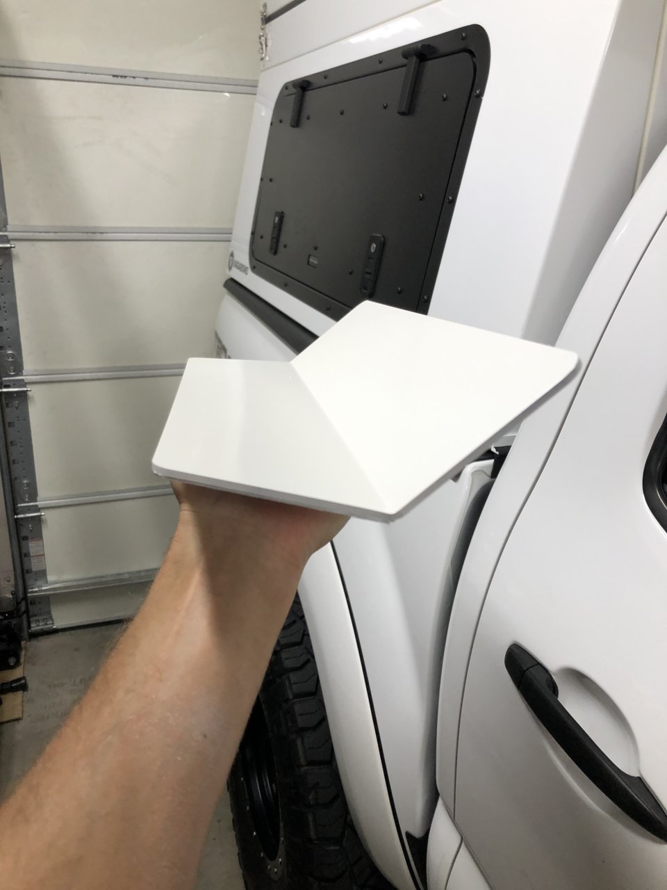

    Painted the wind deflector white to match the Drifter and will install tomorrow once the paint fully cures.

    I gotta do that for my white roof as well. Was it screwed on or riveted?

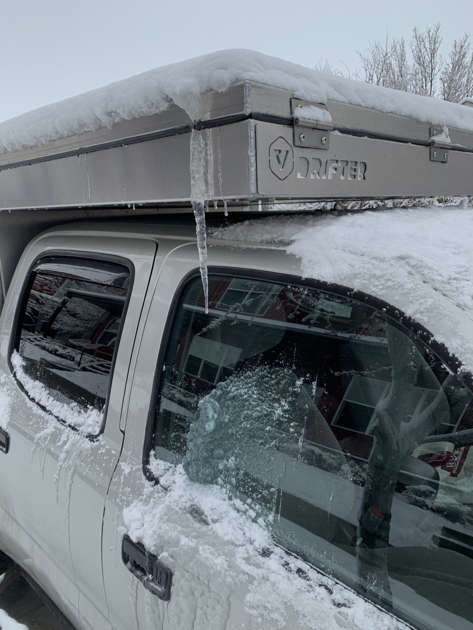

    One thing I have noticed with the uncoated is that when it rains or snow melts, the dripping onto my driver windows is leaving a film from the aluminum oxidizing.

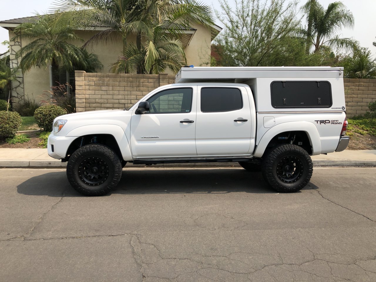

    Today I installed an extra AAL to my HD OME Dakars. I gained about 1 1/4" in the rear. I am .5" higher on the drivers side which is odd, since the gas tank is on that side. I noticed the passenger front is lower than my driver front also. I think once I raise the passenger front little bit the rear passenger should go down, I think.
    I do not have anything in the bed, probably wont do a bed build out yet since I want to use my truck as a truck still.
    Here is a picture of my Tacoma, bed empty with HD OME + another AAL making them Heavy Heavy OME Dakars.

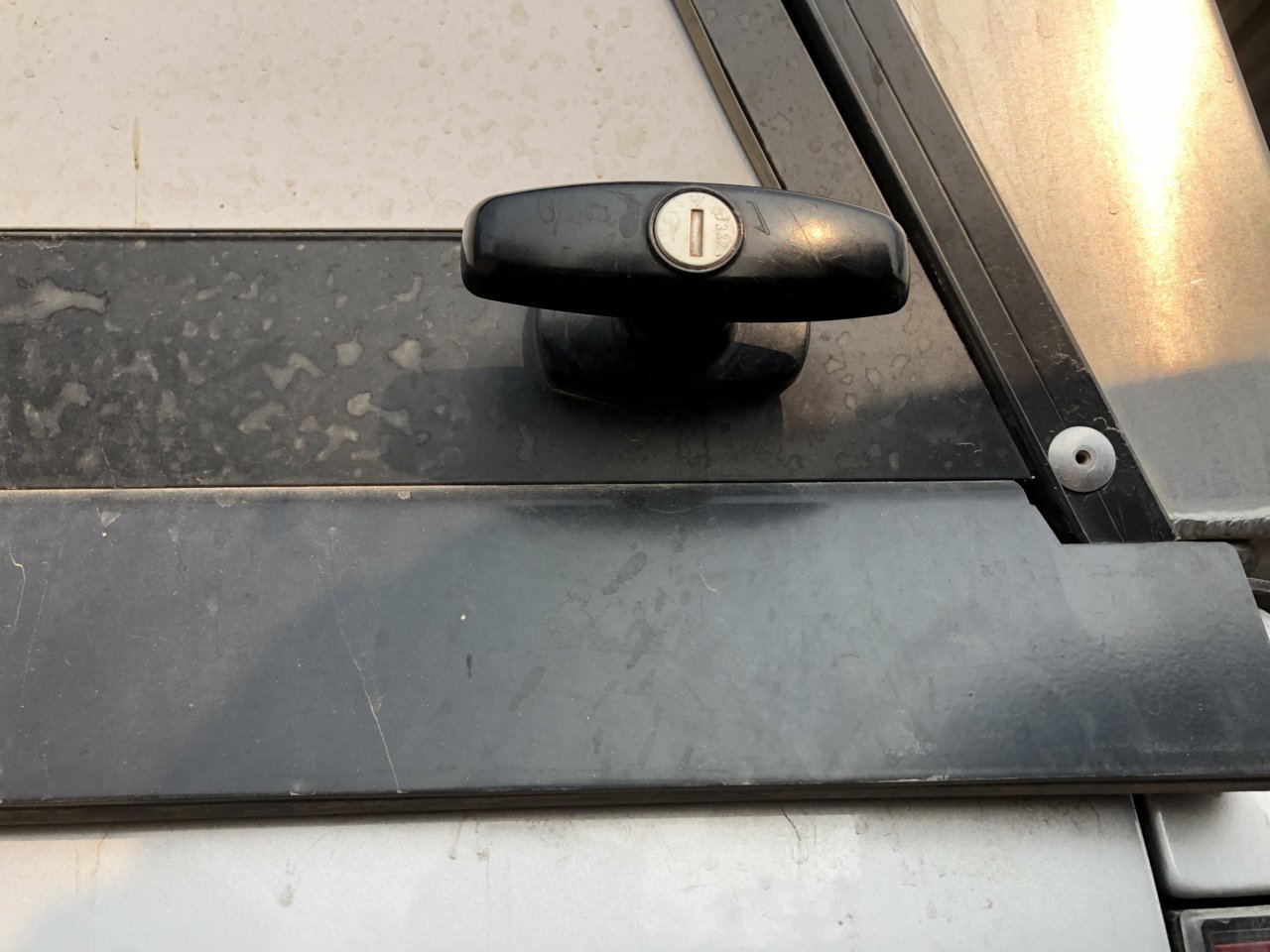

    anyone know what brand the handles are on the rear door? i need to get a key (havent had one) but just want to be sure the brand is correct

    I forgot to ask Phil...
    Mea Culpa.
    I’ll talk to him tomorrow.

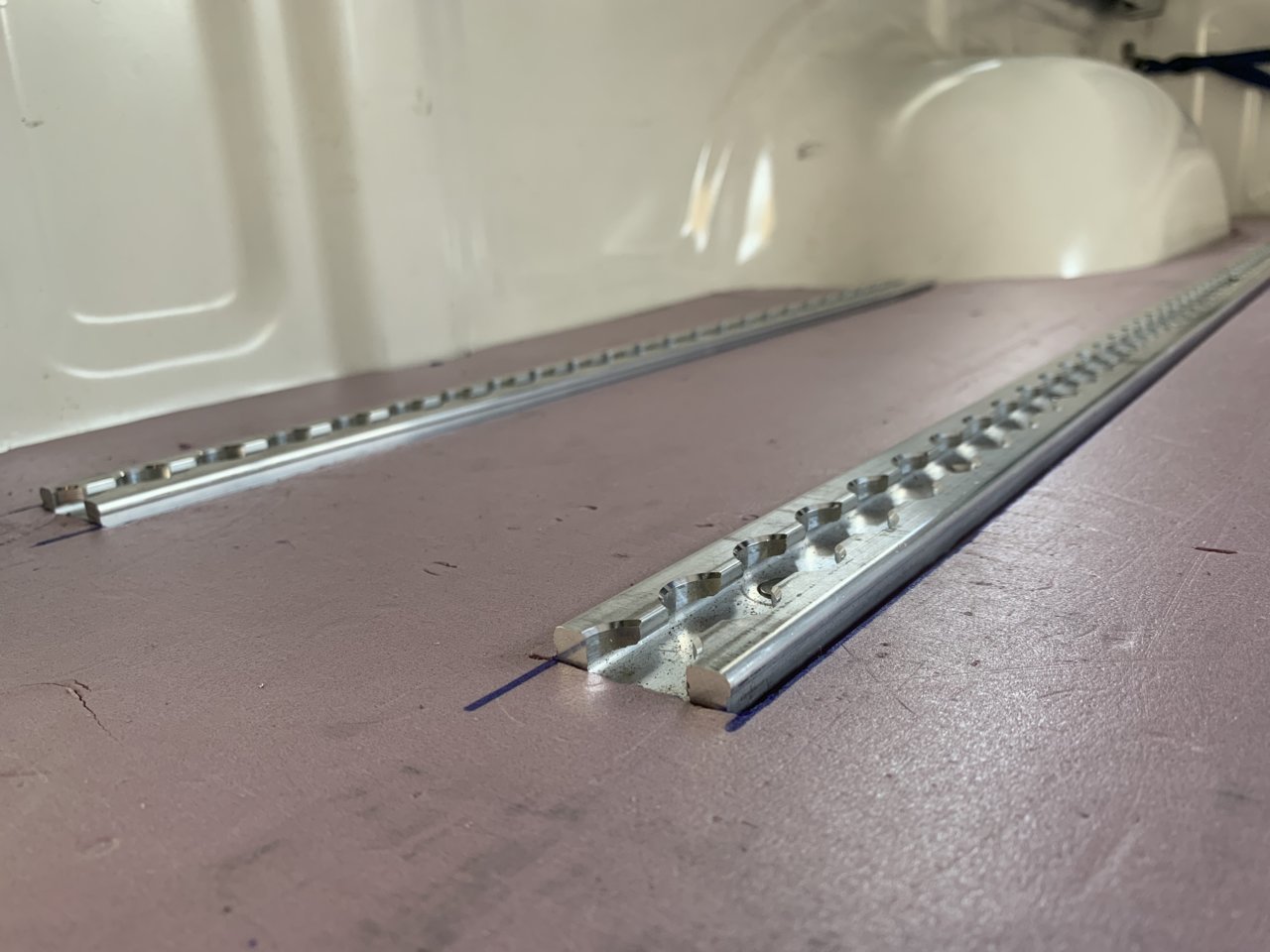

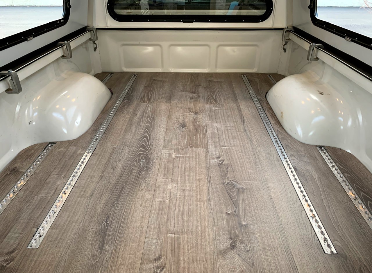

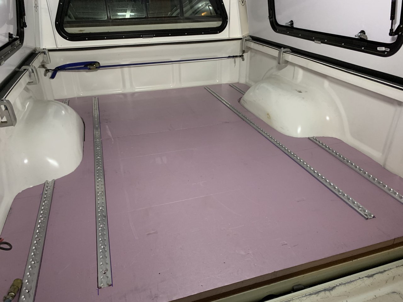

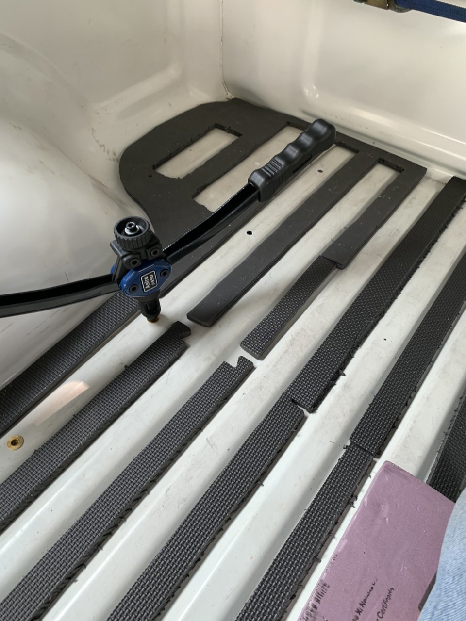

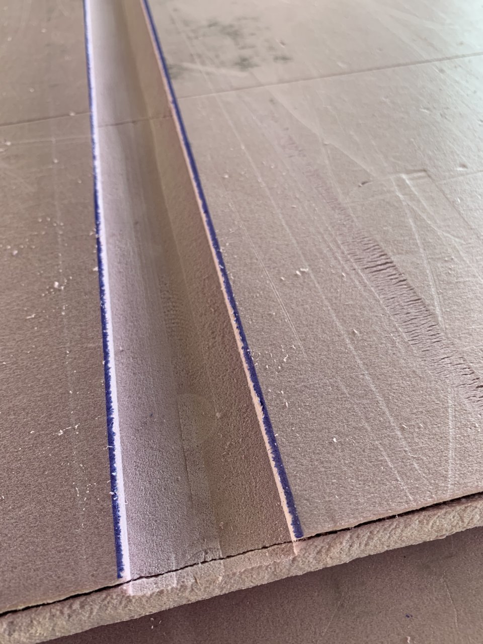

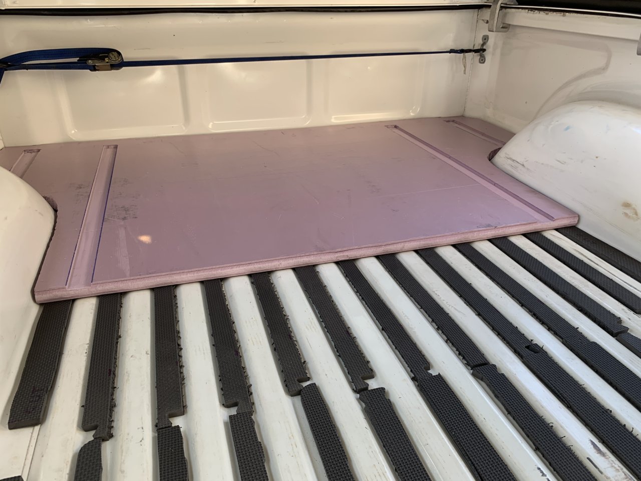

    I'm finally starting the interior build with a floor. It's a few layers, using in-fill (gym mat) for the sheet metal corrugations, then 1" Foamular XPS board. The XPS is rated a 15psi. I milled channels into the foam to accept aluminum L-track. I milled it so the height of L-track is flush with the finish-layer, which is vinyl planks. The L-track is fastened through the XPS into the higher corrugations of sheet metal using plus nuts and 1/4-20 SS screws. I used PL300 adhesive to put the planks down on the XPS. I still need to finish caulking and adding a finished 90-degree edge to the rear of the floor where the tailgate is. The walls will also get 1" foam, and finished with white FRP sheet. The L-track will provide the mounting surface for the rest of the interior build, and allow the pieces to be removed or moved around in the future.

    Bauer Products?
    I purchased their covers. Not so much for dust but rather for lock freeze ups. That was on my topper. They helped a lot in winter. I haven’t checked yet but think the Drifter handles might be a different size. TBD.

    FYI - You do not want to breathe in the dust from this pink insulation. The flame retardants and other stuff in them are pretty bad for you to hang out in your lungs.
    Great idea with the construction though! This is much lighter than the typical marine plywood base coated in more weight of a bedliner. I will likely go the route like this to stay as lightweight as possible. Please keep us updated to how it holds up.
