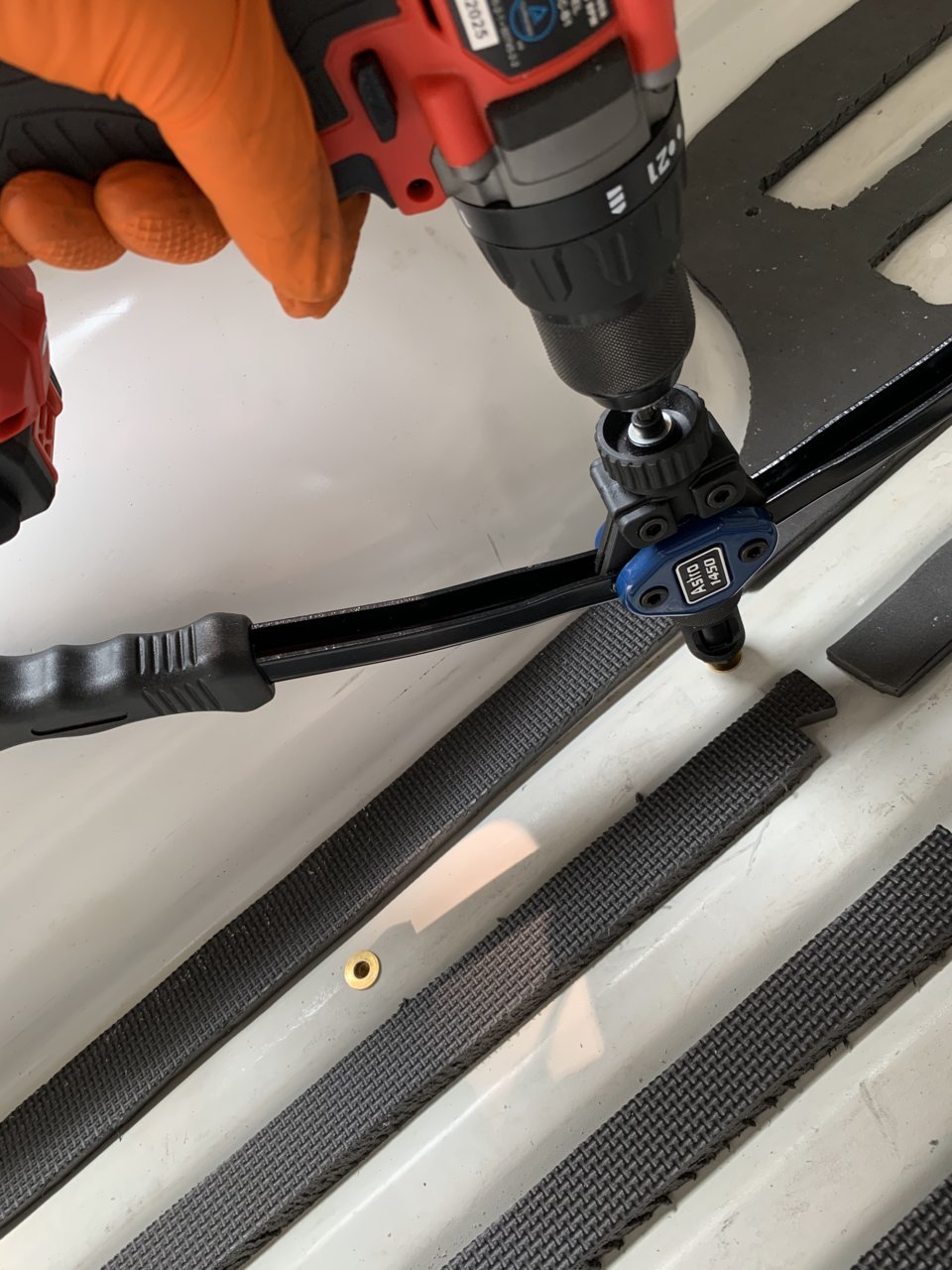

    Thanks. Yes, I agree on the hazard... I wore a pro-grade respirator. I was hoping to keep the weight low by using the foam, but the luxury vinyl planks are heavy. So, that's where the weight is... about 45 lbs. worth (figuring 27 sq ft). With the rest of the materials I calculated a total of approximately 63 lbs.

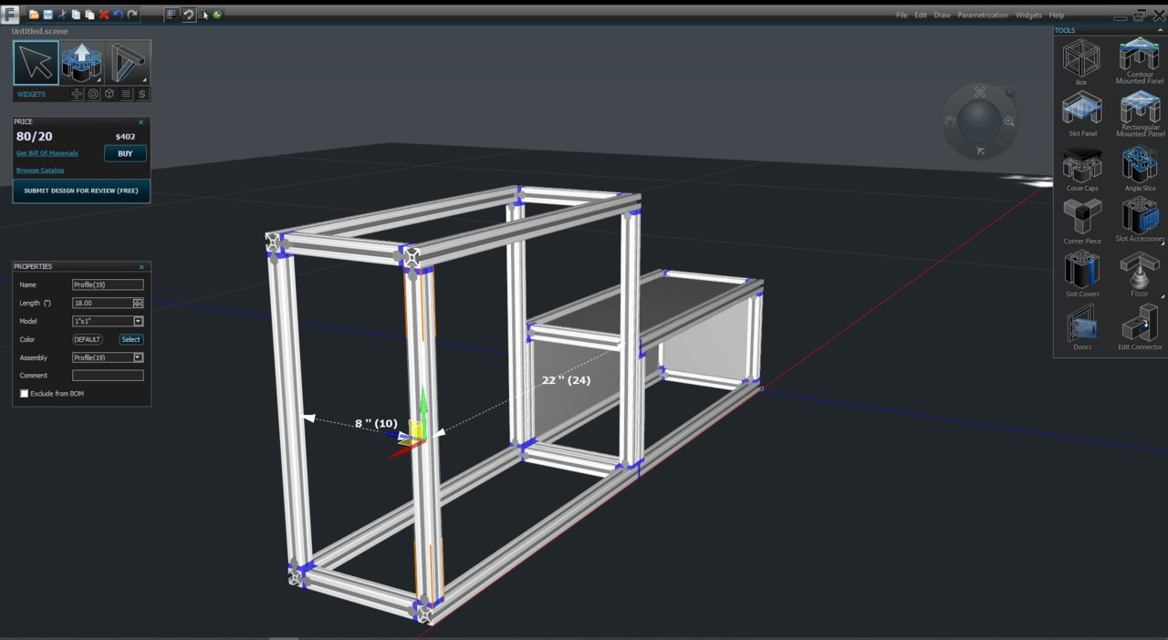

    Thanks. Actually, my intention with the double-row L-track down both sides is to allow for pretty much any mounting configuration, so it will be adjustable and allow me to change things if I need to. If you imagine 80/20 or T-slot extrusions fastened perpendicular to the L-track, they can slide along the base to any dimension from front to back. I do plan to build cabinets and storage; I have been working on modeling it in 3D, which is really helpful for revealing problem spots where things need to be adjusted or moved. (I'm using Google SketchUp online.)

    hows the rivnut tool worked out for you? Ive been striking out on PoS brands. Was debating this one but it was the pricier of the bunch. Also was recommended the Rough Country one but it seems to b the same POS that other Amazon sellers have.

    It worked pretty well and is fast. I bought it specifically for this project and set 30 nuts with it; of those, I had to fix the threads on 4 of them using a tap. I don't know for sure if it was the tool or the SS screws that caused the problems. One thing I found with this tool was that I could use a cordless drill with a hex bit to zip out the threaded stud from the fastener once it was set. That made it really fast.

    If you haven't already check out frame designer. It's an old application that isn't really being updated ( unfortunately ) but it's pretty bad ass for modeling these aluminum extrusions
    https://www.framexpert.com/products/framedesigner/download/

    Definitely save often because certain actions can it to crash but it's pretty cool. It even has a cost calculator for 80/20 and it can print out a bill of materials. I'm sure the cost is off because it hasn't been updated so I'm not entirely sure how helpful it is for that, but cool none the less. See attached PDF for an example of the build out from the screen shot above
