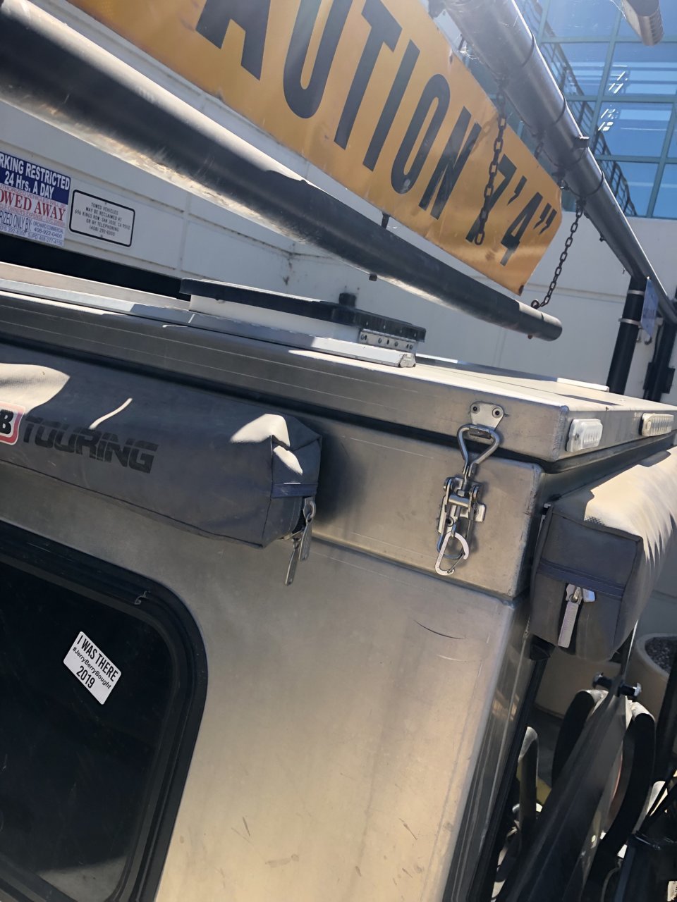

    Anyone have photos of how the ARB 1250mm ("4 foot") awning is attached to the rear of the Drifter?
    I just picked one up that is missing the rear extrusion on the outside of the bag/cover and thinking through some ideas of how I want to mount it up without quick release brackets.

    You can kind of see it here
    And here’s the view from the inside where you can see how I used aluminum flat bar (2 pieces)
    huruta, CrashN'Burn, tacomgee and 7 others like this.
