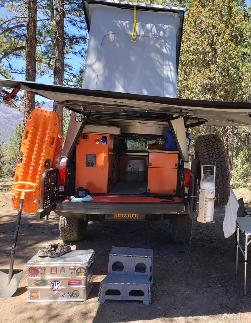

    Thought about making a hook of sorts that would allow the bed to pop up like this when the roof is deployed. not by necessity more just... because I was bored I guess lol. Only problem is the bed platform is wider than the upper most interior rail so you would have to get pretty creative to make a new platform and surface for it to rest on.
    OOO that's pretty slick! we leave our rear curtains down but takes away what little view I have out the back window driving. This is a cool solution!

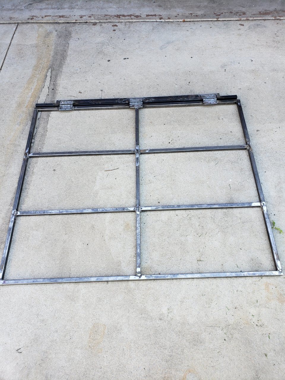

    Well I'm going to try my idea, tilt up bed panel with gas struts like a couple of the other brands do. I've started with a 3/4 steel tube frame. 47 ³/⁴ x 40 ". I'm using a angle iron to weld the hinges to the frame and the angle iron. The angle iron will get 6 holes drilled and spaced evenly, and this will then bolt to the camper edge. There is enough space where I can drill through the camper and use some flat stock below as extra support. More pictures coming soon.

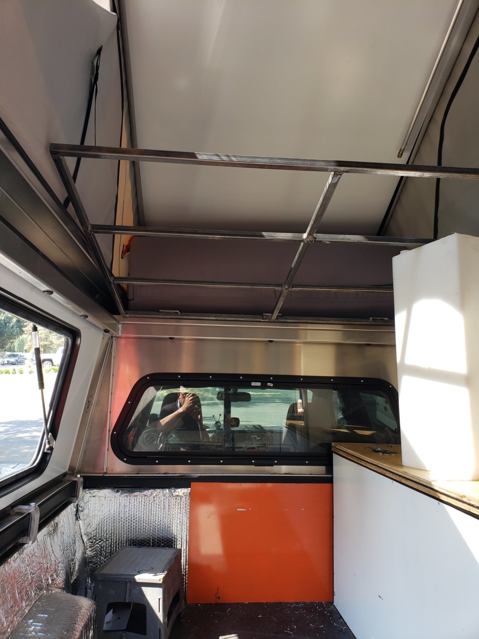

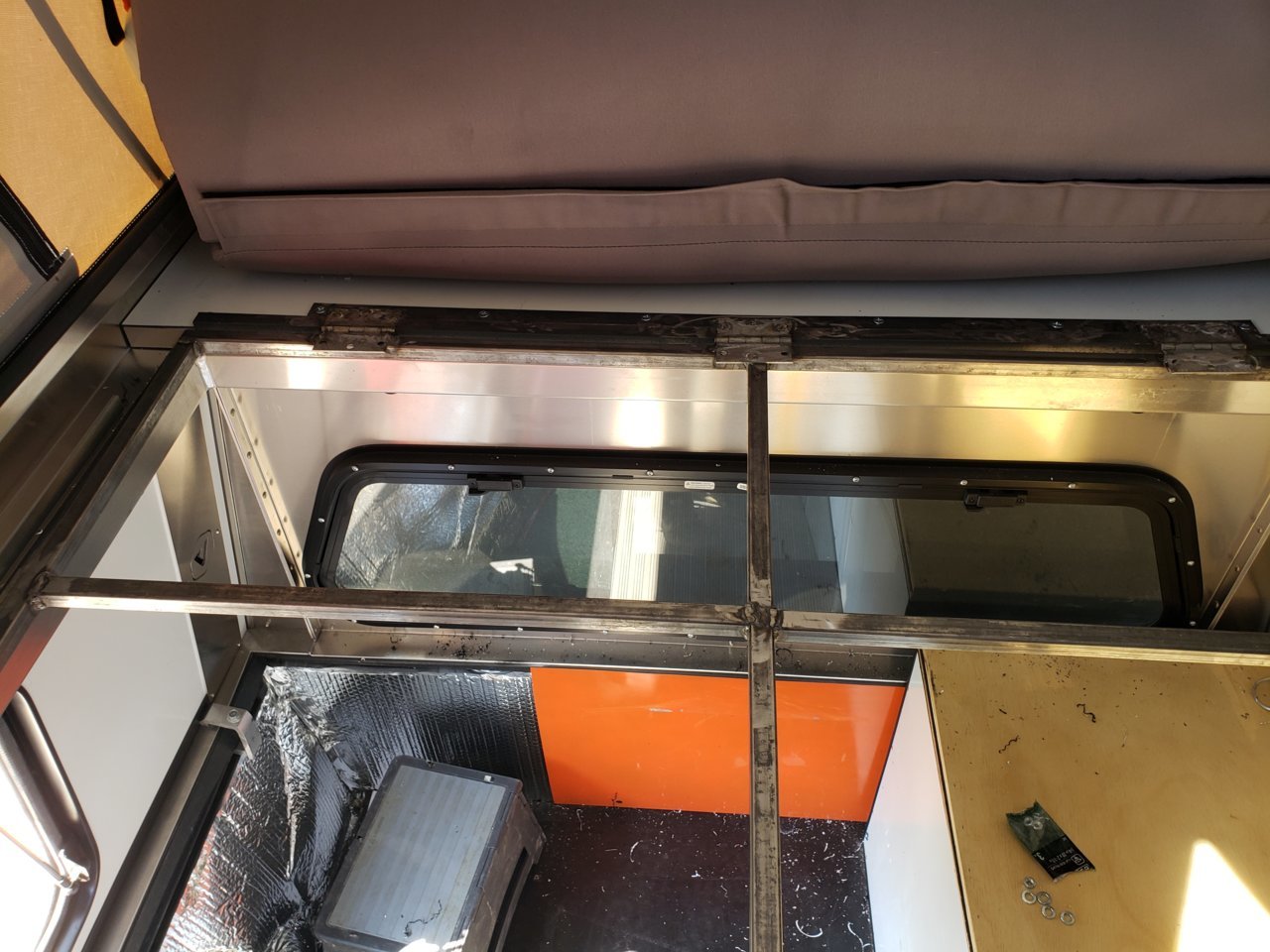

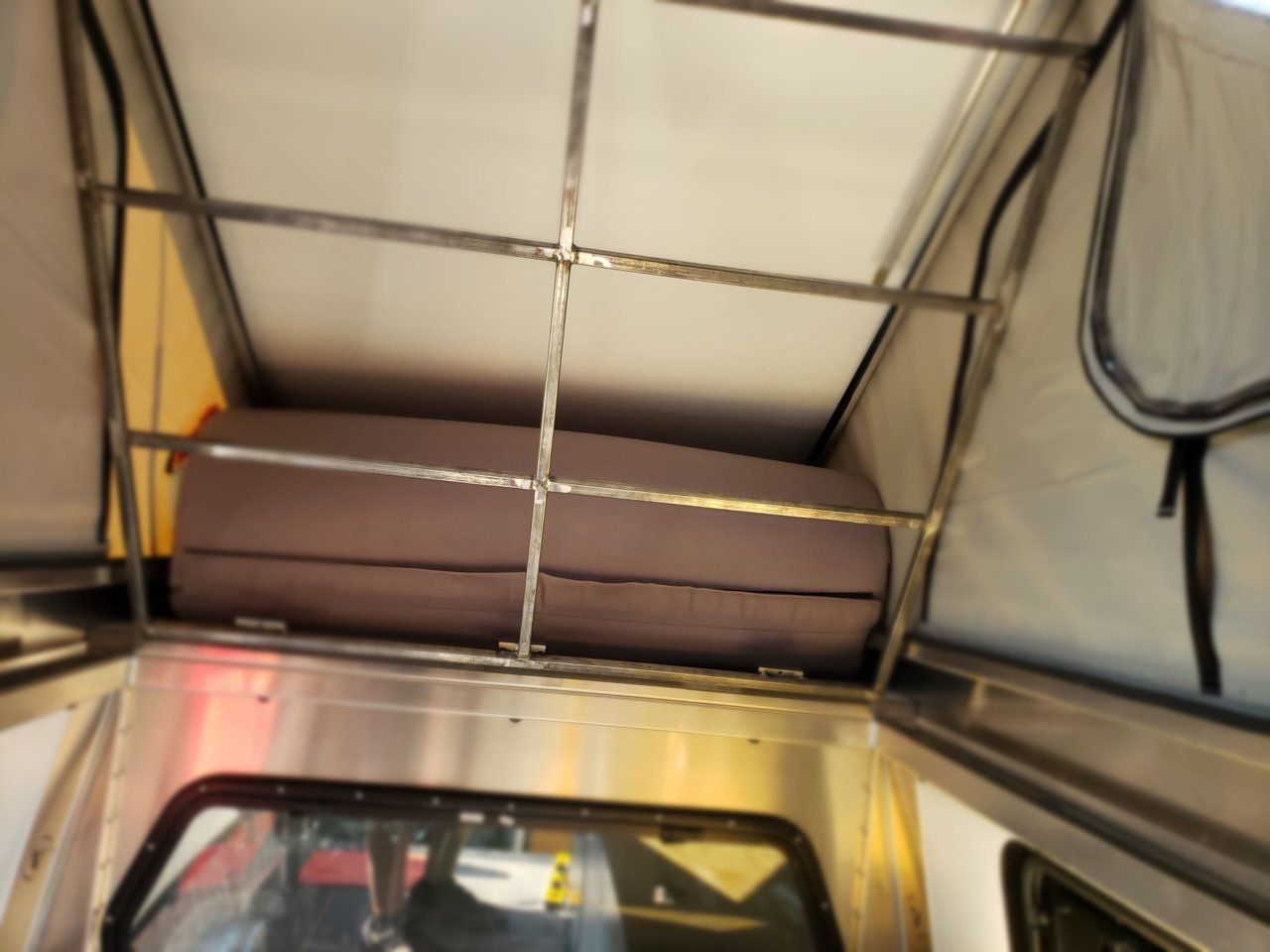

    So I started with a cardboard mockup to see how far the lifting bed panel would go before touching the roof, then went ahead and made the frame.
    I can still stand up in most of the bed, just the last foot towards the cab I need to duck a little. I'd say not a bad trade off for the very quick deploy of the bed just like the camper top. I will be installing the gas struts during the week (waiting for Amazon delivery) then I'll post a few more pictures.
