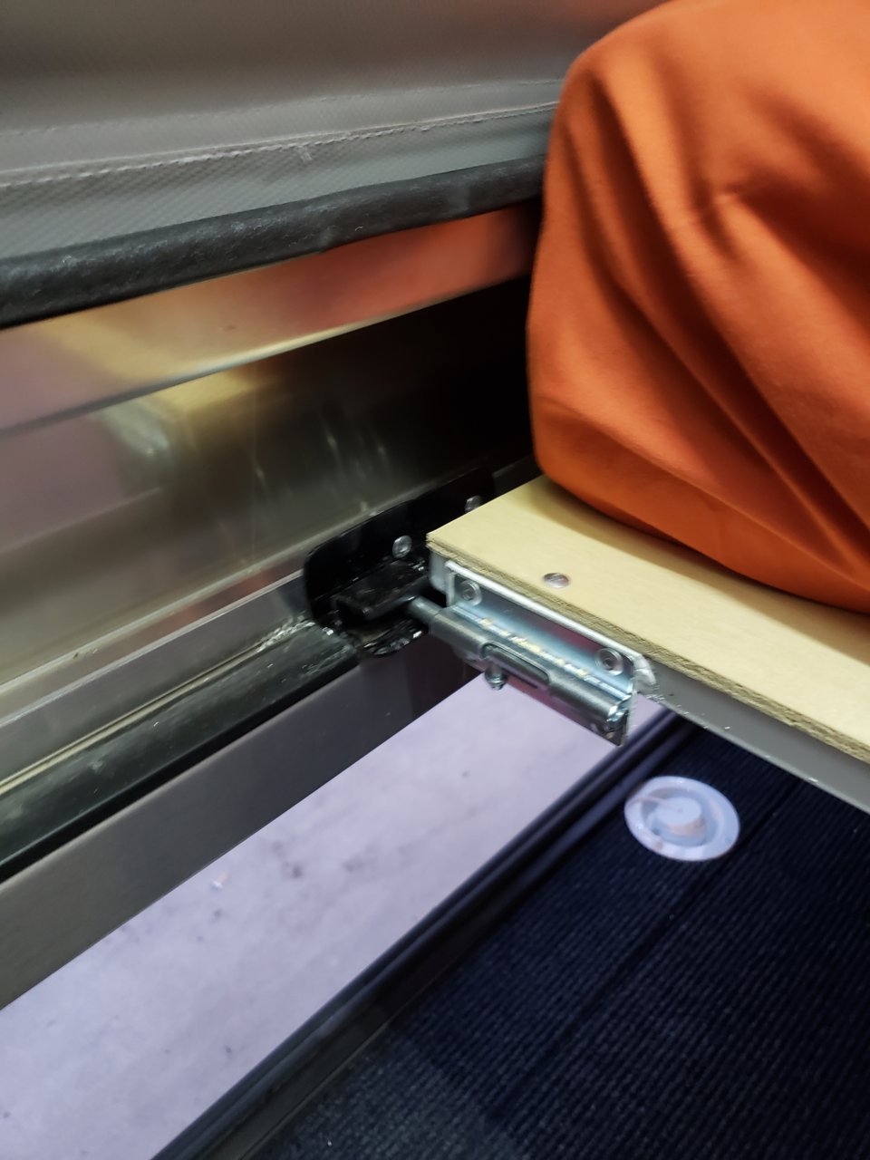

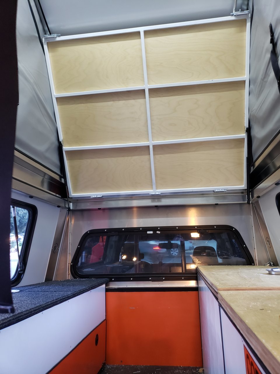

    Well success! I've built what I believe is the first Vagabond bed lift. (Sounds catchy)
    So this is a complete new frame made of light weight steel tubing. Its skinned with 1/8 Baltic birch plywood (prefinished) then I added 2 gas struts. Since it is a bit more narrow then the rails, I made 2 mounts that the frame sets in to hold the panel in place and hold up 2 people.
    BioG, Toynado, Eazy.E and 14 others like this.

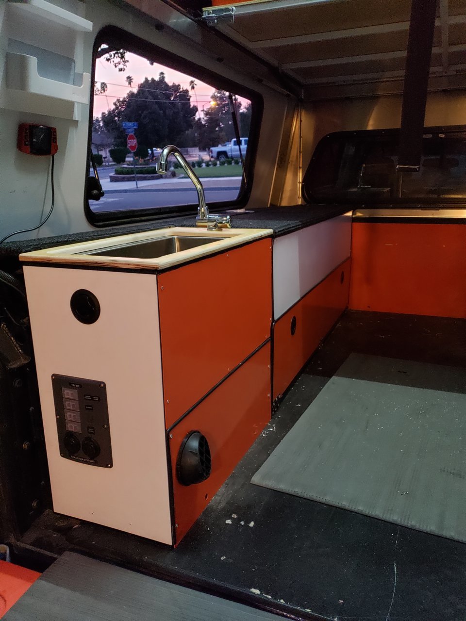

    Here's a look at the completed drivers side cabinet.
    Toynado, Eazy.E, Slashaar and 13 others like this.

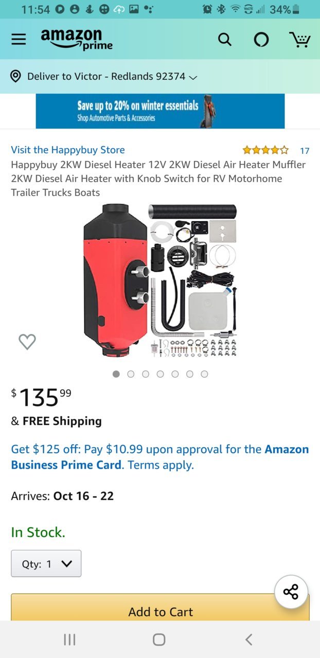

    What kind of heater did you buy? Also what did you use on the bed floor?
    Setup is sick!
  15. Oct 11, 2020 at 4:49 AM
    #4315
    excav8tor
    excav8tor Well-Known Member
    Mar 1, 2016
    #179882
    154
    vic
    2016 Toyota Tacoma TRD sport 4x4 White
    The heater is a 2.5 kw diesel/ electric off Amazon (china) nothing fancy, I think it was around 150.00
    I figured if it doesn't last long, I could buy 8 of them over time as replacements and still not spend what it costs for the original Espar heater these imitate.
    The floor, the first layer over the bed and bed sides I used Reflectix insulation, in hopes it will help some for heat and cold. The second layer is Baltic birch plywood coated with bedliner spray paint.
    The Baltic birch came in a 5' x 5' sheet.

    Very nice work! Do you mind sharing the link to which diesel heater you bought?
    Love the cabinet build. Gives me a little motivation to do mine!
    I couldn't figure out how to get the link, but here's what I got.
    And thank you for the compliments, I'm pretty proud of it
