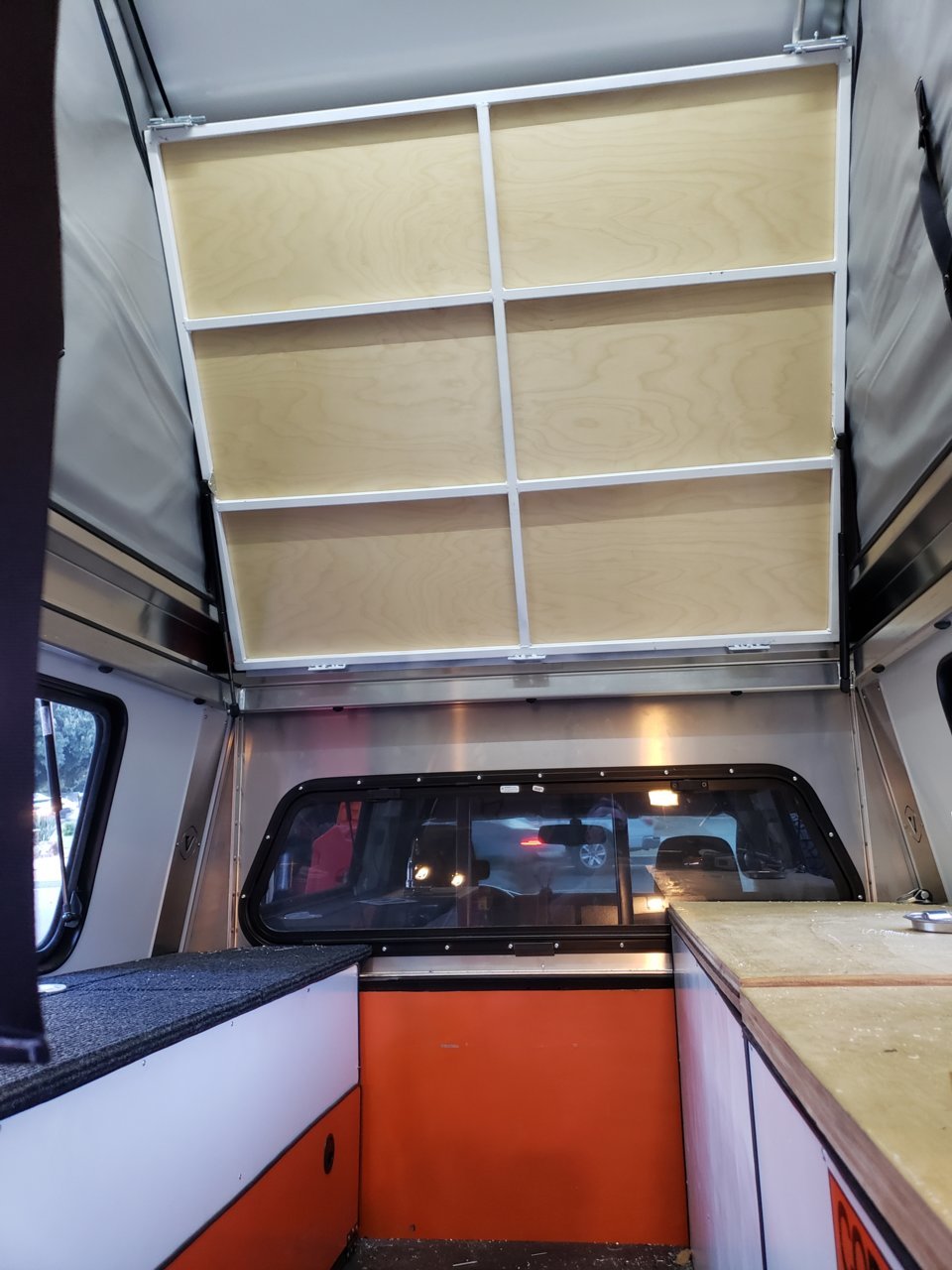

    So I finished my tilt bed project and it works freaking amazing! (If I do say so myself).
    I did order up a more powerful set of gas shocks (60 lbs.) As the 40's just don't have quite enough strength to hold the weight. Al in all, it works as I hoped.
    Kbails, tacoburn327, BioG and 11 others like this.

    This is pretty awesome! Sliding the bed platform in/out is really my only mild-dislike with the Drifter design and I'd definitely prefer a tilt option like this.
    Only question, does the tent material hang down when you close the camper? It's nice to be able to slide the bed platform towards the back to catch that material.

    The tent material would hang down but I made a 10" bed platform extension. I slide the extension back away from the tilt down bed about a foot then pull the entire mattress back away from the front and over the extension, so nothing hangs down

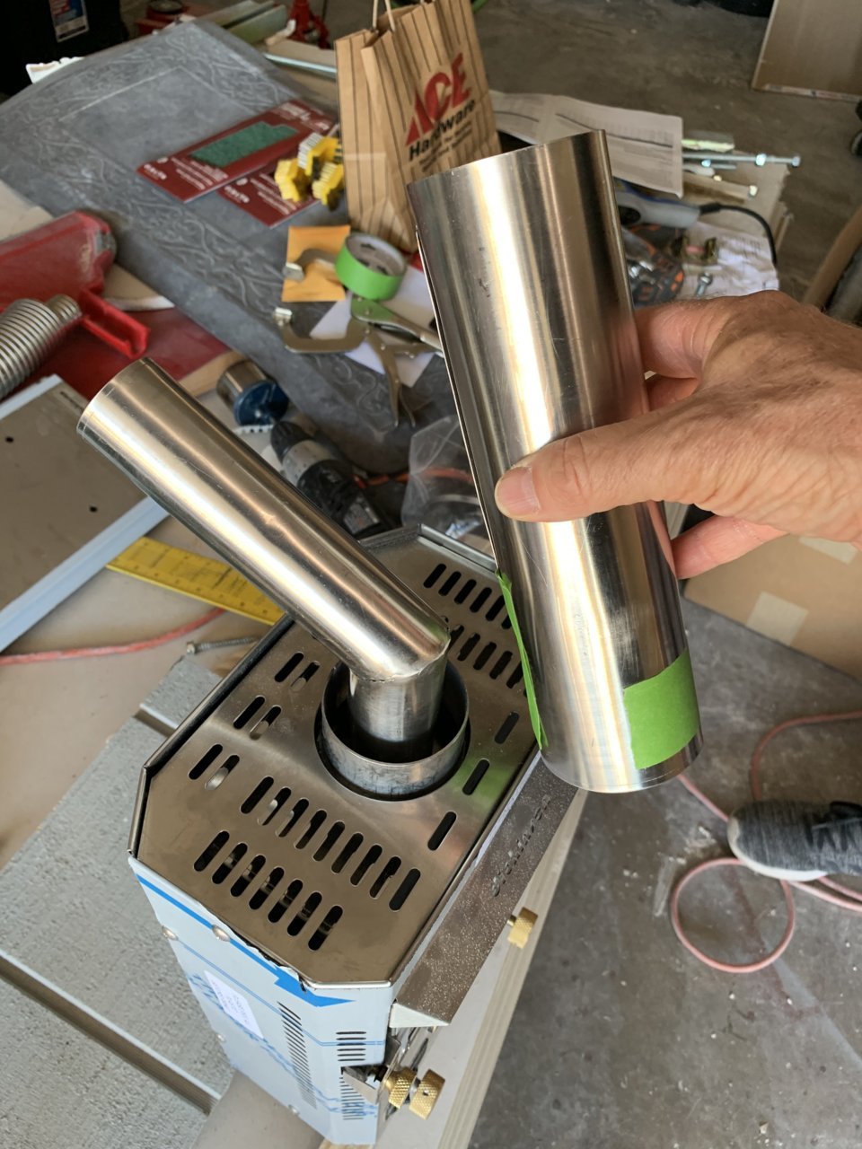

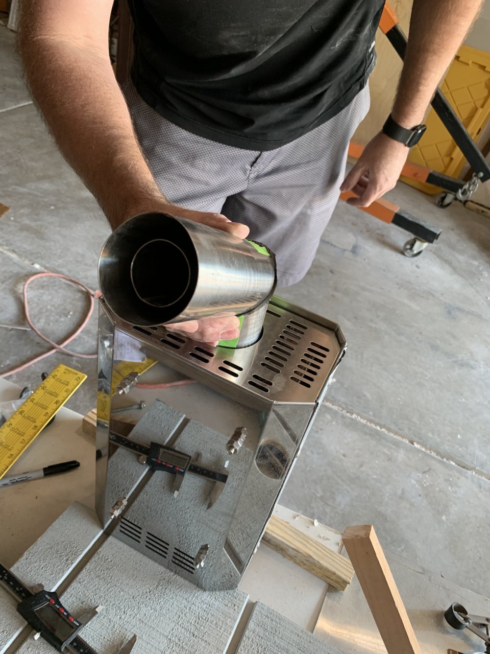

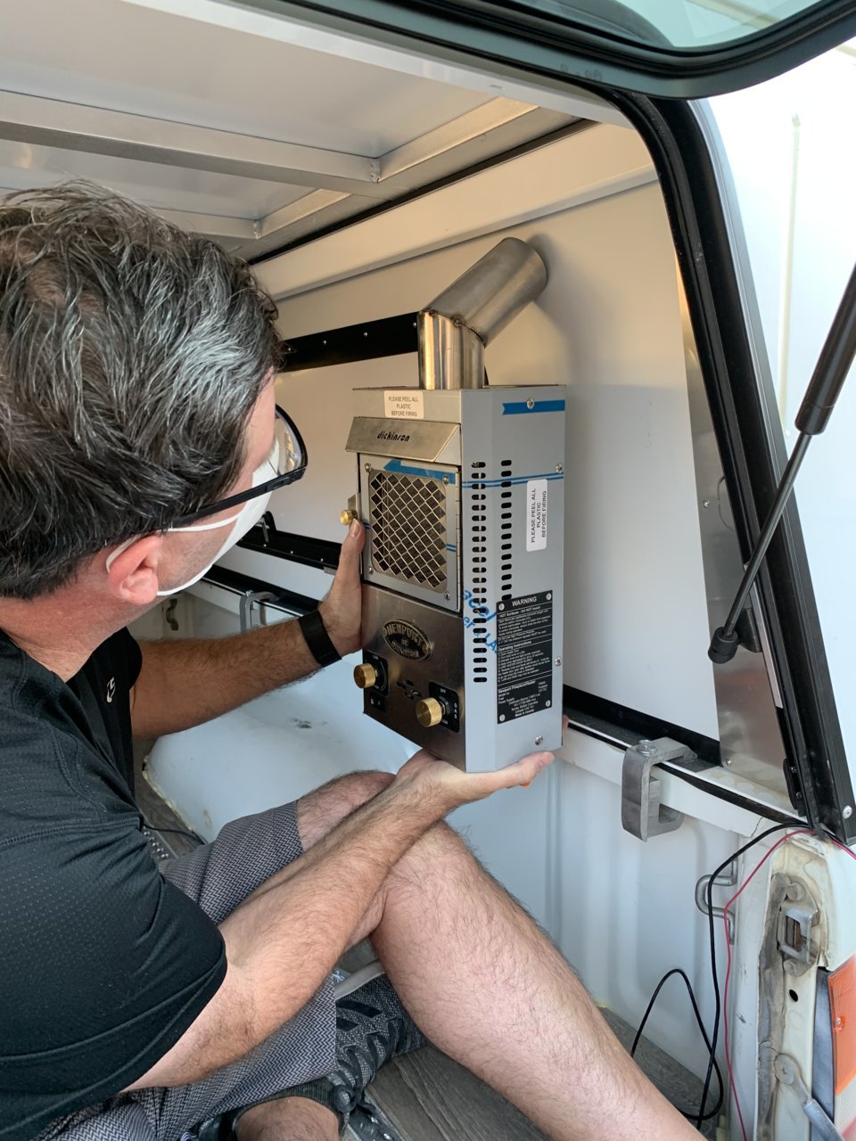

    A little more progress on the fireplace. My buddy Mark is making a custom stainless intake / exhaust to work with the Drifter. This is sealed combustion, so there is a 1" exhaust tube centered inside a 2.5" intake tube; they both need to pass through the Drifter wall. The concept for this setup is to allow the fireplace to be removed for service if needed, and utilize the factory flexible Dickinson flue pipe on the outside of the truck when the heater is in use. When not in use, the exterior pipe will stow away and be replaced with a flat cover plate for travel. This will be accomplished using a stainless "sandwich" that gets mounted to the Drifter wall (not shown here... hasn't been made yet).

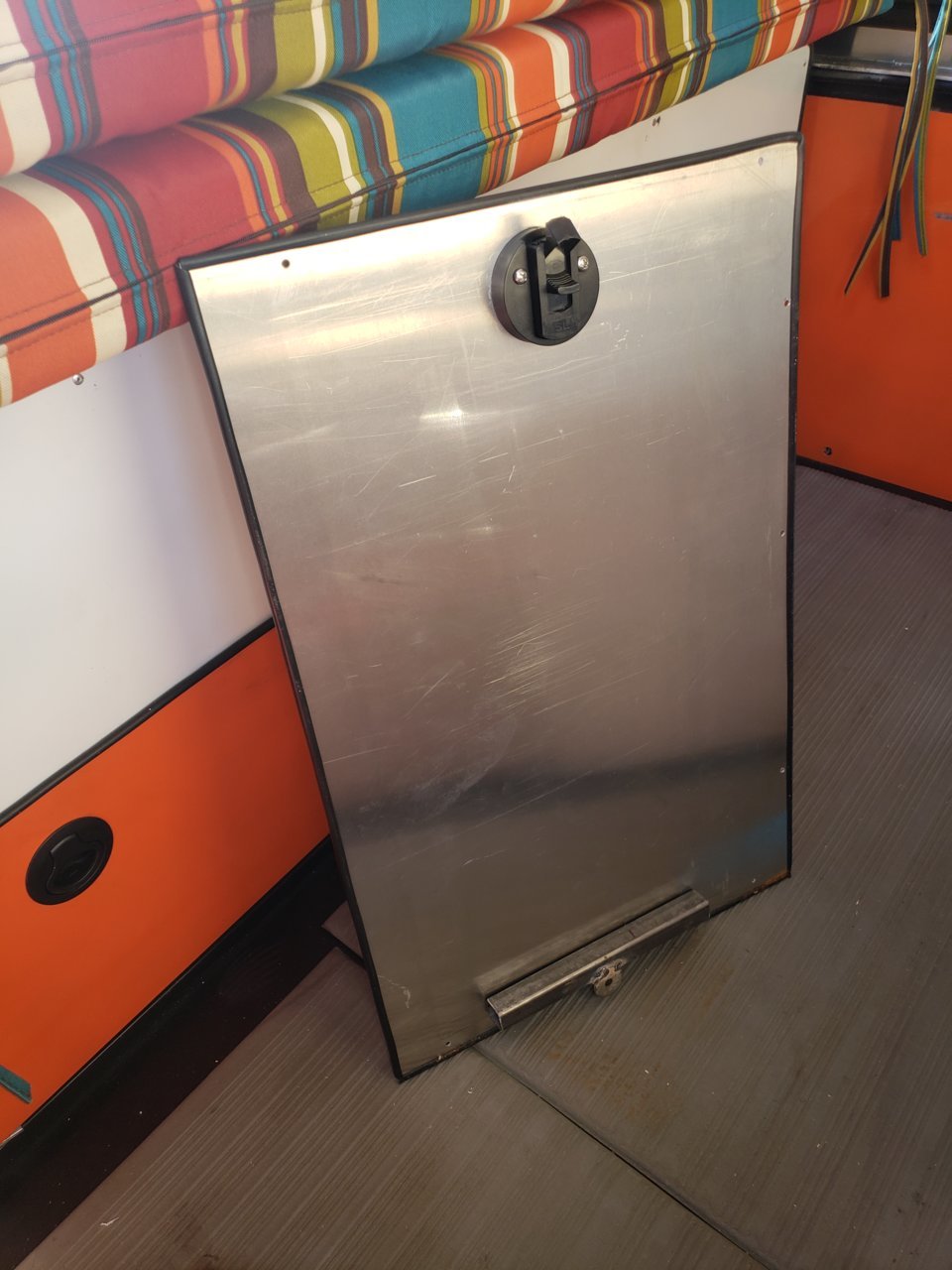

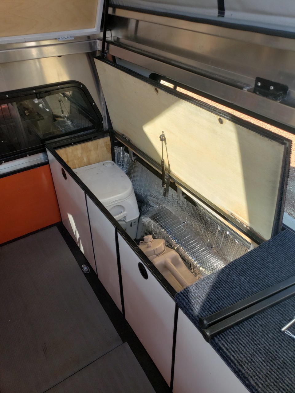

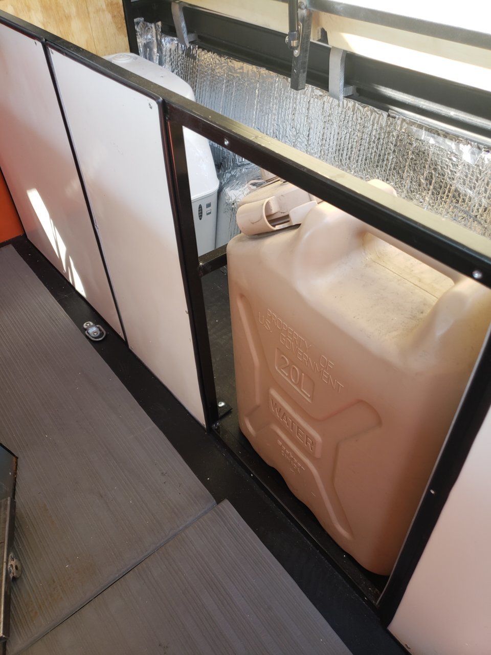

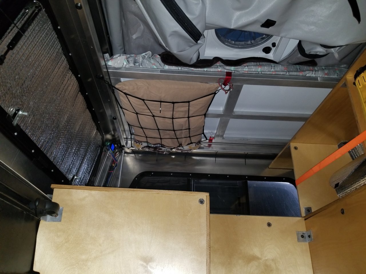

    20201017_121740.jpg 20201017_121430.jpg 20201017_121813.jpg 20201017_121810.jpg
    Here's a closer look at the passenger side cabinet I designed to fit what I need. Right now I have a toilet and scepter water jug, with room for bedding and pillows and miscellaneous stuff.
    The top flips up with a gas shock, and folds open for a dog bed or some small rug rats.
    The doors are made light weight out of a single sheet of aluminum, a marine latch and a catch i made on the bottom to capture the bottom 3/4 tube. Very simple but effective.

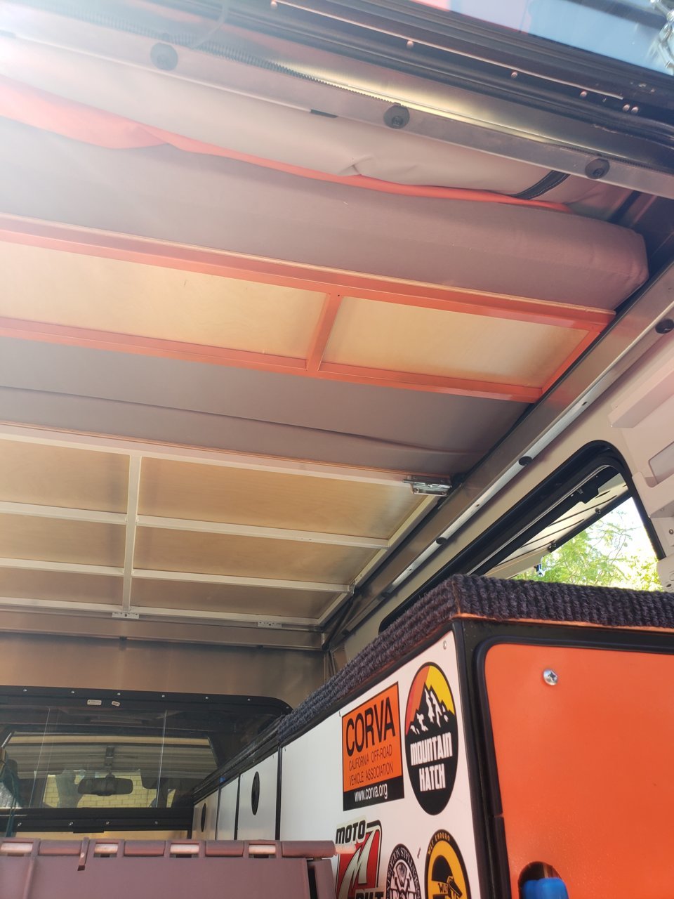

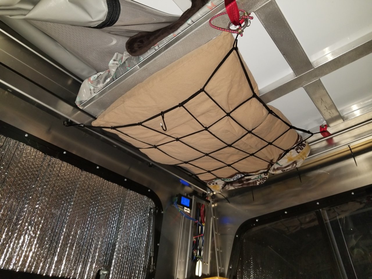

    Here's a look at the extention I made for a little more foot room while up top sleeping.
    By pulling the mattress and extention back away from the bed platform none of the tent material hangs down into the back of the truck.

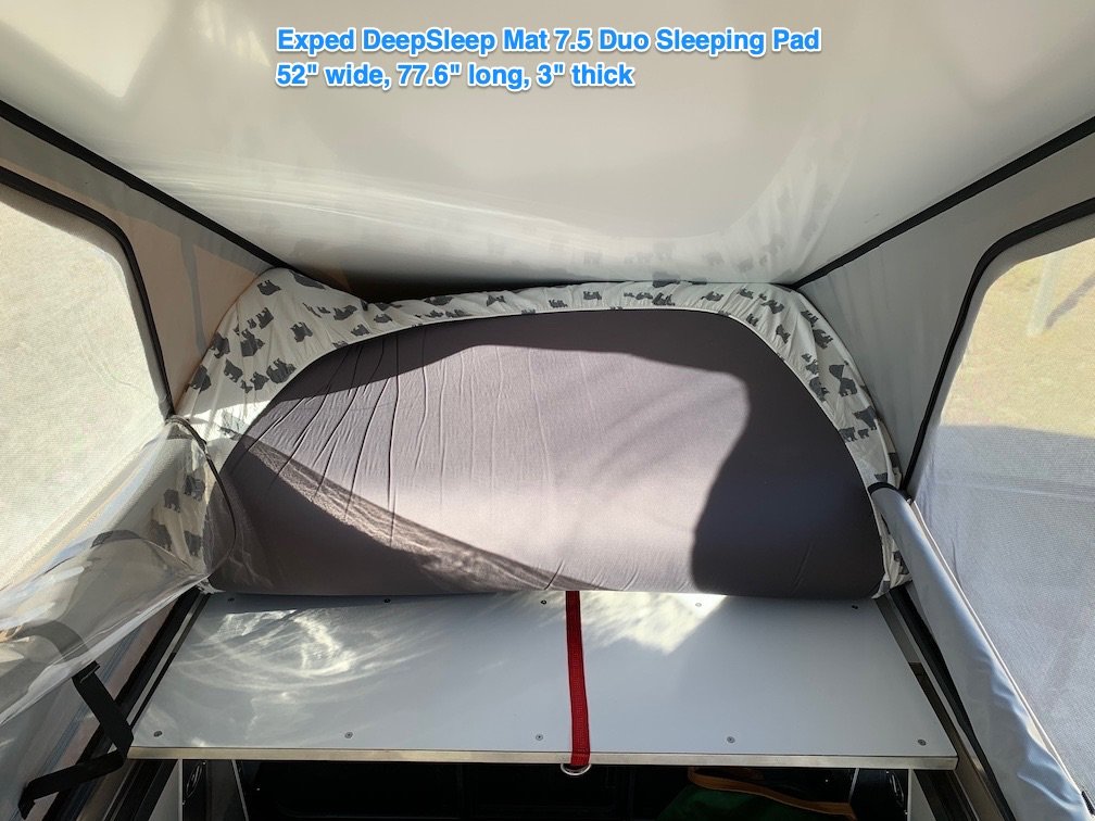

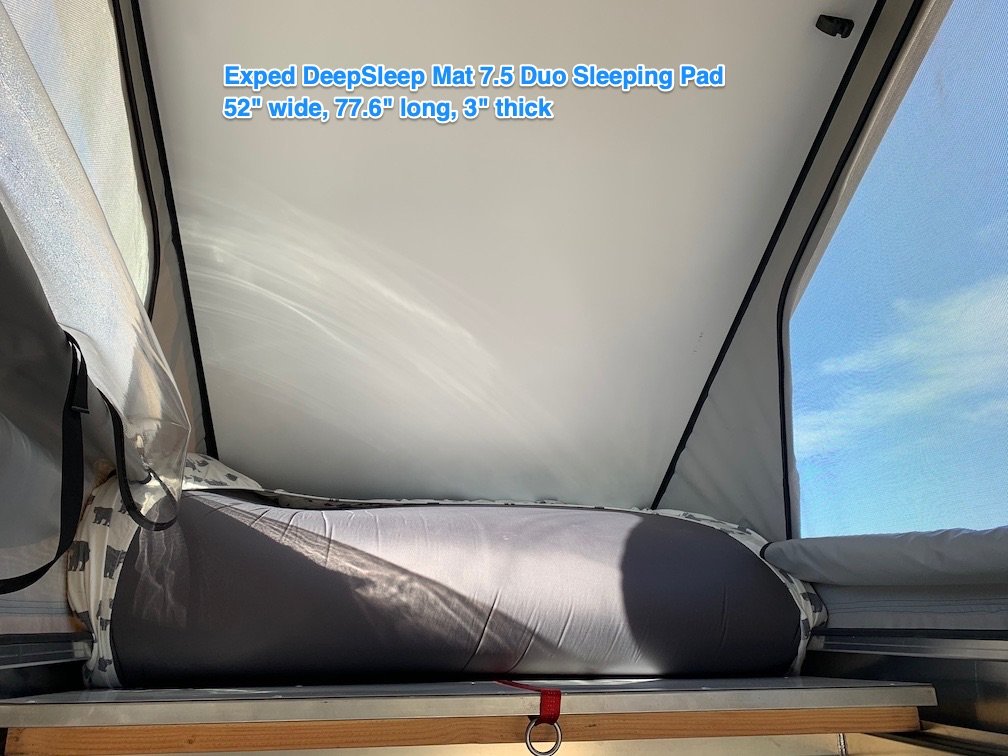

    Since it seems that I'm trying out all the high-end mattress/sleeping pad options (not just foam toppers), I started a spreadsheet with specs.
    Feel free to comment/edit/modify with your learnings/knowledge.
    https://docs.google.com/spreadsheets/d/1DXP3nAz-gvzkqkSqJg30gL-3g0SF64hCMaFf7zMu_GI/edit?usp=sharing
    This past weekend I tried out the Exped DeepSleep Mat Duo 7.5 LW+. Same width/length as the Exped MegaMat I tried earlier in the year but only 3" (compared to 3.9" of the MegaMat). It is WAY more comfortable than the Vagabond mattress, but like the MegaMat, it's wide enough that it tucks into the side channels of the Drifter, which makes it a bit annoying to fold/tuck up and slide the removable platform section on top of the overhang to utilize the entire standing area.
