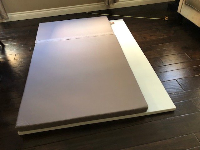

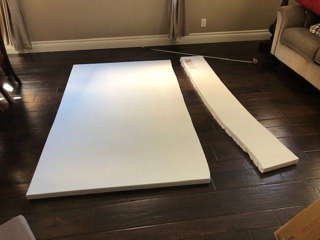

    So I bought a Queen 2" Serene Foam Topper (better than memory foam). https://www.costco.com/comfort-tech-serene-foam-2"-mattress-topper.product.100482550.html
    Cut it to match the Drifter mattress. Put my comforter and two pillows up there as I usualy do and tried to close the Drifter. Couldnt close it. I closed it with heavy force but I do not want to stress the hinges. $130 bucks down the drain, cant return it since its cut. :(
    Anyone want to buy this foam topper for $60? Let me know. My loss your gain.
    Need to go back to the drawling board what to make the OEM mattress more comfy or buy a all new mattress all together.

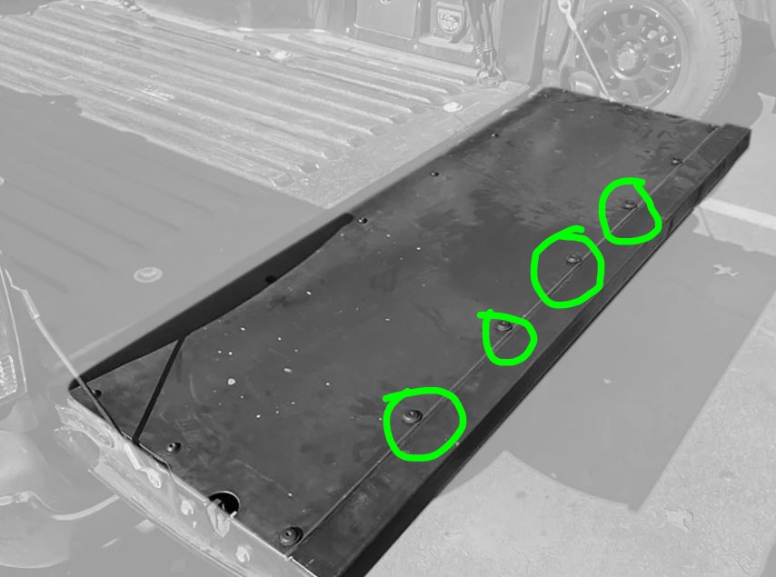

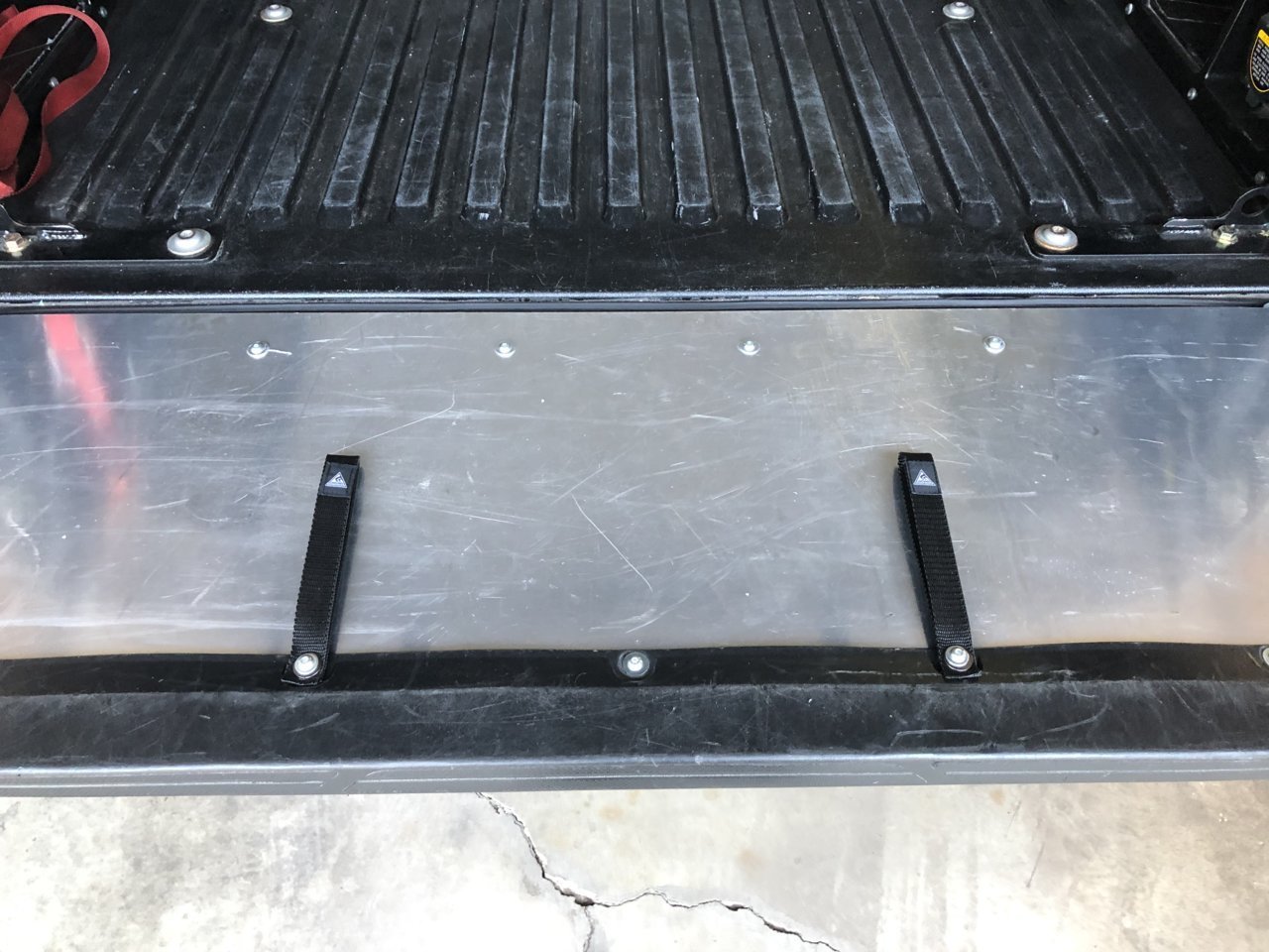

    I'm looking to see how y'all attach a rope or pull tab or handle to the inside of the tailgate (I'm tired of closing it and crawling in like a stink bug)

    take any of these screws out and put a 1" nylon strap inside with an eyelet.

    Very easy! I got these off Amazon (Seattle Sports I think they were from) and mounted them to two places on the tailgate through the metal grommets on each handle. One thing to keep in mind is that the stock hardware (that holds the factory tailgate cover) is pretty cheap & screws into plastic inserts. When I made the flat aluminum tailgate cover below, I also replaced all this hardware w/ Rivnuts & sturdier 1/4-20 bolts (@Mobtown Offroad sells a nice kit for this). I am not saying the stock screws won't hold over time, but just keep that mind since you will be yanking the whole weight of the tailgate with the pull strap a lot.
